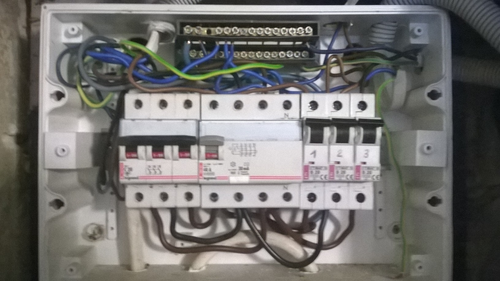

    Gentlemen, I have a small problem with the voltage on the socket pin. I can describe the installations, there is power in the house, 3 fuses on the phases for individual rooms on the board, the Legrand 40A 30mA differential in front of them. I did the installation around the house myself, 3-wire x2.5 cables for sockets, for 3x1.5 switches for 2x1 line halogen lights. If I want to connect the PE wire, it turns off the differential, I decided to check today what is wrong. On the board, I did not connect the PE wire on any phase during the tests, and yet the pin is lit. The tester is lit on the grounding pins, despite disconnected devices and disconnected contacts. The meter shows a result of 4V to 5V, I called all the sockets at the angle that maybe I shorted PE with N somewhere because I have 2 sockets without grounding, everything is well connected, N from N, PE from PE and L from L. I have it on 2 phases and the result identical 4V to 5V. Can this behavior happen if I did not put L on the led switch, but N, and the phase went directly to the leds? Maybe some suggestion what else I can check, and maybe check one phase, and disconnect the other 2 for the time of testing?

    Alee. You want to have a good call from an electrician, and not to rummage in the installation yourself.
    High-impedance meters are unreliable for this diagnosis

    1. A simple tester or a high-impedance voltmeter are not reliable tools for such diagnostics.
    2. How is the PE installation in the distribution box made? Do you split PEN into PE and N in it? And where exactly do you want to connect this PE that triggers the differential?

    Thanks for the info, but I don't have 2 left hands to repair. But it's overwhelmed me and I don't know what's going on, because the devices are disconnected and the pin is on.
    Of course, I have PE and N strips in the box, and they are well plugged in. I want to connect the grounding of the installation to the PE strip for now from one phase, in terms of the installation of the kitchen, bathroom and corridor. If I hook up, the difference is thrown out.
    Which bolt is on? And what color? :D Do you, laymen, rummaging like chickens, willfully in the installation, have to provoke us, hmm, professionals to ironic answers? After your description you can see total secularism and lack of knowledge in the subject. As they always say on the Forum - Kumaty Electrician Necessary!
    Check protective conductor continuity and fault loop impedance

    And does a colleague have at least a meter that will surely find voltage on these protective pins?
    Just because the neon voltage indicator is lit does not mean that there is min. Voltage.
    Besides, the installation has a lot of errors (for example sockets without protective pins), what should be surprising?

    Take photos of the trimmed switchgear with the connections well visible. However, the repair or replacement of the installation should be done by an electrician!

    I am also not an electrician by profession, but an electronics engineer. Why is this happening? I will consider from an electronics point of view ... you have 3 wires, NL PE, quite close together. You know how a capacitor works, probably for AC voltage it is impedance. If PE hangs in the air, a capacitive log is formed between N PE L, and PE if it hangs in the air, it is no wonder that you have some potential on it. Reduce the input impedance of the meter (for example with a resistor) to about 5kR and the problem will go away.
    As for the release of the security:
    First, I would check the correct connection of the RDC.
    EDIT
    I shot the stupidity instinctively with this impedance reduction .. This is what you do with low voltages.
    In this case, you need to use appropriate measuring equipment.

    Gentlemen, I must show remorse because I made a culpable mistake. I connected the brown wires to the N strip, although I do not know how it happened, the brown wires, i.e. L, and at the output of the N fuses, I only noticed it today, although I looked at the boards several times. After replacing the wires, I connected the circuits one at a time, and the full ground is already working on 2, the ground is no longer lit. However, it also turns off the differential on the last circuit, the sockets and switches are checked in the rooms and are well connected, but I have a bad connection somewhere in the woodshed because it turns off the differential. The installation was not changed there, but I will fix it on Monday. On the other hand, I connected all the switches correctly, and the L wire goes through them, the fact that there was no voltage on them is the effect of changing the wires in the board. At the bottom is a photo of my board after replacing the wires.

    The installation in the woodshed is unchanged, but I hope it is a 3-wire one, because, in the case of a 2-wire one, it cannot be connected via an RCD.
    PS. This "separation" leaves a lot to be desired in technical terms.
    Unfortunately, you cannot see the connected N terminal on the bottom of the RCD, so there are also caveats here.

    People die because of such mistakes ... Massacre ... The covering of this switchboard is also terrible ...
    Exactly. So why is this RCD there? To make it look nice, of course after putting on the "lid" :D

    Made to measure - a specialist
    And something very thin is wine - cables as for the 20A fuses

    B20 for 1.5 mm?. Massacre!
    Get an electrician before you burn yourself down or burn someone down in this house!

    Switchgear for immediate disconnection, among other things because all the neutral conductors N connected in front of the RCD and giving other advice in this case will only be harmful.

What breaker rating should protect 1.5 mm² lighting cables?
Standards limit 1.5 mm² Cu to 10 A (B10). Using B20 exceeds thermal capacity and risks insulation damage during overload [PN-HD 60364-5-52].
What happens if I leave B20 on 1.5 mm² conductors?
A 20 A fault can heat 1.5 mm² PVC to > 150 °C in minutes, leading to brittle insulation and fire. Fire brigades attribute 22 % of domestic fires to such overloads [Polish NFA, 2020].
