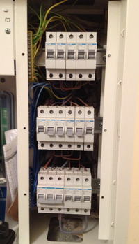

    I have had a problem with the differential in my house for several days, so I am asking you for advice.
    I would like to point out that I am a layman in this matter, therefore I am asking for your understanding.
    I will try to summarize.
    Two weeks ago, one of the motors (230V) from the entrance gate, due to moisture, got a breakdown on the winding between N and PE, therefore the main differential worked, cutting off the power supply to the whole house.
    I will just add that the gate from the very beginning, i.e. since it is installed, has " little "protection in the form of two miniature circuit breakers.
    First of them ( Hager MB 116A ) is located in the main switch cabinet, and it protects a certain segment of the receivers in the basement. From this power supply there is a separate line for powering the entrance gate, a separate box is installed here, in which two overcurrent switches are installed ( GE B6 G61 - one secures the entrance gate, the other a video intercom )
    And here, in front of the circuit breakers, I decided to add an additional differential.
    The assumption was that at the time of the re-piercing, it would first knock out the difference in the basement, and the difference on the main board would remain "intact". I installed everything yesterday, the basement differential seems to be working fine because the button is pressed " test "causes it to disconnect, but another thing worries me. The so-called artificial creation of a puncture behind the differential between the N and PE conductors causes the breakout of both differentials, the one in the basement and the one on the main board, thus turning off the electricity in the whole house.
    Below I present a "layman" diagram of how I have it connected.
    I am asking for verification and some tips.

    In order not to "knock out" the main differential, in the event of a gate / intercom failure, the differential servicing the gate and intercom should be powered from the front (from above) of the main differential.

    I already thought about it, but then the rest of the receivers that are on this line in the basement will be deprived of residual current protection. Another way out is
    assuming this single-phase differential on the main board right after the overcurrent 16A, switching the main phase to the basement in front of the main differential?

    ... Do you have a 3 phase installation? What is the network layout? I do not understand why these differentials are plugged in in series.
    There is no selectivity between them and they can switch off as they please ...
    Yes, the installation is 3-phase L and of course N zero and PE earth.
    Can you give a hint on how else to connect it?
    In principle, I made the connection according to the pattern in this photo, with the difference that there is an isolating switch in front of the single-phase differential - I assumed that the connection principle would be the same.

    lordpakernik wrote:
    I want to protect myself for the future by adding a second HAGER CD 226J differential. The assumption is that if a similar situation occurs again, the HAGER CD 226J bipolar difference in the basement will knock out, while the HAGER 441J main difference is not to react.
    There should be two independent RCDs. With separate N rails, of course common PE. You in this picture have 2 RCDs in series and there is no selectivity between them. Sometimes it can work, the first time, the second time, and sometimes twice, whatever they want. Besides, why this overcurrent switch in front of the RCD. Really if you have it connected like in the 1st picture you put in then you have a great one there groats.
    There should be something like this, ie 2 RCDs parallel to each other and are then independent.
    Differential Disconnects Power in House: Motors (230V), Hager MB 116A, GE B6 G61, Moisture Effects
    It should be because, in order to draw a diagram accurately, you need to see what is there. It is only about connecting differentials. I assume you have a TN family system.
    Thank you for your help, but I must admit that I have a bit of a problem with the correct interpretation of the drawing :) , but I guess that the phase for the bipolar difference should be taken from the main difference, i.e. omit it?
    This is what the box looks like - there is a cable mess, but the time for arranging it will come when everything is ok. However, the box is probably all right when it comes to connections? :)
    By the way, I greet the electricians whose hair has bristled on their head ;)

    I will shyly ask so; and why is PE connected to the BLACK wire?

    Sorry, my mistake - I wrote while working from memory. PE is combined with blue. And why such a cable with veins, brown-black-blue - adapted from the power already inactive
    So far back to the topic.
    Thanks for the answers and suggestions. I did according to my friend's proposal, "lordpakernik" and "stanislaw1954", that is, the entire circuit, including the gate and intercom, was connected to the main residual current device.
    Now everything works as it should.
