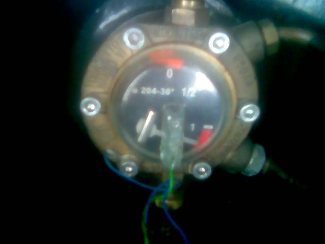

    Today I am going to connect to the computer again, I will test on these two terminals. And what's the best program, I would need it by 14.
    Yesterday I dug into the tank, and noticed that the dipstick cover was moving, which is why the LED is just dumb. What should be the correct position, I added a photo, now it does not flash when the tank is full.
    Flashing Gas Diode/Switch on Landi LES 98A: Is It a Faulty Electronic Peephole?
  • #10 9377900
    1pol
    Posts: 48
    Rate: 32
    2 cables go to this indicator. One is ground and the other signal is led to the gas computer. The glass that you can see works on the principle of a short circuit ... you have a magnet on the tip and under the influence of a magnetic field it shortens to ground ... the farther this sensor is from the magnet, the later the reserve will light up (i.e. the flashing diode). I must admit that it is difficult to set these reserves, they are very sensitive. it is best to connect the meter with one end to the signal cable, the other to ground ... set it to 200 ohms, preferably on an empty tank and by turning, approach the magnet until the value appears on the meter. In short, a short circuit. after refueling, the magnet will move away (the indicator light is constantly on). Along with the depletion of gas in the tank, the magnet will get closer until the indicator light starts flashing (reserve). I do not know if I explained quite accurately ... how to write something ... As for the program, I'm not at work today, I can't check what program I'm using for these installations, I just don't remember
