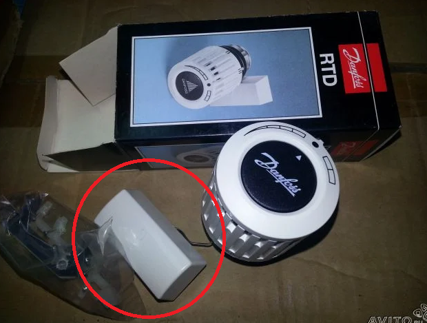

What is the Danfoss thermostat model in the photo, what do its setting marks mean, and what is the purple ring around the logo for?
The purple ring is only a visual marker for your preferred setting; turning it does not change how the thermostat works [#7131888] The head in the photo is identified as an RTD3100 thermostatic head, with a range up to about 26°C and roughly 3°C steps: 5/red symbol ≈ 26°C, 4 ≈ 23°C, 3 ≈ 20°C, 2 ≈ 17°C, 1 ≈ 14°C, and 0/blue symbol ≈ 6°C [#8634323] More generally, this is a thermostatic radiator valve: it regulates radiator flow to hold the room temperature you set, closes when the room reaches the setpoint, and has freeze protection that opens automatically around +7°C [#7127325]

    The product I am interested in is probably no longer produced and Danfoss does not have an "Archives" list on its website
    I am looking for the name/symbol of the thermostat and instructions for the model in the photo below,
    or (more broadly) information about what the knob visible around the Danfoss logo is for?

    Danfoss. The knob has a smooth heating control and there are dash marks ranging from one line to four lines. Setting the knob on four lines results in the highest operating temperature of the radiator and the highest flow of hot water through the radiator. It is a thermostatic valve, so when you set the knob according to the thermometer room temperature to 20 degrees in the room, the regulator will maintain the set temperature in the room all the time. When the valve is closed in the full position by turning the knob to the right, it closes the heat flow to the radiator. When the temperature in the room drops to +7 degrees C, the valve opens automatically, heating radiator, protecting it against freezing.
    Added after 12 [minutes]:
    When installing this type of valves, you should follow a certain regime in the winter. Before airing the room, close the valve on the radiator. After airing, close the window and set the knob to the dash marks as previously set. Do not leave the window open in the room during the winter, because as the temperature in the room drops, the valve will automatically turn on, protecting the heater against freezing. It heats up to pain. Failure to follow this rule causes a headache when you receive the bill for the consumed heat.

    what you wrote and what I found regarding action thermostatic valve explains why yesterday some radiators were warm, lukewarm or almost cold, but the apartment was still warm.
    I'm not sure if I defined clearly what exactly I was asking about earlier, the knob actually has 4 levels of regulation and the fifth one is full, I mean the knob (in purple) on the front
    Identifying and Understanding Older Danfoss Thermostat Model and Functions
    It only rotates to the left and I don't really know what it is for.

    This purple ring is only used to optically mark the favorite (most frequently used) setting. Turning this dial does not change anything in the operation of the head.

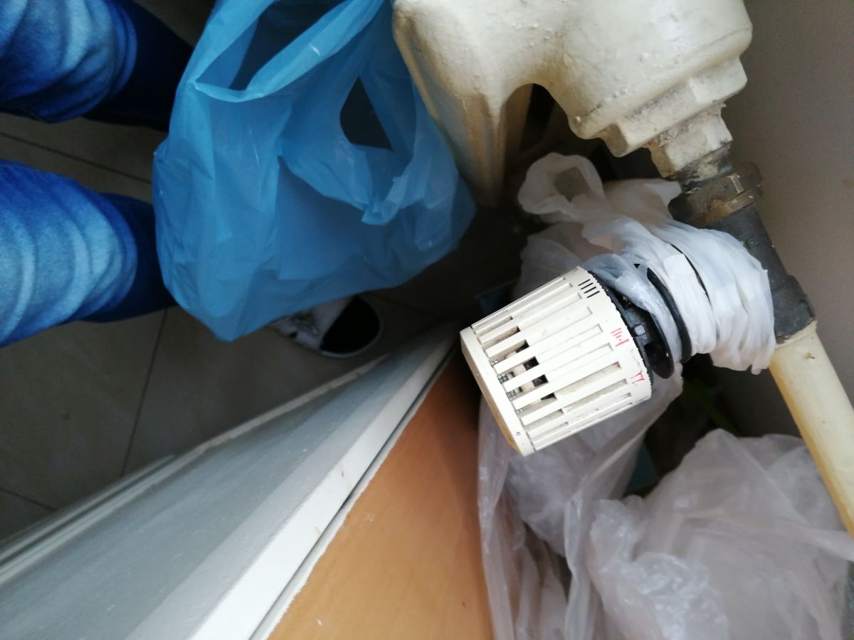

    I will join in on this topic. I have similar thermostats installed throughout my apartment. My problem is that the knobs are incorrectly set (as if they were turned), e.g. when I turn them, they are not on the blue pictogram, but on the red one, etc. Due to this problem, I have to set everything by sensor. Can anyone tell me how to remove the plastic knob so I can set it correctly?

    Can anyone help? I'm trying different things, but I can't remove the plastic casing...

    To remove the thermostatic head (the white knob), unscrew the nut securing the head to the valve with a wrench (probably size 32) (if it is sealed, then you would have to remove the seal with the date, but very carefully, so that you can then put it back on photos of the head could be seen, but they are usually not sealed). To reinstall the head, it should be set to max. heating (to the red pictogram) and with this setting, place it on the valve so that everything fits together and then screw on the large nut. Setting to max. for mounting the head is important because then the mushroom head inside the head is screwed in deeper and makes it easier to properly place the head on the valve. After installation (and tightening the nut), turn the knob to the position ensuring the expected temperature in the room.

    Thanks for the help. I understand that someone simply installed the head incorrectly? I hope water won't spray out if I take this head off?
    You reason well. Water won't spray out - don't worry. :D

    I also have such a valve, but the question concerns the steel cable, probably 0.5 mm, which is connected to the valve and then to a small white box on the wall (only in the kitchen, there is no such cable in the rooms). Does anyone know what it is for? And can it be dismantled? probably the RTD3100 head

    This means that you have a different valve in the kitchen, one with a capillary.
    This is not a steel wire, but a capillary tube, and this box contains a reservoir of the working liquid - the pressure and volume change with temperature and act on the bellows in the valve knob next to the radiator.
    NO, it cannot be disassembled - if you break the capillary or cut it, you can throw the head away
    If you want to get rid of it, you need to buy a head without a capillary - the one you have in other rooms or its replacement.
