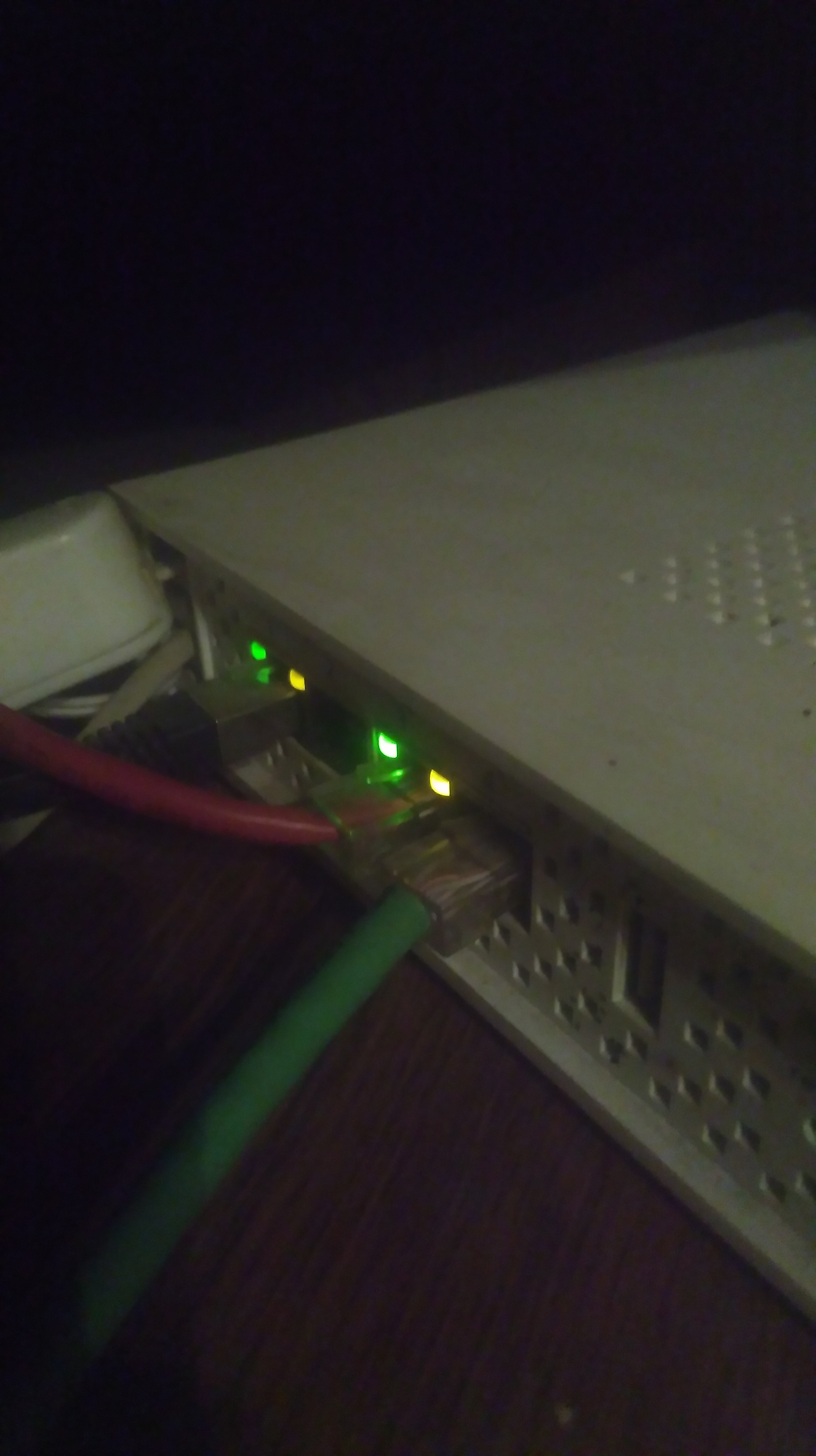

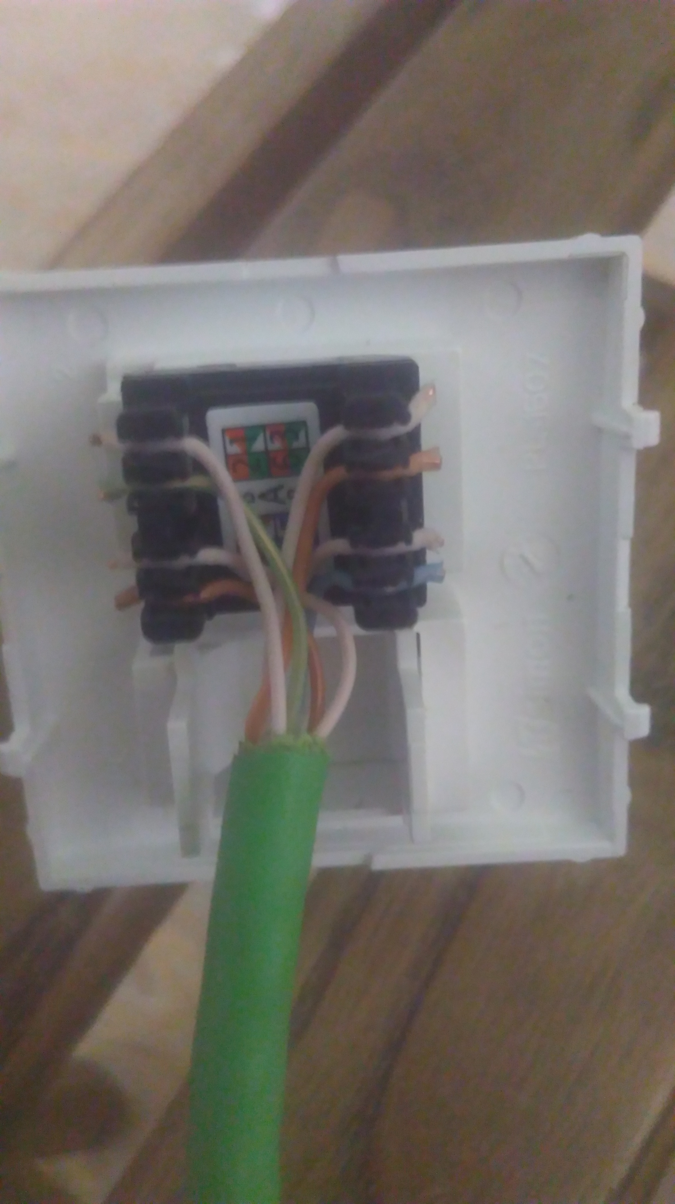

    Hello ,
    As in the subject, I wanted to fix the internet socket. Previously, I had a cable drawn from the router to the computer (cable signature 568A) into the room and it worked. During the renovation, I wanted to install a socket in the room, I cut the same cable on one side to the router and on the other end I cut the end off and plugged the cables into the socket according to the instructions for type A. To check it, I plugged the cable from the socket to the computer (signature 568B) and at this moment shock, it doesn't work. I tried to change the socket to type B and nothing. I'm asking for help because I'm in a total valley. I am attaching some photos.
    • RJ45 Internet Socket Assembly Issue: Troubleshooting Connection with 568A & 568B Cables 1504032495982-1042541259.jpg (1.66 MB) You must be logged in to download this attachment.
    • RJ45 Internet Socket Assembly Issue: Troubleshooting Connection with 568A & 568B Cables 15040323333381502312728.jpg (2 MB) You must be logged in to download this attachment.

    Are the wires pressed into the socket with a suitable device or with your fingers?

    On both sides it must be the same, either A or B let the colleague check if the cables are well inserted into the socket. Sometimes something doesn't connect and there is a problem

    I pressed the cables with my fingers and I wonder if sometimes it is not too weak because the lagging around them is quite hard. : / and I also wonder if the cable at the outlet from the socket also has to be A-type as well as the one that goes into the room?

    99% of the contacts did not cut the cover. This can be pressed in quite correctly with two thin screwdrivers

    You do not have a plastic that presses the veins with insulation into these plates and cuts them ?? Alternatively, in the computer store, let them earn you a socket on a loose cable, e.g. 20 cm, and here you can connect color to color in a can and it should work

    You need a tool like in the video - this is a krone knife.
    theseba321 wrote:
    I also wonder if the cable at the outlet from the socket must also be type A, as well as which is led into the room?
    If you have the A standard cable from the router, you do A everywhere on this line (and analogously with B).
    However, it has been assumed that the B standard applies everywhere!
