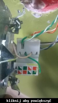

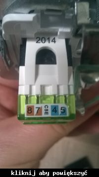

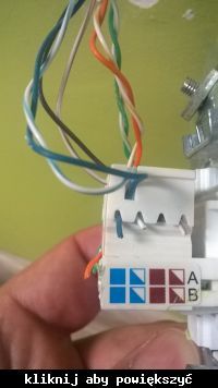

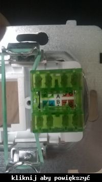

    I post photos - I have two types of sockets that earn money differently, I also put a second end OSPEL LAN Socket: RJ45 Plug Connection to Router - Network Wiring in Rooms (A or B Standard) OSPEL LAN Socket: RJ45 Plug Connection to Router - Network Wiring in Rooms (A or B Standard) OSPEL LAN Socket: RJ45 Plug Connection to Router - Network Wiring in Rooms (A or B Standard) OSPEL LAN Socket: RJ45 Plug Connection to Router - Network Wiring in Rooms (A or B Standard) OSPEL LAN Socket: RJ45 Plug Connection to Router - Network Wiring in Rooms (A or B Standard) OSPEL LAN Socket: RJ45 Plug Connection to Router - Network Wiring in Rooms (A or B Standard) OSPEL LAN Socket: RJ45 Plug Connection to Router - Network Wiring in Rooms (A or B Standard) cable with ear plug - please help me how to stick it to work.

    RJ-45 is rather ok, but this pasta on the sockets is poor, the colors are hard to see, are these veins at all stick? It can be tightened with the LSA knife.
    The tips should be trimmed and not stick out so you have to correct it. Normal LED tester for PLN 15 to check for continuity.

    Before I bought a Krone knife, I first bound the ends of the wires because they were not always pierced when crimping on the socket. Maybe you have a problem here. Have you tested the tester connection?
    No, I have not tested, I do not have such devices. Improving the connection, I will earn a B socket and see what happens :)
