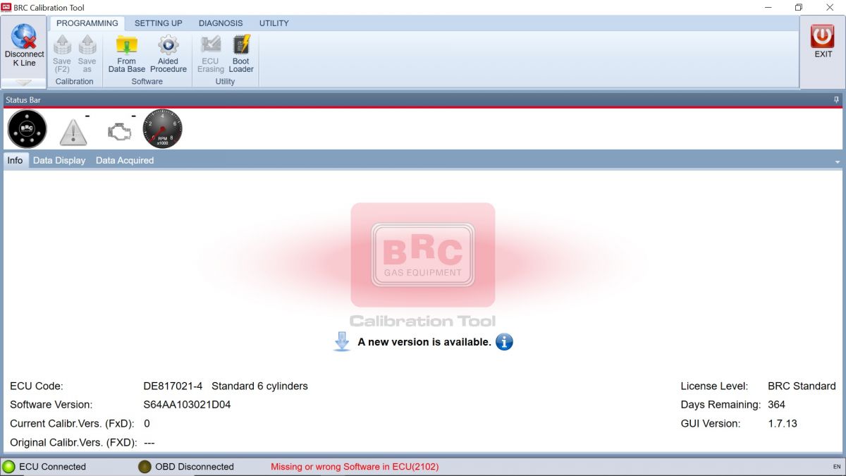

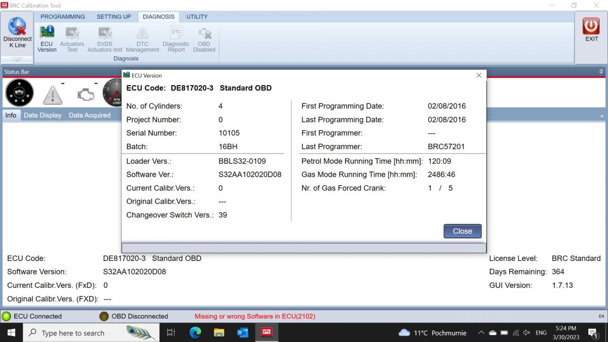

    I have the BRC calibration Tool active, but the software does not want to work with it. I get a message that "Missing or wrong software in ECU" I have in two cars. The third car connects normally.. The question is where to get the corrected ECU soft? BRC SEQUENT 32 Calibration Tool - Seeking Program for Controller Settings Adjustment BRC SEQUENT 32 Calibration Tool - Seeking Program for Controller Settings Adjustment

    Yes, only with different "ECU code" DE817020-3, DE817021-4 (these show the problem) BRC calibration tool in the "Utility" and "Software Information" tab is not listed with these ECUs and therefore there is a problem ... The third working one is on the list .

    The problematic ones are BRC SEQUENT 32...the third one is different
