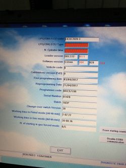

Jak uzyskać dostęp do ustawień sterownika BRC Sequent P&D Plus, skoro po podłączeniu widać tylko okno z wersją ECU?
To nie jest blokada sterownika P&D Plus — używasz złego programu; do tych sterowników trzeba Calibration Tool [#16315418][#17807806] Sam Calibration Tool jest licencjonowany, więc bez ważnej licencji/keya program nie uruchomi się [#16317165] Dostęp do tego programu mają warsztaty/autoryzowane firmy BRC w Polsce [#17871615]

    Gentlemen, I wanted to connect to the BRC switch in my car and probably do not have access, I can only preview one window with the ECU version. Is this really lack of access or am I using the wrong program? Can you work around it, or just the goodwill of the editor? As far as I know, the central office with me is P&D Plus.
    BRC P&D Plus - no access to settings in the Sequent P&D programbrc no.jpg (245.39 kB)You must be logged in to download this attachment.
    BRC P&D Plus - no access to settings in the Sequent P&D programbrc no..jpg (265.14 kB)You must be logged in to download this attachment.
    BRC P&D Plus - no access to settings in the Sequent P&D programbb7e00ca..f.jpg (2.43 MB)You must be logged in to download this attachment.
    Calibration Tool program.
    MAX52 wrote:
    in both cases the control panels blocked by the assembly workshop, probably vehicles bought outside Poland with the gas installation mounted there, unblocking the control panel only for a fee in Czakram-Tarnów.
    P&D is not blocked. Calibration Tool.
    In the second Kia topic, the controller is factory-locked.

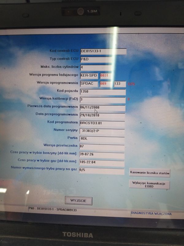

    sztywny13 - and if I give my number, can you check it?
    DE815133
    and 2nd question - can BRC Seq P&D be replaced with unlocked BRC FLY SF? The plugin from what I saw was the same but will it pull gutters?
    Greetings!

    Blocked. Enter the code for this SF fly because it's too generic.

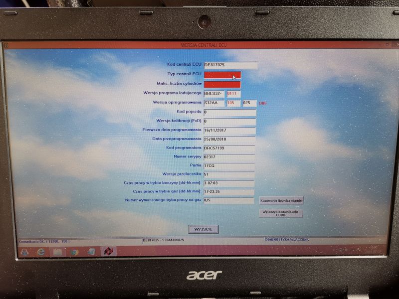

    Hello, I'm the unfortunate owner of the BRC installation, only this time SEQUENT 32, after connecting to the computer I can only read the numbers (as in the photo). Does this mean that my switchboard is locked?
    It is not blocked but you have used the wrong P&D program. The correct program is Calibration Tool.

    Gentlemen and the DE817025 driver blocked or not?
