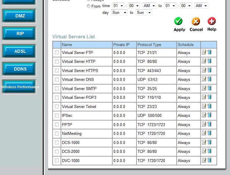

    Set up an FTP server, on the router, forward port 21 to the IP where the ftp server will be. To connect to this server from outside the network, you will need to know either the current IP address of the router's WAN interface, or the domain from e.g. dyndsn.

    It's probably about TCP and UDP ports, you can unblock them in the router - look for the Virtual Servers tab or Port Forwarding and unblock the program ports for your internal IP.
    As far as I know, you have an upload speed of 256Kb/s on this link. Calculate how long it will take to send 1GB of data. A better solution will be to upload the file to a free server.

    Well, just in which one to enter it, because I have a pair ;d heh
    This is what the whole window looks like:
    How to Obtain an External IP Address in Netia for File Sharing with Router Setup
    And as for sending, it doesn't bother me and the computer runs 24 hours anyway, and I have to send it anyway.

    http://portforward.com/english/routers/port_forwarding/Dlink/DSL-G624M/DSL-G624Mindex.htm
