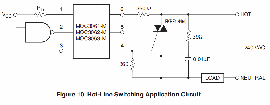

    I am building a layout like this:
    Connecting the Yellow-Green Wire in a Light Switch Installation: Practical Guide
    it is to be used to turn on the light in the room, I have three wires in the box (brown, blue and yellow-green), the question is: what should I do with the yellow-green wire? leave it in the air, connect it with the other one that is already going to the lamp? if so, what about the end of this wire at the lamp?

    In the Black Hole, as in other places, the yellow-green wire is protective, i.e. PE. Theoretically, it should be connected in your case to LOAD, but to the so-called housing/luminaire. That is, in a can, combine with each other. We don't know what that light in the room means for you. If it is a hanging luminaire, it can be connected, but in practice it is rarely used as there is a low probability of electric shock to users. However, if you ask such questions, consider whether you have the ability to implement such ideas.

    Thanks , I asked the question because I have 2 wires everywhere in my apartment , and in the new place the electricians have released 3 everywhere . In the case of, for example, a washing machine, I know that PE is for the housing, and the light bulb does not have a housing ;-) (a plastic chandelier is rather difficult to ground)

    Ok, gentlemen, nothing to be nervous about, I know a bit about electricity (certainly not as much as you do), the yellow-green PE wire is connected in the switchboard with other "PE". There is no voltage on it in the box (it's obvious), I just wanted to know what to do with it, let's assume that there will be no such device from the diagram, but only a simple light switch that normally turns on the "phase"
    try to connect it to the chandelier (enclosure) or just insulate it in a box and leave it.
