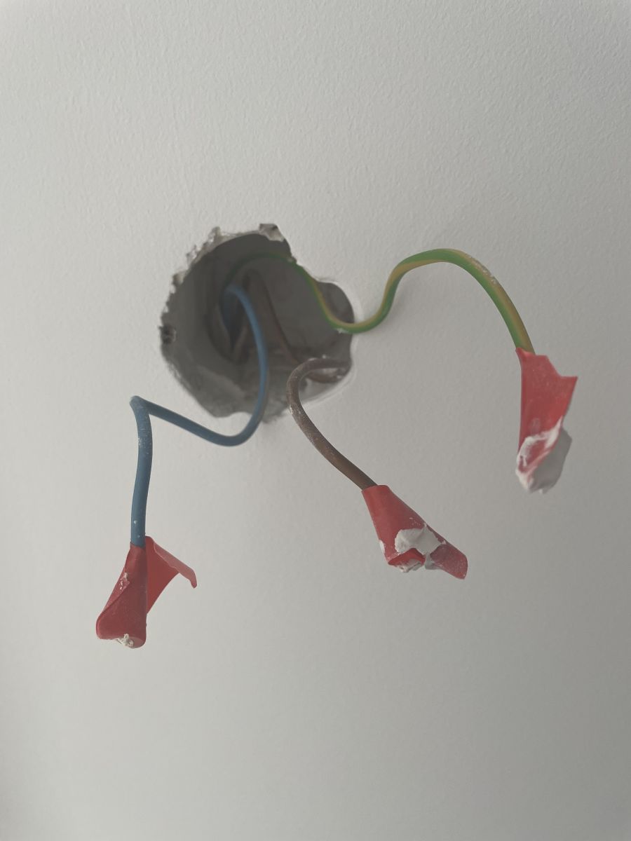

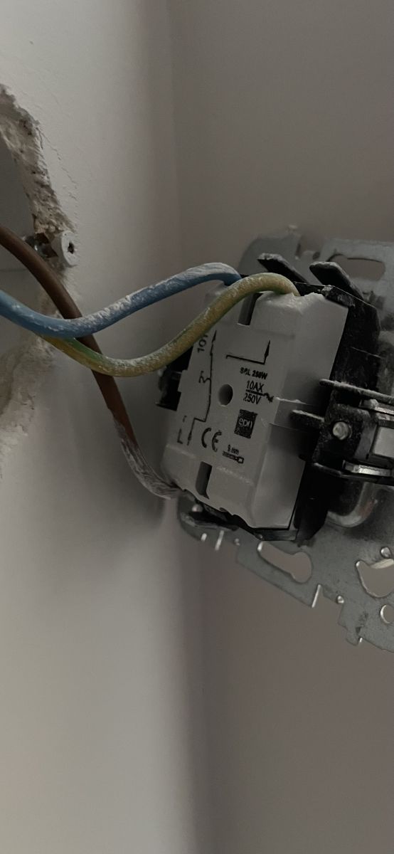

    I have a two way light switch in the entrance hallway. One switch is near the front door. The other switch is near the door on the other end of the hallway.
    Both have the following wires:
    1. x1 Brown (Live)
    2. x1 Blue (Intermittent Live)
    3. x1 Green/Yellow (Ground)
    Firstly, does Brown go into common on both switches, and Blue goes into L1 on both switches?
    Secondly, what do I do with the Green/Yellow wire? The Lexman switches don't seem to have a place to put the Ground wire anywhere, nor can it be connected within the plastic hole. Any ideas?

    According to your description, you have a regular stair switch installation there.
    If you have only 3 wires in both switch boxes, then there must be another box somewhere where it is all connected.
    I'm afraid that without a visit from an electrician, who will be able to examine the installation and find out how it should be properly connected, there is no way.

    It's not grounding.
    Heaps of people are about to start cursing your electrician out of existence for using it like this, but it's just another 'hot' wire. Treat it like a live, third colour.
    Unfortunately this is common practice on construction sites to make it cheaper and simpler to do the installation.
    Unscrew/remove the lamp(s) from the fixture.
    One wire has voltage - this is the power supply. To the common terminal of the first switch. You will identify it with a neon light.
    This will only be the case in one box.
    In the second, one wire has a transition to the luminaire (it should be on the footer, but it varies).
    To the common terminal of the other connector.
    The other two are located between the switches.
    Connect to the other terminals of one connector and twist at the ready, the other connector, connect in the same way but do not mount it to the wall.
    Screw in the bulbs, check that it works - turns on from one (and off), turns off (and on from the other).
    If it doesn't, swap those last two wires with the places in the other connector (don't move the common terminal).
    Generally, if the colours match (I don't know how it's actually wired without checking), but if they do, the order of these last two should be identical in both connectors.
    You need to identify the two wires - the power supply (with the installation unzipped and no bulbs in the holders, it's the only one that has voltage) and the outlet to the lamps (from the other connector). You cannot do without a wire continuity meter here.
    Of course, I hope that this is a simple installation and there is no 3rd or 4th switch in a different place, because this is a different game.
    Or the fitter hasn't mixed up something in the connection.
