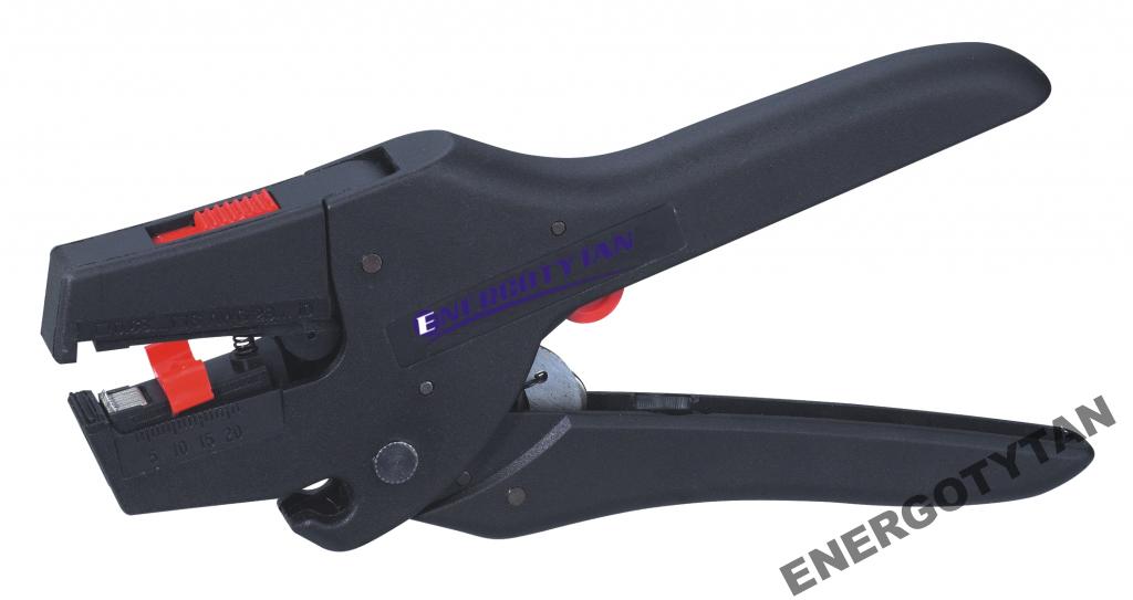

    Hello, someone uses an energotitanium puller model Z-D3 to buy on the Allegro, how does it work and is it worth the price.

    After a few days, the rivet from the handle fell out, so he went to the warranty. After about 2 months, something was done with the pressure because the knives began to slip on the insulation. For this price, I advise against it. Yato served me longer and how much cheaper.
