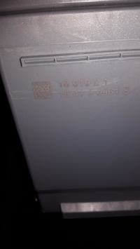

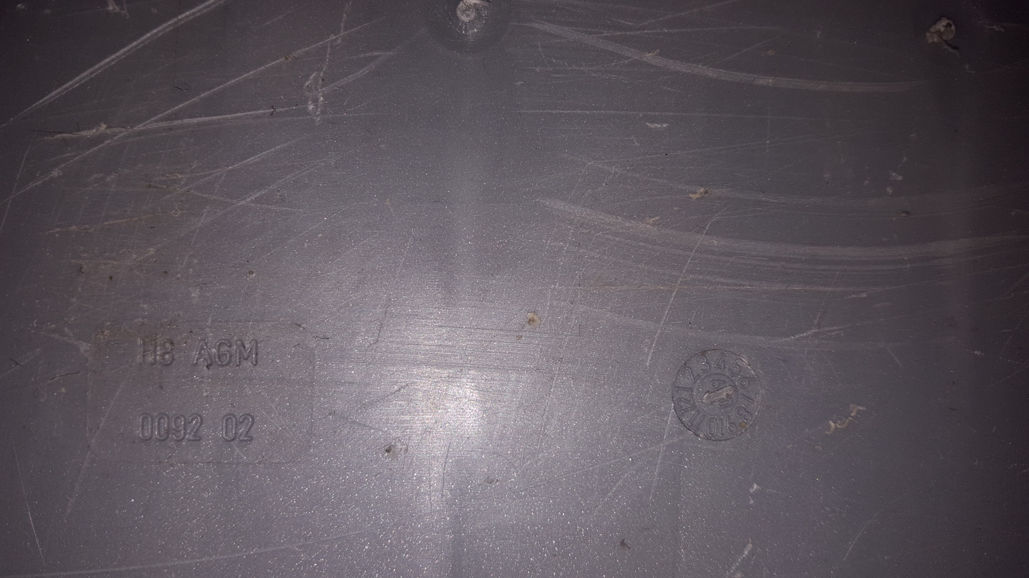

    I am asking for help in deciphering the date of production of the battery purchased today.

    Try to set the date of production, based on the battery number and using: Link . The link is posted at: Bosch Elektrowerkzeuge Herstellungsdatum Akkus
    Codes containing dates are stamped (smelted) on the battery casing permanently and printed on stickers attached to the battery, to enable eg identification of the faulty series.
    I suggest you perform independent tests with serial numbers to confirm the validity and usefulness of the link: http://anklam.ch/test/bosch.php

    The number you have marked is the catalog number, after which the product is searched, not the serial number.

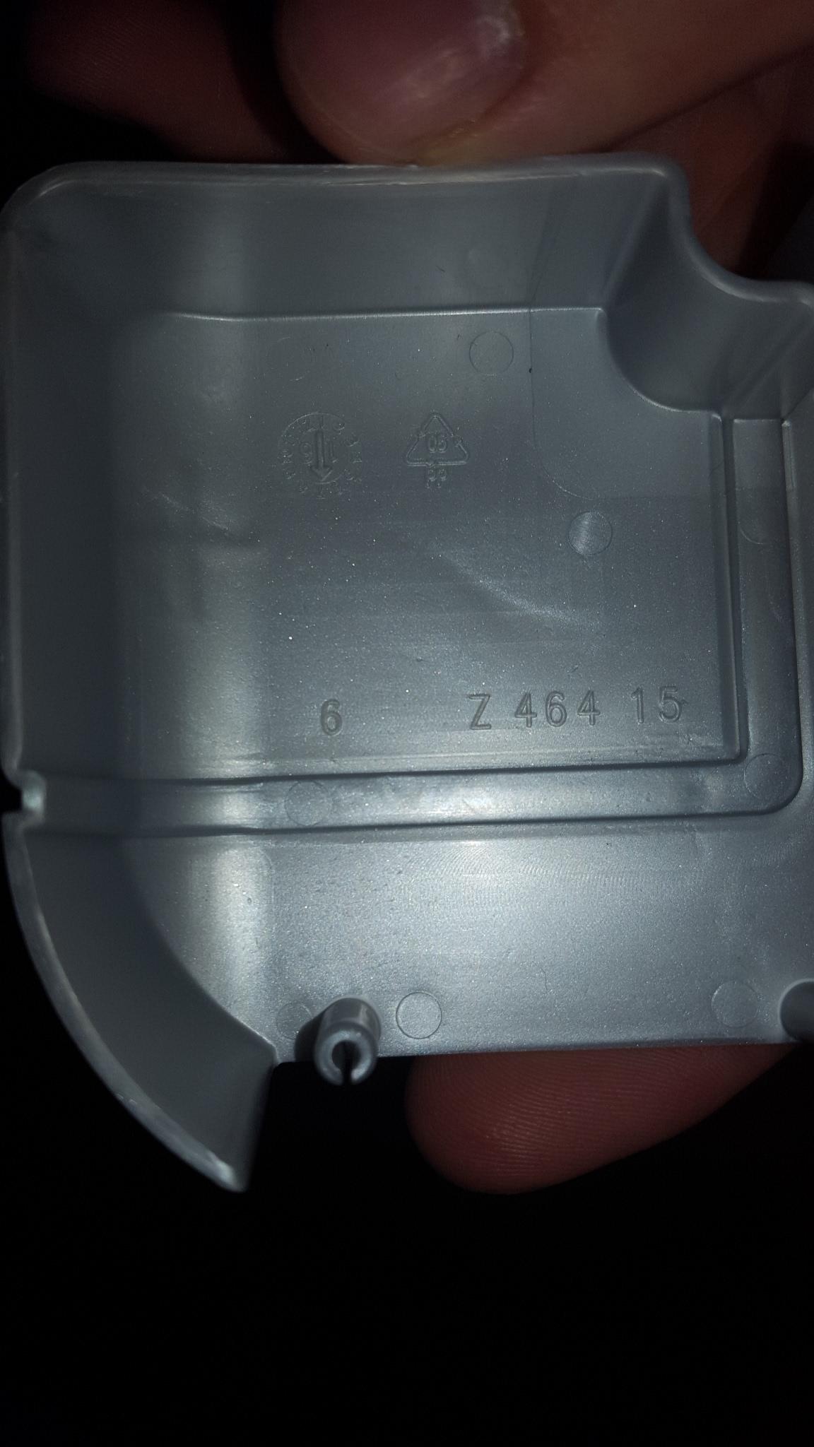

    I received a response from BOSCH:
    On Bosch batteries, the production date code has not been put on for some time.
    and information about this particular battery.
    The first copies were produced in 2013.
    On my own, I determined that the plugs on the keys have a production date of 07.2016. that is, the battery was not released from the factory before that date.
