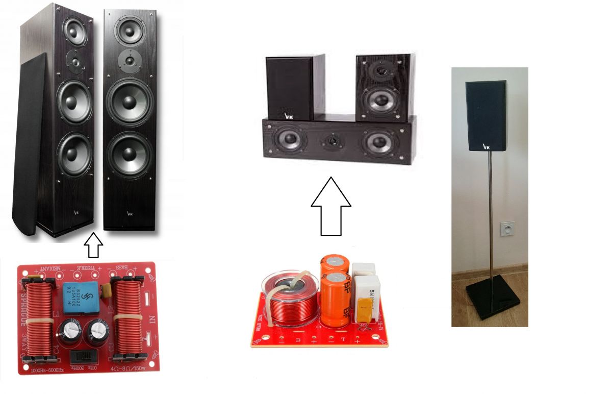

    I do not agree with the opinions who say that these loudspeakers are weak for me, a revelation for this price, the expense that needs to be added is PLN 250 and I really recommend the loudspeakers for such high front ones. framed so high ...
    http://allegro.pl/tonsil-oryginalny-gdwt-9-100-fp-gdwt-9-80-5f-gwar-i1412720048.html
    for the rear and central ..
    http://allegro.pl/gdwk-11-100-maxton-jak-tonsil-ferrofluid-faktur-i1410387013.html and there is an effect in the middle, there are original crossovers, I only replaced the 2.5m cabling, made like the original, this is how it looks I recommend these vk playing on the receiver DENON 1611

    but remember also that if you want to get a good effect, the cables should be as thick as possible and of good quality because such cables from Paździoch from the bazaar will not work

    and there is an effect inside, there are original crossovers, I only replaced the 2.5m cables, made like the original, this is how it looks, I recommend these vk playing on the receiver DENON 1611

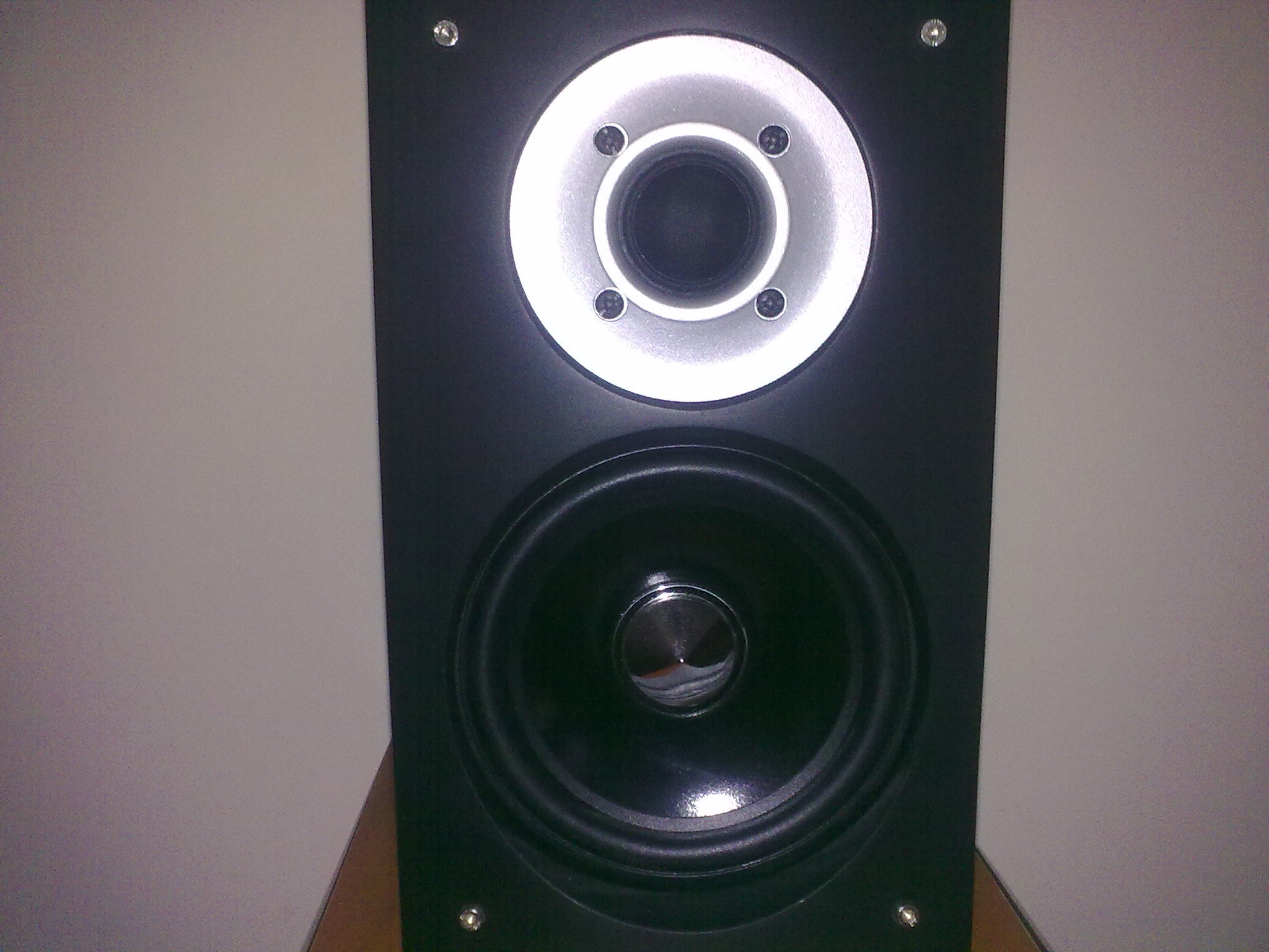

    I am sorry to wake up a post from a year ago, but I am interested in the matter of the photo of the plastic grilles on these speakers. Are they glued or the pins for attaching the fabric grilles are also the screws that attach the plastic grilles.
    I will be grateful for any information.

    Probably there are metal balls in the corners of the grilles and the holes in the loudspeakers have a magnet or just usually plastic balls and slightly smaller holes to sit tighter or on these ribbed rings.
    Yes, according to the manufacturer's description, the material grilles are on magnets. And my question concerned, maybe I did not define it well, those black plastic grilles that are directly attached to the "boxes" of the speakers. I mean how to remove the speakers. I'm afraid they are stuck. Bigtomi6630 had to disassemble them in order to replace the speakers.

    It seems to me that it's probably the latches, but I'm not sure. Maybe the owner of the topic will tell you something.

    -I replaced the crossovers for three-way for the front speakers and two-way for surround and center, and cables inside for 2.5 mm2

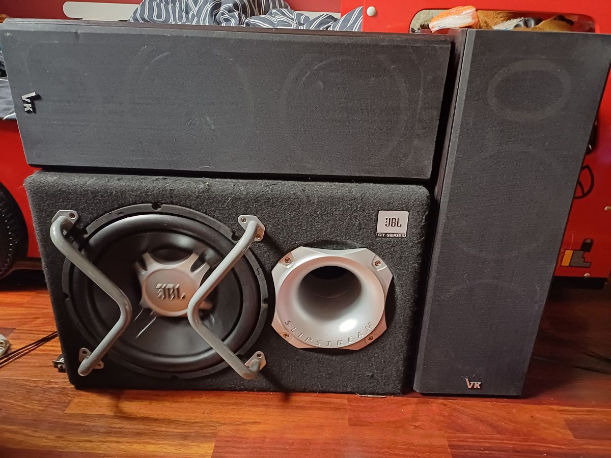

    Voice Kraft and JBL speakers placed side by side on a wooden floor. In my opinion, the Voice Krafts are super equipment. They can cope with a JBL 1100W set up, I just had to fiddle with the amplifier
