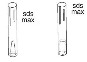

    Hello. I would like to join in with a question. Well, I`m wondering if you have a good way to drive pin earth electrodes. I heard that it can be done with an SDS Max impact hammer. Do you need a special hammer tip or maybe a special grounding rod with a holder for SDS MAX?

    I used a Bosch hammer and a special driver converted from an SDS Max cutter to drive hundreds of squid :) You also need a short "hammer" (pin) made of a hard material so that it does not "stick together" during hammering.
    It looks similar to a small lace without sinters, only in a mini-very mini version :) turned on a lathe and welded.
    In galmar - in the place where it is folded, a short mallet made of hard material is inserted (it cannot be too long or it will bend) and this in turn "goes" into the "lace"...
    If I remember, I will post a photo tomorrow.

    You can even buy such "tickets". One note, the hammer must have a minimum impact of 10J, then it goes like butter... :)
    _______________________
    EDIT:
    PBGSDSMAX SDS MAX impactor for driving copper-plated threaded earth electrodes 5/8", 3/4" PLN 126.17/pcs.
    Cool thing. I need to buy something like this or try to make it.

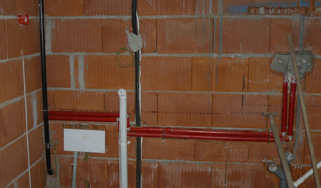

    Next question: How do you mask GSW. What I mean is that in the boiler room (where GSW is most often placed) there are usually tiles and there is a problem because the GSW box disfigures the wall. For example, I came up with a solution in which I glue metal plates to the box with double-sided tape, and the tiler glues magnets from the inside to one of the tiles that are supposed to cover the box, and then screws on a handle (an ordinary furniture handle) from the visible side, and thus covers the box. . It looks quite aesthetic. Especially if there is no handle, because then you can`t even see the one ungrouted tile. But if you want to get to the box, you have to pry it up with a screwdriver.
  • #37 9350290
    Łukasz-O
    Admin of electroenergetics
    Posts: 21789
    Help: 654
    Rate: 4292
    Without exaggeration, this is a technical room. The pipes in the boiler room don`t bother people, but the masking cover does :lol:
    You can do as you suggested with a "magnetic tile", but this is rather a later concern and not an electrician`s concern.
    I provide standard inspection boxes, the tiler fits them and covers them in his own way, here`s a first-hand example (raw state):
    Newly Built House Missing Grounding and Incomplete Electrical Work , Newly Built House Missing Grounding and Incomplete Electrical Work
