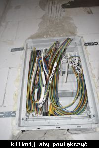

    Please advise
    1. New house, no foundation grounding /the bricklayers rushed to pour/.
    2. The project assumes GSU/GSW grounded connected to the shower trays, pipes and possibly the housing of the stove, refrigerator and connected to the lightning arrester.
    3. Installations in the house made entirely of plastic.
    4. Electrical installation company made the internal installations
    5. In about a week they will be connecting the main switchboard in the house /Hager 2x12 for a house of 100m2/.
    5. Along with the WLZ 5-core 10m2 at a depth of 0.8m to the ZE box in the border /20mb/ galvanized steel cooper was laid and at the wall by the wire was introduced to the switchboard. Ultimately, the gentlemen want to connect this to the ZE grounding in the box in the boundary but I learned that this is illegal.
    Please advise what to do now, as I do not want to be green when I require changes from electricians listening to their wisdom. I will add the area is sandy, dry.
    I am able to do the work myself tj=/and force the electricians to connect them/ dig the lagging around the house at 0.7x 2m from the wall due to the terrain and lay the cooper with leads in it at 4 corners and near the boiler room. But what to do next. Layout of the network is probably TNC because it is so in the conditions, although the new earth connection 300m which pulled ZE d the border of the plot has its own ground and, 5 wires.
    PS switchgear is for 24 modules Hager Volta, into the switchgear goes 16 wires, the electrician says that there is enough room for all the protections???? boiler room, living room, kitchen, bell, bathroom 1, bathroom 2, upstairs lighting, first floor lighting, first floor sockets, upstairs sockets, stove power, outdoor lighting, outdoor sockets, stove socket, alarm power, ie. main disconnector 4 poles 100/4, surge arrester B+C 12/280/4, differential 4 poles 100/4, eski cls6-c3 eaton x1, cls6-b10 eaton x3, cls6-b16 eaton x9pcs, cls6-b16/3 eaton x1, phase power indicator.
    I'm already confused I asked another electrician and it is ok. I read the forum and according to is bad. What now

    What the colleague described in his installation makes no sense, it will not fit in this switchboard, not to mention the space reserve.
    One differential for everything will take revenge in the future.
    GeoCa wrote:
    5. Along with the WLZ 5-core 10m2 at a depth of 0.8m to the ZE box in the border /20mb/ galvanized steel cooper was laid and at the wall with a cable entered the switchboard. Ultimately, the gentlemen want to connect this to the ZE grounding in the box in the border but I learned that this is illegal.
    Rather pointless. On the other hand, it is not illegal only ZE does not really want to perform such things.
    The earth ground should be made around the building in order to equipotentialize the ground on which the building is located and not just to give ground potential to the GSU/PE bus.
    GeoCa wrote:
    What now.
    Where is the DRAFT?
    Recommends four-conductor cable and a larger distribution board

    2x12? Fellow switchgear 3x20 is now such a minimum by current standards in private homes.

    16 circuits + 3 disconnector + 1 controls + 4 RCD 4poly + 4 SPD
    GeoCa wrote:
    4 poles 100/4, surge arrester B+C 12/280/4, differentiator 4 poles 100/4, eski cls6-c3 eaton x1, cls6-b10 eaton x3, cls6-b16 eaton x9pcs, cls6-b16/3 eaton x1, phase power supply indicator.
    After all, this is already 29 modules

    I know but he claims that not every circuit will be on one esca because the lights are duplicated

    Electrician says not every circuit will be on one overcurrent circuit breaker.
    Otok and Gsu I can make myself however will there be anything to connect to since everything in plastic? I want to make a lightning protection system later, first I want to finish the house and when the money comes together will be done.
    The price was per point 25zł, on the first floor came out 64 points.
    Differentials claims to give 3 phase for the entire installation.
    Apparently there is a separate wire for the stove, stove, dishwasher.

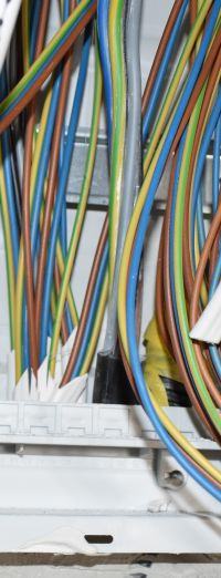

    Earth cable as in the picture 5 wires but cross-section I do not know what.

    GeoCa wrote:
    Differential claims he will give 3 phase for the entire installation.
    Error.
    GeoCa wrote:
    As I've written I've had several companies on the call and each says no need for gsu and lightning arrestor.
    Second mistake
    Small switchgear - third mistake
    What is wrong with the electricians in a colleague's area ?

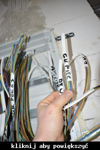

    Buddy, post the descriptions of the individual cables. From the photo it is impossible to read them.

    PS switchgear is for 24 modules Hager Volta, 16 wires enter the switchgear, ie. main disconnector 4 poles 100/4, surge arrester B+C 12/280/4, differential 4 poles 100/4, eski cls6-c3 eaton x1, cls6-b10 eaton x3, cls6-b16 eaton x9pcs, cls6-b16/3 eaton x1, phase power indicator.
    Let's count;
    16 wires,
    . main disconnect switch 4 poles 100/4 4
    , surge arrester B+C 12/280/4 4
    , differential 4 poles 100/4 4
    eski cls6-c3 eaton x1 1
    , cls6-b10 eaton x3, 3
    cls6-b16 eaton x9pcs, 9
    cls6-b16/3 eaton x1, 1
    phase power supply. 1
    In total we have 27 fields and that's not all, 14 overcurrent and we have 16 conductors, where are the rest?

    Kolego, post the descriptions of the individual cables. From the photo it is impossible to read them.
    1bell
    2gn floor rooms
    3gn stove
    4gn bathroom
    5gn bathroom floor
    6ośw floor
    7button?? whatever it means
    8ośw first floor
    9gn boiler room /gn washing machines also in boiler room/
    10gn rooms
    11gn exterior
    12gn kitchen
    13gn dishwasher
    14gn power stove
    15alarm
    16 unreadable

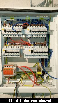

    Electrician suggested, main disconnector, B+C surge protector, 3f differential for the whole, phase indicator, 3f circuit breaker for the stove force, and the rest of the eski, with the fact that he wants to give sometimes several circuits per "eski". From the switchgear cable to the cooper along the power line to the ZE box.
    From my calculations, it seems that it should actually be RG 3x12 because;
    differential g 4, limiter b+c 4, differential 4, indicator f 1, circuit breaker 3, the rest of the circuits circuit breaker 13, which gives us 29. In the future, additionally 2 differential 1f. Well, unless as an electrician hooks up several circuits to 1 overcurrent circuit breaker. On the ISE forum they say that it is not bad because on 1f circuits many circuit breakers can cause the main protection to blow.
    I already know that I myself will make a lagging at a depth of 1m average distance from the house 1-2m with 4 outlets for future lightning protection, and the 5th outlet to GSW in the boiler room, from where the line to the RG. The question is whether to connect this with a cross link in the ground with a cooper over the PE?

    I see at most 13. If you combine well, it would go 3 RCD single-phase. For peace of conscience, I would request a separate RCD for the central heating boiler and replace the switchboard with 4x12 modules. I don't see a problem with forging the wiring and embedding a larger enclosure. The old box the electricians will use, to the dried foam the new one will hold well :) . If already a larger enclosure, it would be useful arota pipe 50 or at least 40mm led in gentle curves from the switchgear to the outside of the building below ground level in case w. As for the grounding is a ban on splicing with ZE grounding. This is not why there is a 4-pole disconnector disconnecting the power supply in the switchgear to introduce a dangerous potential by means of cooper in case of a failure in the network. Introduce a ground with the lowest possible resistance, for example, in the boiler room, connect to metal pipes and PE bus in the switchgear. So much can be done in your building at an additional cost of 400 PLN, so I think it is worth the extra.

    One circuit for kitchens is definitely not enough.

    Construction is nearing completion, the plasterers are getting ready, and here are a few more questions ...
    Is the cable (because the ground is a cable, not a wire) running to the connector in the fence (the so-called Internal Power Line) is 5 or 4 wires?
    What is its cross-section? To my eye, 99% does not have the required 10mm2.
    Why was it not led to the switchboard in the return so that in the future, in case of "W" I could push into the return at least a fiber optic cable for the Internet or, for example, some kind of intercom?
    Will the distribution point be in the connector or in the switchboard at home?
    What kind of power connection do you have, dear investor? What pre-metering protection?
    Unfortunately, these are the effects of paying per point. 1 circuit of sockets in the kitchen? :-)
    Are you not planning to have a 3-phase outlet anywhere? The only 3F reception is "stove"?
    No garages, outbuildings, etc. planned?

    RafZielak wrote:
    The construction is coming to an end, the plasterers are getting ready, and here are a few more questions ...
    Are you not planning to have a 3-phase outlet anywhere? The only 3F reception is the "stove"?
    You don't have any garages, outbuildings, etc. planned?
    The ground wire is 5 conductors and has a cross section of 10mm2.
    Please advise. The electrician laid 20m of cooper from the WLZ to the ZE box.
    Fiber optic cable will not be needed. I have been using LTE forever. Under the intercom, there is a peszel introduced to the distribution point and to the fence.
    Distribution point seems to be in the connector box, new Energi ground network about 300m including grounding.
    Connection power for the time of construction was given 7kW. And the proper plans so far 15kW.
    I was not aware /unfortunately, this is Poland building a house you need a master's degree in any profession/, that one circuit for outlets is not enough. Surprisingly in the project is similar!!! I added on my own additional circuits for the refrigerator, dishwasher.
    I do not think there is a need for 3f additional, tesla I will not buy, and space in the boiler room I do not have unless by the ceiling, while giving it on the facade is not aesthetic.
    Only a carport and I think I will lead an additional peszel in this direction.

    RG replaced, it looks better from the start Hager Volta 4x12:) :)
    Routed additional circuit to the kitchen, changed outdoor lighting. I am in the process of digging the cooper around the house. For the sake of time it will take some time.
    I have a question, should a cooper go on the power line to the box in the border of the plot? The box itself shows the cooper going into the ground. A neighbor made a water connection next door and supposedly broke off this cooper and did not report to anyone and Energa on the hotline did not accept such a report from me. Here is a photo:
    Please advise. The electrician laid 20m of cooper from the WLZ to the ZE box. .
