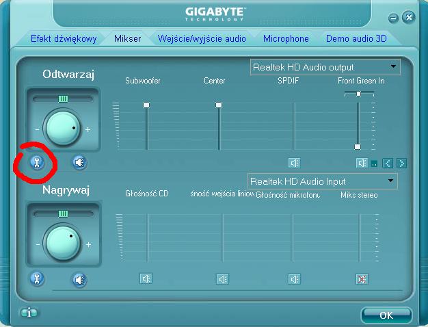

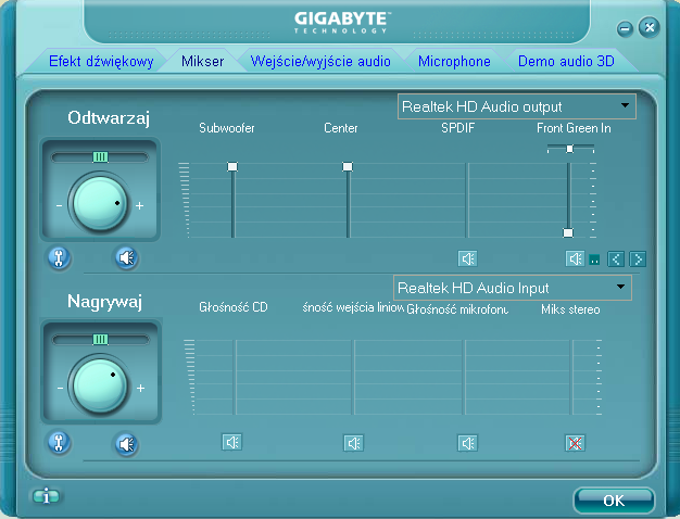

    Refreshing, the problem is not solved ...
    Why Do Others Hear My Music on Ventrilo Through My Headphones? How to Fix Audio Leak?
    These are my bowl settings!
    Help.
    Best regards.
    #9 8264311
    lekto
    Level 35  
    Posts: 2716
    Help: 294
    Rate: 299
    With these arrows on the right you are looking for the microphone and set it to the minimum.

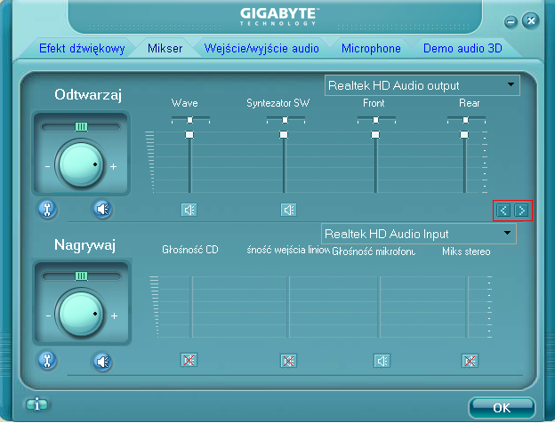

    Regarding this:

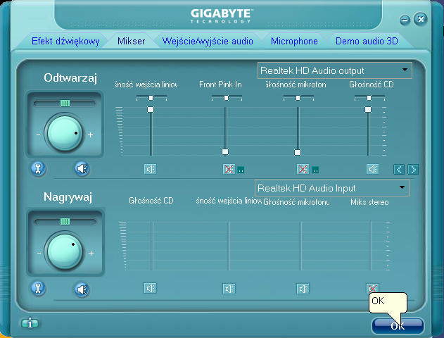

    then when I click this arrow it pops up:
    Best regards.
    #11 8265019
    lekto
    Level 35  
    Posts: 2716
    Help: 294
    Rate: 299
    and highlight the microphone volume in the list and search again with these buttons on the right.

    I did just that, I have at least the same problem as it can be. Here is another screen as it looks like:
    I'm waiting for help.
