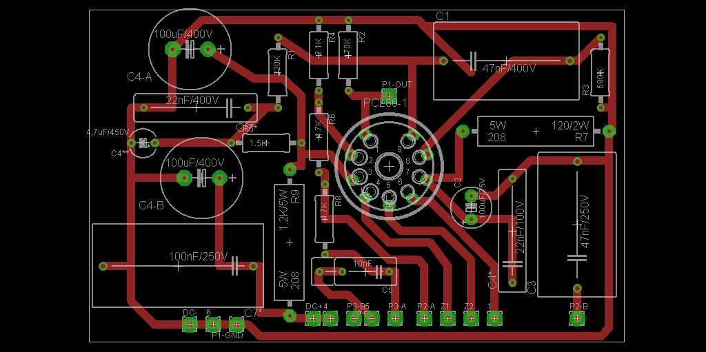

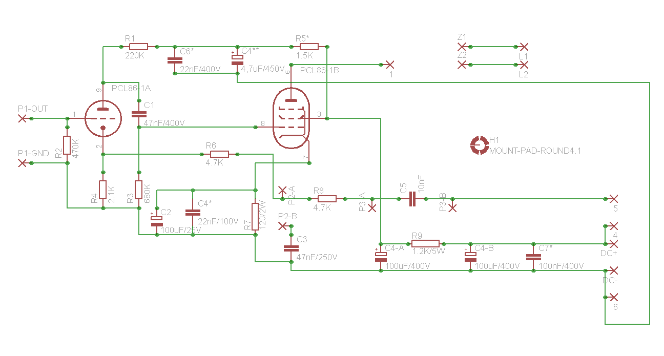

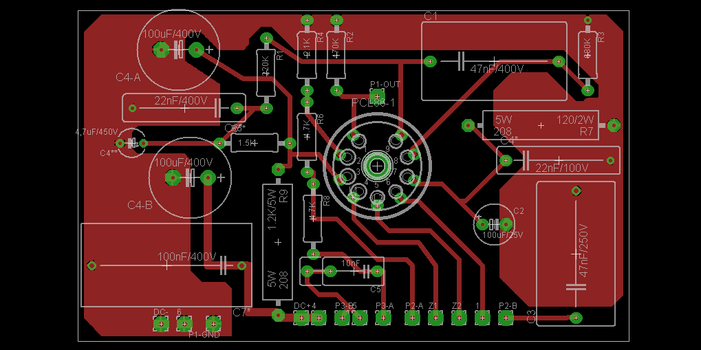

    The scheme is fine. In addition to a few details that I always talk about in the Bambino scheme: 100k in anode triodes and 22-100nF as a coupling. Otherwise it will sound like a telephone.
    The tile, however, is not properly designed. There is no one thick mass rail. You mix high-current (high-ripple) sections with low-current ones. They should be separated or connected so that at the very end there are connections through which the smallest current flows: input, leakage resistors.

    Slide the electrolytic capacitors away from the power tubes. 47uF in the power supply will not be satisfied with such conditions.

    You're right, there's no dot. Without it, a minus of the right capacitor is connected to the minus of the power supply, and the whole mass of the amplifier hangs in the air - the system would not work. Probably the error results from the fact that in the original system a double capacitor was used, having one common negative lead for both capacities, and at the same time a metal enclosure connected to the minus, then connecting the minus outlet with the downside of the power supply, and the rest of the elements would be connected to it through the housing capacitor screwed to the chassis.

    1) Too thin mass path. It would be good to "extinguish" the middle peg of the stand.
    2) I am not advised to drive anything under the 47uF capacitor. The paths are too close.
    3) Why are you afraid of stretching some resistors? - such as 100k. Such a tangle of paths by the lamp may not please her.
    Be assured that the first tile may be suitable just to the basket.

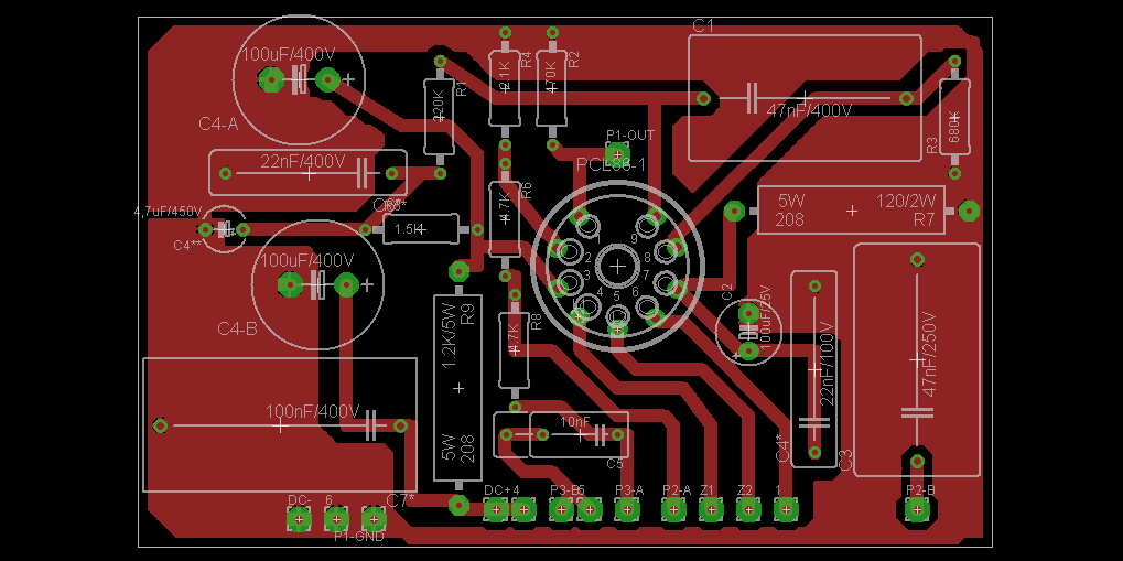

    If you are not afraid of 'wasting' some laminate, I can give you my (untested!) Layout for PLC86. (How I find it ;)
    I do not have the equipment to etch the tiles myself, but if I have already ordered it (costs) I am convinced that it will work.
    I would like to break the common opinion that it is not possible to do a working ;) tile right away. But unfortunately I do not have any materials ...

    I was just about to ask - do you want to have a glow on the tile? I would give them separate cables on the bottom of the chassis, and to the plate at right angles.
    And do you have any preferences regarding the setting of lamps? Mainly it is about which way the eye is to be turned. I have a laid out layout for such an amplifier (I just have to make it in some reasonable way, because my working notes hardly anyone will understand ;) ), EM84 can be rotated in it in quite wide limits.
    And the anode triode resistor asks to give it from the bottom of the stand, directly on pins 3 and 9.

    It will disturb you.
    First of all, the whole mass loop will be made. The system may start to whistle, wheeze and go crazy for no particular reason.
    Second, it will be easy to get a raise.
    It looks quite reasonable. Try it.

    Mass loops are one of the basic problems of any tube amplifiers.
    And my remarks from my own experiences from 40 years ago:
    1. ECL / PCL 86 lamps were most often mounted horizontally, facilitating heat dissipation. In addition, the lamps were oriented in the own axis in such a way that the bars of the net tensioners were in the vertical plane. This prevented the mesh from gluing in case of overloading.
    2. In addition to the change proposed by the moderator in the scope of capacitance of the coupling capacitor, I will provide as part of my own changes that I made in this amplifier 40 years ago:
    - C1 and C3 capacitors changed to 22 nF stryrofelx 600V;
    - C2 capacitor changed to 0.1 styroflex 160V microfarad
    - I removed the capacitor C4 (cathode electrolyte) - it is not needed and the removal greatly improves the sound of the amplifier with slightly reduced sensitivity of the amplifier (about 5 dB), which is easily compensated by a larger control;
    - C5 and C6 capacitors increased to 100 microfarads;
    Watch out for the voltage resistance of the drive indicator system capacitors - resistors R10, R11, capacitor C7. On the pentode anode, the DC voltage is as much as the supply voltage, while the variable component can reach a value of even about 100V. In case of overloading, the voltage may be higher than the supply voltage (the transformer acts as an ignition coil in the car) and I would be scared to install capacitors with a working voltage of less than 1 kV.

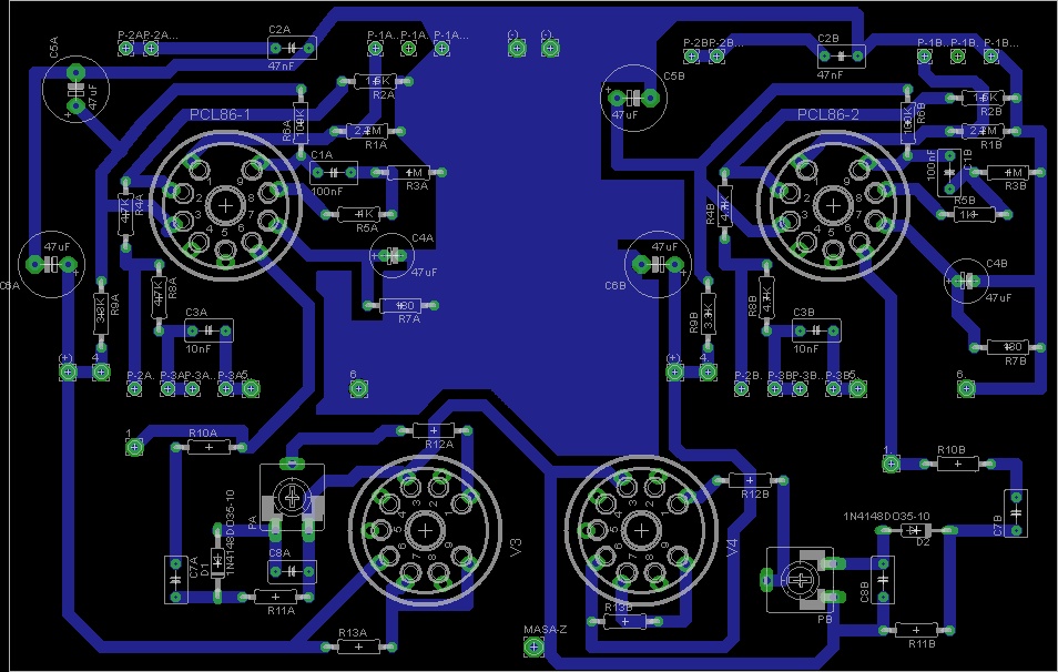

    The tile on the left will create a beautiful whistle - a mass loop created by the filled areas.
    I would be more inclined to the right picture if it were not for a few things that I told you earlier.
    - the path of the mass is definitely too narrow, it can even be thickened with a wire if only the expansion was not enough. In addition, it creates a closed loop, which is unacceptable.
    - you have an unconnected central peg. Even if you do not have it in the stand, it's worth to make a dot out of it.
    - capacitor C2 / 100uF / will be unhappy with the working conditions, move it away.
    - make signal paths narrower, it will be harder for them to catch interference.
    - 220k in the circumference of the triode anode I would give a one- or two-watt.
    - this system will whistle and chatter if the entrance hangs in the air. Try to connect some empetrojka or zworzyj R2 / 470k / for the duration of the trial.
    - under C1 / 47nF / you have a strange clove.
    - mix the mass of the power supply, pentodes and triodes. Ripples are transmitted through the ground bus and cause excitation. The closer to the entrance, the more "low-voltage" circuits you should have. If you can not distinguish it on the board, make it a thick wire.

    It probably meant that they are like 3 "blocks", each has its own local mass, which combine into one general. In the diagram you have shown the mass run of the rail - these "steps" separate the masses of individual steps and show the order of connection.

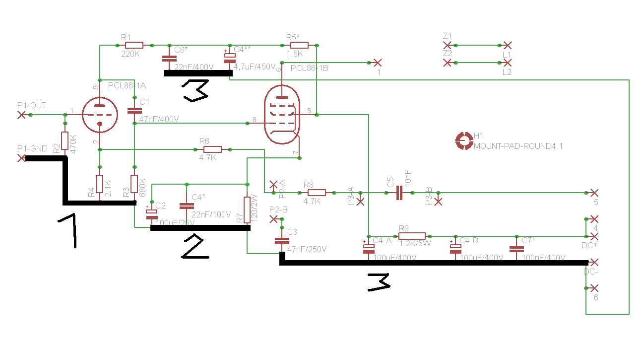

    Creating a Tube Amplifier with 2xPCL86, EM84 Indicators and Transformers TG2.5-1-666 & TS40/29/670
    I let myself brutally treat this scheme with paint.
    1 - tiny ripple at the very end of the chain.
    2 - greater ripple, in the middle of the chain
    3 - high ripple at 100 Hz frequency, as close as possible to the bridge rectifier, so that they do not move along the rest of the system.
    Now it is understandable?
