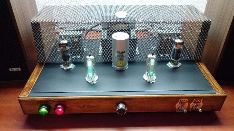

    Hello everyone
    Today I would like to introduce you to the design of a tube amplifier, this is my second tube design. After the successful construction of a long wave tube radio receiver - link below
    https://www.elektroda.pl/rtvforum/topic3549270.html
    I decided to build a tube amplifier - as the budget for a tube amplifier was not too big, I decided to use what I had at hand, i.e. components from old Bambino turntables and ZK120 and ZK140 tape recorders.
    My assumption was to build a low-power stereo amplifier with a drive indicator. The circuit includes two ECL86 tubes and two EM84 magic eye tubes, for this I used two Bambino output transformers and two mains transformers. I decided to make two separate monoblocks, i.e. completely separate mono amplifiers in one housing.
    I decided to make a PCB for the amplifier - just like before, I decided to make a PCB design in Eagle, and then improve the track layout in GIMP so that the PCB looks like the one from the AM radio to which I gave the link above.
    As I had not done a tube project using high anode voltages before, after thinking about it, I prepared a few PCBs:

    The amplifier was launched - so far without an anode voltage stabilizer and without a delayed anode voltage system. These tiles are being prepared. Later, these circuits will be added and I plan to use some audio input selector. I also wanted to make an ECC83 tube preamplifier with tone correction, but so far I rejected this idea, why disturb the frequency response characteristics. There will also be an additional RIAA phono preamplifier based on an ECC83 tube. All boards with tubes will be GIMPed to make everything look nicer - the voltage stabilizer board for the delay of switching on the anode voltage and possibly the input selector will be made traditionally in Eagle.
    As for the sound quality - to be honest I did not expect such a good sound from this amplifier. I used used elements in this lamps - the costs incurred by me were minimal - I had all the things, I bought a laminate and ARK connectors and 3.3k resistors because those used in Bambino were larger, so I used newer ones to fit nicely to my PCB. Total costs PLN 30 + housing costs, I think about something made of wood. There will also be costs for additional delay plates and stabilizer. But I try to do everything with the items I have. From the ZK120 or 140 magnetophone I also have an ECC83 tube so it will be used for the phono preamplifier.
    But going back to the sound, I was a bit afraid of running this amplifier on a PCB - I read on the forum that bad path routing would result in hum, hum and other distortions, I designed the PCB myself and then finished the graphics in GIMP, made a thermal transfer, etched, soldered elements and commissioning - and here a pleasant surprise - nothing, no hums everything perfectly in the absence of an input signal silence, some wrote that you need to connect one leg of the radiators to the ground because there will be a hum, I did not do it and it works perfectly (of course, if necessary, you could to connect it with a cable).
    After connecting the second PCB, there are no hums either. Everything works better than expected.

    Delayed activation of the loudspeakers is not needed if the filament and anode voltage are applied at the same time.

    Hey, there was supposed to be a delay in switching on the anode voltage but I wrote late and the error broke in, I'm correcting it, thanks for the info
    Of course, it is about the anode voltage, and applying it to hot lamps increases the lamp life.
    As for the tiles, they were designed in Eagle and the tracks were drawn in Gimp - I recommend reading the post about the AM radio from the link I gave there, everything is described.

    It is a pity to waste ECL86 on mine.
    The first one currently costs a minimum of PLN 40, as much as the new EL84.
    PCL86, on the other hand, PLN 10-15 for a tube with a decent emission or PLN 20 for NOS.
    It was better to sell those ECL86s and buy yourself a new PCL86.
    It would be good if the board was already factory-equipped with a filament voltage multiplier. Then it is easier to switch to PCL lamps.
    Another thing.
    Did the colleague check the glow voltage?
    The transformers in these tape recorders were designed for 220V.
    Currently, there is 230V in the network. Instead of a 6.3V glow, the partner has 6.6V or even more.
    If it is too large, it is usually enough to add a small resistor.

    The ECL86 are recycled, so I don't feel sorry for them, besides this is my first tube amplifier so I treat it as a science. I suspect that these lamps also do not have a good emission - a colleague is right 6.8V incandescent and a resistor has already been added in series for the filament voltage.

    Lamp emission can be judged from the anode current.
    The anode current is the drop across the cathode resistor. This drop is also the negative voltage of the first grid.
    Just compare with the characteristics in the documentation.
    Any "matching" (especially to obtain the second grid voltage that occurs on the characteristics) can be accomplished by inserting a resistor in series with the power winding.
    Since a colleague has an inflated glow, it can also be assumed that it is anode overestimated.
    It doesn't have to be that way though. The rectifier that my colleague used is selenium.
    It is old and probably has increased internal resistance.
    You have to be careful with them. They like to light up on the occasion, producing a cloud of toxic fumes.
    And here you can play with the "retro" delayed anode switching system.
    A silicon rectifier bridge and a junk PY88 in series (new one costs PLN 2-2.5) or another cheap rectifier lamp. It will delay the appearance of the anode voltage and reduce it (which will be necessary anyway due to the increase in network voltage).

    Nice, thoughtful design, but some ideas are an excess of form over content. For these lamps there is no need to use delayed anode switching, it is not the power and voltage. If this is to be a testing ground then OK. Now I would suggest to my colleague, after the appropriate arrangement of the elements in the housing, place the entire single amplifier on one PCB. The tangle of cables and most of the input cubes will disappear. The anode power supply can be properly separated. Only the filament power supply can be led using a twisted pair cable directly to the pins of the lamp base.

    Hey, this is the first version - just to hear the "lamp".
    Now I can see that with subsequent versions, if there are any, there will probably be a power supply with anode voltage stabilization - connected at once with a voltage multiplier for PCL - because it's a good idea and I will definitely use it.
    As you write, this is my first such amplifier and I wanted to experiment with caution, of course, because the circuit has high voltage.
    Maybe you can give some ideas for a proven HV voltage stabilizer and an input selector because I haven't started designing it yet.

    The tube is not a transistor (anyway, stabilization is not used for transistor terminals either) - it does not require stabilized voltage, at least in a system like here. In order for the anode voltage to be "stiffer", it is enough to have a transformer with appropriate efficiency and a rectifier or diode bridge (it has a lower internal resistance than a selenium stack). Stabilization makes sense for sensitive tube preamplifiers and voltage amplifiers.

    It is worth introducing stabilization for another reason.
    Mains voltage fluctuations.
    It is true that the lamps are quite resistant to exceeding parameters, but it is still worth protecting them, especially if they are expensive and are no longer manufactured. The ECL86 is worth it because it's hard to find new ones and the prices of the current ones are rising.
    When the prices of the ECL86 exceed the absurd level, audiophiles will probably turn to the PCL86 (although it is not so certain, after all, the tube is "television").
    Structurally, the matter is very simple. Bipolar transistor or mosfet, zener and resistor. If the voltage values are selected correctly, the power of the losses will be a few watts maximum.
    And you can also play with the implementation of the triode lamp mode.
    Some amps even have Triode / Pentode switches that switch the second grid accordingly.
    In my experimental tube amplifier I have anode stabilization, because in the final stage there is a triode with very low internal resistance (400?, 6S19P). For this the transformer gives 2x300V and I need 185V (some breaks the resistor and some stabilizer). I do not stabilize the filament, only resistors in series (0.1? + 0.22? ;) . Sometimes I just close the 0.1? resistor with a switch if the mains voltage drops below 220V (the incandescence is already approaching 6V).

    The paths were designed with regard to later changes in Gimp - hence the angular ones paths I was more concerned with the distribution of elements convenient for me ...
    As for the PCL86 tubes, you can safely use for my amplifier, the incandescent lamp is led separately on the board, so between the transformer and the amplifier board you should give a voltage multiplier and the tube will be able to work in my amplifier.
    Just one PCL86 tube after such a modification (adding a duplicator) will get you one channel (the tube has a triode and a pentode), so two tubes and you have a stereo, but without the magic eye - you only make the amplifier board.
    For this you need to have loudspeaker transformers, I have one from spoolers with 5 pcs, so I can resell it, you only need to arrange it transformer mains - preferably from the old Bambino adapter or other with 250V anode and 6.3V glow voltages, but you can also give it straight away transformer with 12.6V filament, which will simplify the system because you will not have to give a voltage multiplier ...
    Best regards ...
  • #16 17835001
    tytka
    Posts: 766
    Help: 8
    Rate: 1841
    DJCheester wrote:
    The paths were designed in such a way as to take into account the later changes in Gimp - hence these angular paths were more important to me about the layout of elements convenient for me ...
    Placement is one thing, routing is another. You can arrange elements in the same way, and lead paths in a completely different way, as can be seen in the description of this project.
    And if there were assumptions that the Eagle project was only a starting point for further development, I ask. What was the point of wasting laminate and etchant on this messy track design?
  • #17 17835105
    DJCheester
    Level 28  
    Posts: 2090
    Help: 75
    Rate: 958
    The sense that they look retro and hand-drawn, I personally like them very much in combination with tube circuits because I associate them with PCBs, for example old reel to reel tape recorders, e.g. ZK120.
    And if some people do not like it, it is difficult, I can not help it, the project is a kind of idea, but the publication nowhere says that you have to do this, if you like it, please provide thermal transfer and if not, it is difficult to do according to your own and better ideas.
    PS. PCBs still to be delivered. Willing people should write to PW.

    I'm not talking about picking on. This is not my intention.
    As you know, when designing paths, you should, among other things, keep them as short as possible. Unfortunately, breaking them always only at right angles is not conducive to this.
    For example, compare these two sample tiles. Both projects made in Eagle.
    ECL86 and EM84 Tube Amplifier - PCB ECL86 and EM84 Tube Amplifier - PCB

    Gentlemen, no exaggeration - in this project and for these frequencies, the shape and length of the tracks do not matter. He would only suggest increasing their width, there is room for it (at least for most), less etching, better solderability. Thin paths are not at all a sign of "modernity" of the project ...
  • #21 17835256
    DJCheester
    Level 28  
    Posts: 2090
    Help: 75
    Rate: 958
    Hey, as I wrote earlier - my project is like someone wrote a testing ground before and treat it like that, I learn on it myself, it is my first tube amp and probably the last one because I wanted to listen to the lamp and I just did it, but for now I will finish the project.
    As for the PCB, I kept larger intervals due to the high voltage in the system.
    Besides, I don't like "polygons" and I avoid them wherever I can.
    And by the way, I like angular things, I drive an angular car and I have a lot of things at home, let's call it from the previous era.
    And as for PCB, of course, each of you can have your own opinion and it's good, I want someone to want to build this or a similar amplifier read the topic and read the opinions and tips of all of you and built a better one than mine, I also read when I started the project dozens of pages devoted to tube circuits as well as posts on the electrode. I made, I am satisfied, above all, with the final effect - the sound quality, because I thought that it might turn out to be a huge flop that it would hum when connected and you can't listen to it, but fortunately it did not happen and I can guarantee it to all those who want to make such tiles like mine, but of course the project is open and suggestions for changes as well as comments are welcome.
    My friend, I can share .brd projects if you have time to correct them as you see fit and thus you will contribute to the development of this layout.
    Best regards ...

    DJCheester wrote:
    I can guarantee it to all that tiles like mine will want to do,
    Buddy, do not guarantee because tiles are not everything. If someone does the wrong wiring, they may be unpleasantly surprised and upset. This should also be remembered - that it should not be "cable lettuce" but made and run according to the rules.

    That's right buddy graph but as a colleague noticed Kraniec_Internetów , the idea was to point out to the author of the project that the approach he presented was not correct. In this project, it may not matter, but if a colleague of the author develops such a habit and starts more serious projects, he may have trouble with his tiles. This forum is, after all, also to suggest more appropriate solutions, to indicate more accurate methods of solving a given issue.
    And on the width of the paths, there is really no need to save.

    Sorry to dig it out, but I have a question for the author, possibly other forum members willing to help.
    I made a thermal transfer of the plate thrown in by the author (mounting the lamp from the side of the paths, because it is supposed to go above the housing), I etched it, all the paths are fine, I tinned them.
    I also have bamboo elements - including the TG2.5-1-666 speaker transformer.
    After folding, however, the system clearly hums (hum louder than the signal), I will immediately add that the signal cables are short and shielded, the heating cables are on the twisted pair. I will try to solder the incandescent resistor so that it is about 6.3v. The lamp is fully operational, in a different arrangement it does not cause hum. At the moment, the system is not grounded to any metal chassis. I do not think I need to ground the secondary winding of the speaker transformer, it is on a common path with the ground of the circuit to the PCB.
    Actually, the only difference between the circuit assembled by me and the author is probably a different speaker transformer - as I wrote, I have tg2.5-1-666, and a silicon rectifier bridge instead of a selenium stack, but this probably has no effect on the hum ...
    I do not have any filtering capacitors behind the rectifier bridge, only a bamboo 2x50uF capacitor mounted exactly like the author's, in the STAB connector.
    Tomorrow I will measure the values of all components, but this is probably not the problem, I measured everything directly before soldering.
    Do you have any ideas what can cause such a clear hum? Or some mistakes made most often by beginners, because this is my first tube amplifier.
    Invert the terminals of the speaker transformer on either winding. Maybe you have positive feedback instead of negative?
