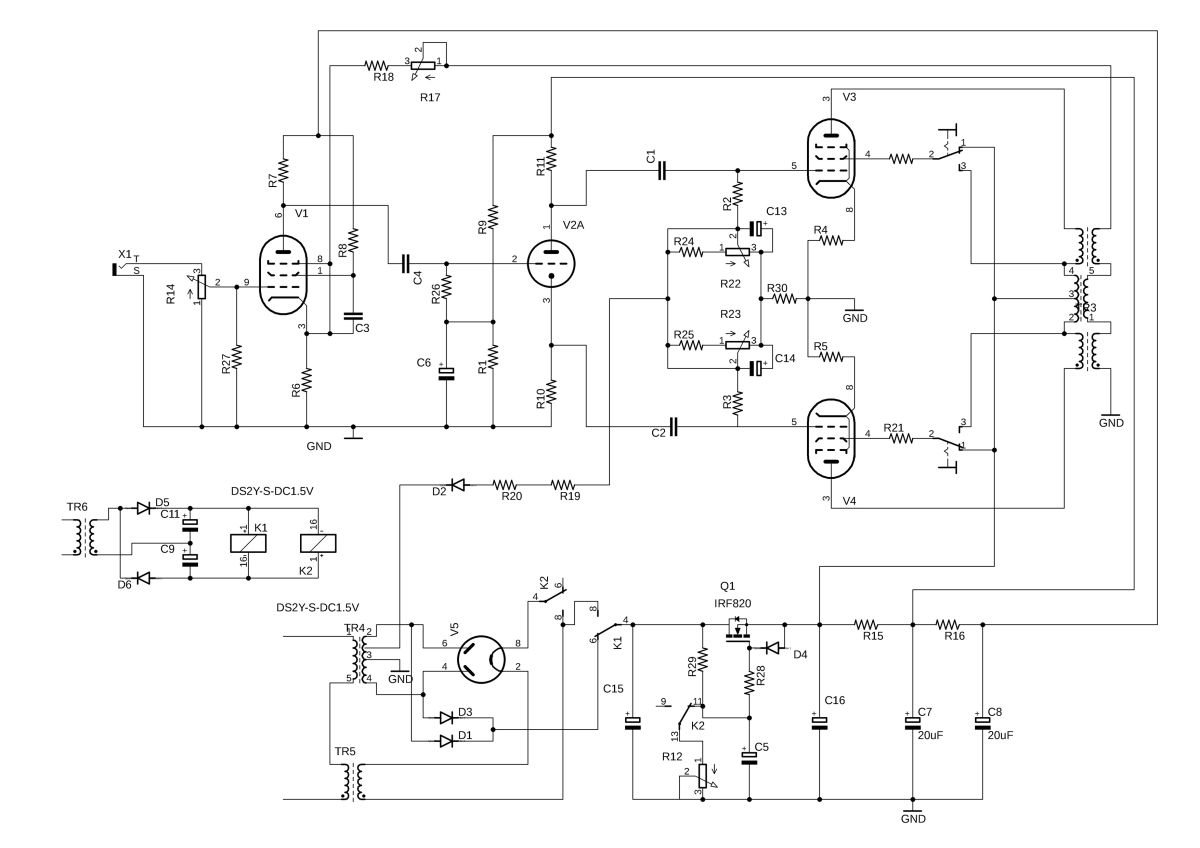

    >>21518072 Thanks a lot! After redesigning without looking for any more shortcomings I think with all parts about a month. A bit long, but that's because I'm actually doing everything myself, apart from the case, transformers, rca sockets and the like ;)
    Added after 1 [hour] 1 [minute]: .
    >>21517089 .
    please :)

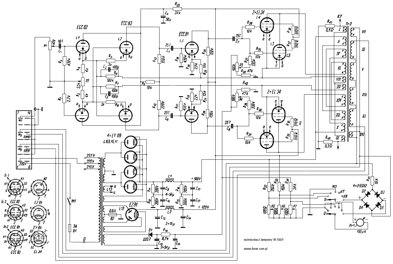

    Electronic circuit diagram with vacuum tubes and components. .

    #18 21518355
    Rocky Horror
    Posts: 1677
    Help: 97
    Rate: 334
    Strange this resting current control. The potentiometer sliders are connected in parallel. No matter how you spin them, the voltage on the first grids of both tubes - more or less - will still be the same. There is also no sensible filtering, no capacitor to ground after diode D2 or even resistors R19 and R20. The result will be a large AC voltage on resistor R30 and consequently on the bypassed capacitors. This is probably where the 50Hz hum mentioned earlier comes from.
    What is the purpose of putting the source switch on the back?
  • #19 21518529
    kris8888
    Posts: 7088
    Help: 537
    Rate: 1930
    In my opinion, the diagram probably contains errors. I don't know what the component values are, but according to this diagram, the V2A lamp of the phase inverter should not work at all.
    I also don't understand very well how the coils of relays K1 and K2 are controlled. They switch on by switching on the TR6 transformer ?
  • Questioning relay coil control via TR6 transformer switch
    #20 21518736
    Pltin74
    Posts: 143
    Rate: 132
    Rocky Horror wrote:
    No sensible filtering either, no capacitor to ground after diode D2 or even resistors R19 and R20. The result will be a large AC voltage on resistor R30 and consequently on the bypassed potentiometers with capacitors. This is probably where the 50Hz hum mentioned earlier comes from.
    fact, I had forgotten about this capacitor, but it seems to me that the cause of the 50hz is different
    purely visual, I wanted the front to be minimalist ;) .

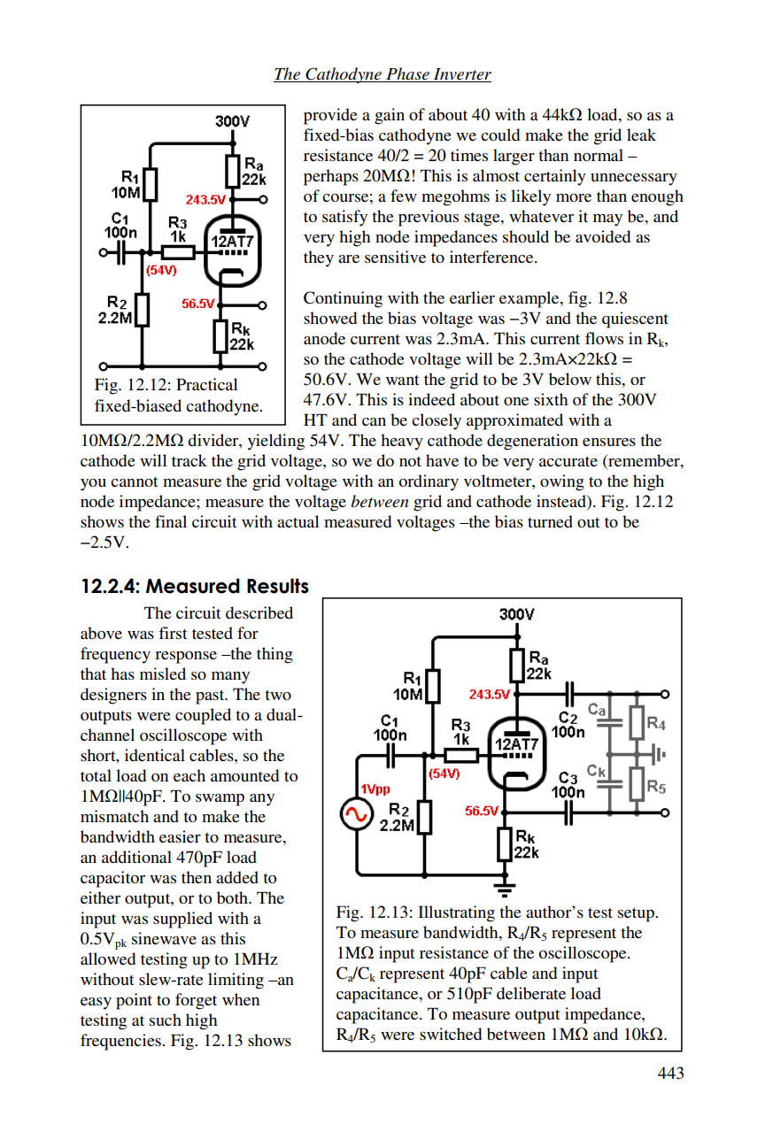

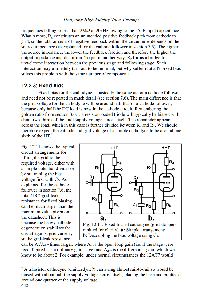

    Added after 6 [minutes]:3298872ee
    >>21518529 >>21518529 why? The phase inverter is laughing all the way ;) subsection 12.2.3.
    Page from an engineering book showing electronic schematics and text about valve preamps.
    Phase inverter schematic with cathode configuration description. .
    kris8888 wrote:
    I also don't really understand how the coils of relays K1 and K2 are controlled. They are switched by switching on the TR6 transformer ?
    there is a switch, fact - it is not on the diagram

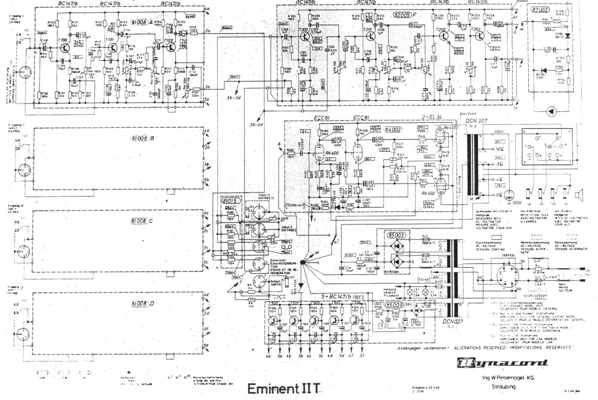

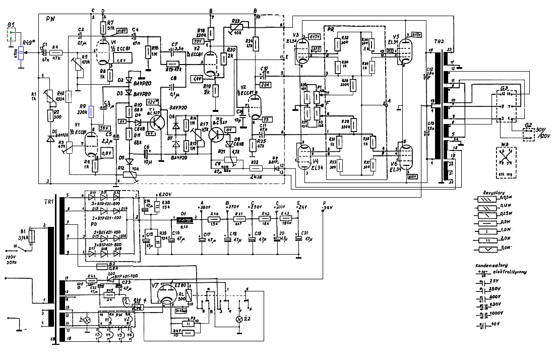

    Pltin74 wrote:
    fact, I had forgotten about that capacitor
    And that's why it's worth following how it was done 50 years ago and before.
    Circuit diagram of a tube amplifier with component labels and connections. .
    Electrical schematic of a classic tube amplifier with control elements. .
    Electronic schematic of the Eminent II T audio amplifier by Dynacord. .
    It could be simpler and better - two knobs, one for sources, the other for volume, of which the volume knob as a power switch, there are knobs with a contact. Elegant and functional.
  • Fixed phase inverter bias may drift with aging resistors
    #22 21518834
    kris8888
    Posts: 7088
    Help: 537
    Rate: 1930
    Pltin74 wrote:
    why? The phase inverter is working fine subsection 12.2.3.
    Ok, as I wrote, I didn't know the values of the components, so it was difficult for me to comment. If you have the values as in this figure 12.2 then ok, it will work. Although in my opinion it's a bit of a contrived circuit with this fixed phase inverter bias instead of the classic autobias. Quite risky due to the possibility of aging resistors and changes in the values of their large resistances in the fixed bias voltage divider. Then there is the issue of gradual tube wear in the phase inverter and such a rigid bias could eventually cause the tube to clog up for one half of the signal.
    Although the fact is that you will also hear such a thing in the first place in the form of distortion.
  • Hum likely caused by shared ground in multisection capacitor

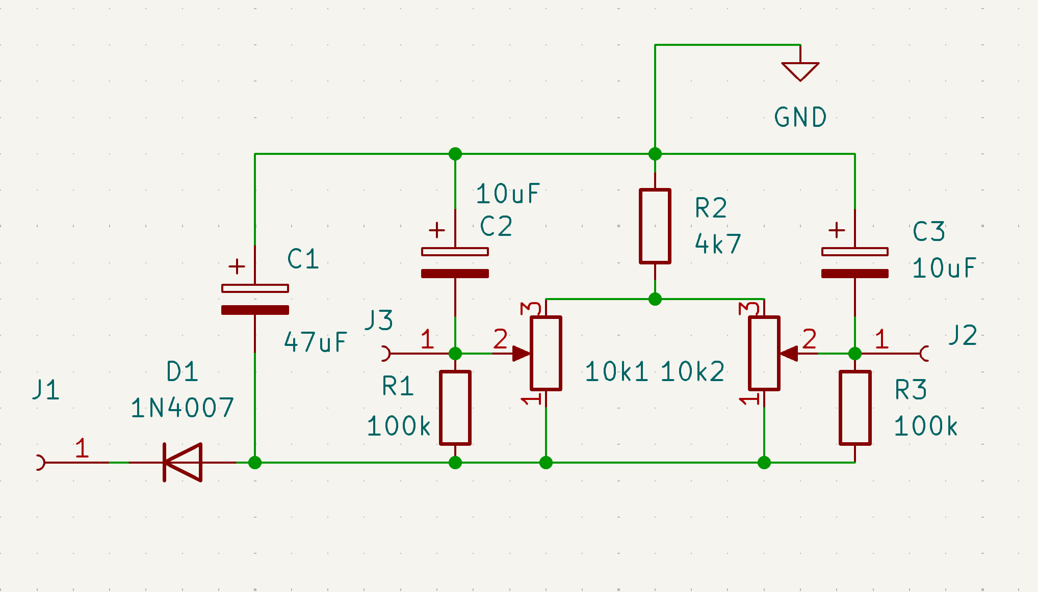

    #23 21519060
    Pltin74
    Posts: 143
    Rate: 132
    Rocky Horror wrote:
    And that's why it's worth looking at how it was done 50 years ago and before.
    yes, that's right. my oversight. i haven't done anything with the amp yet, but as for that hum it's rather the fault of the multisection capacitor, which "shares" the ground with the amp section on the pcb and then only goes to the star. that's rather where the problem lies.
    Rocky Horror wrote:
    It could be simpler and better - two knobs, one for sources, the other for volume, of which the volume knob as a mains switch, there are knobs with a contact. Elegant and functional.
    I personally like it, but thanks for the suggestions. The selector on the back does not get in the way ;) .

    Added after 3 [hours] 33 [minutes]:
    >>21518355 I have to admit my mistake and admit Kris8888 is right, because I added an unupdated schematic where the capacitors in the grid supply are not present, and in my project they are!!! I found a schematic of a pcb made in kicad and you can see that they are there and in the picture you can see them too (I need to go to the eye doctor :) . I have now made a fix with an additional capacitor having a person mass to the star and the touchdown has reduced! just as I thought it would. Unfortunately only reduced, but it is audible when you are very close to the speakers. this may be due to the fact that when working with silicon diodes there is better filtering than in the "gz34" mode, because before it hits the capacitor in the mosfet gate the voltage goes through a voltage divider (which is supposed to lower the voltage at the mosfet source to the voltage prevailing at the gz34 output when "working". I have no other idea :) .
    i add a picture of the grid 1 power supply
    A schematic of a power supply with capacitors and resistors, showing labeled component values. .
