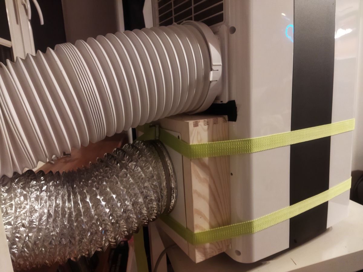

    #36 20147102
    Sp33di
    Posts: 27
    This year I got pissed off and made a decent adapter. Wooden box from the store with a wood 25x25 height 8 adapter for 150mm cable. The opening is slightly taped, on flat foam gaskets and tied together nicely with two straps at the back.
    Monoblock Air Conditioner Window Sealing: Creating Custom Adapter for Different Window Sizes
    The cooling efficiency has increased significantly and there is no negative pressure in the room, but it still pulls from the yard - this PVC rag is not good. Now the only thing left to do is deal with the openings in the window. Plexa 4mm to the size of 65x130 is 220. Too expensive, I will combine. Thermoblock 450 :D
