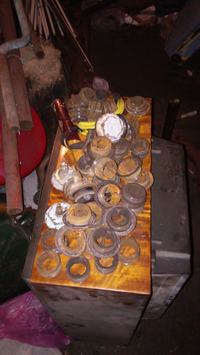

  • Cast iron radiator rib screw and removal method
    #42 14516312
    SnakeX
    Posts: 72
    Rate: 38
    Just for information, I wanted to add a photo of what a screw that connects two ribs looks like (I have not found such information anywhere on google, so maybe it will be useful to someone ...)
    Cast Iron Radiator Ribs Removal: Tools & Techniques for Old, Large Radiators
    For unscrewing, I use a majolka that fits perfectly as a "key" and I wind a wrench on the master + I put a 2-meter pipe on the wrench ... and somehow it even goes :) "
    The point is what a coupler that holds "two ribs" together looks like, this information may be useful for some ...
