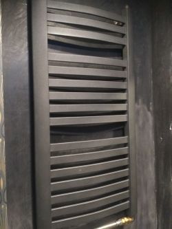

    I want to replace the cast iron bathroom with a ladder. I do not need to explain where my aspirations come from.

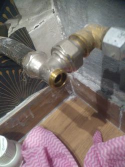

  • #14 18322940
    Maku3s
    Posts: 16
    Hello, I managed to replace this unfortunate radiator by freezing the pipes. The skilled person has installed a thermostatic valve from Comap and an angle shut-off valve on the return. The problem is that when I turn off both valves (to and from the radiator), even though the radiator gets cold, I can't drain the water for a moment to take it off and finish it before the wall. I don't know why the pressure is still there, even though several liters have passed. Please help
  • #15 18323298
    I suspect that you turn off the top valve only with the thermostatic head. If so, there are heads which, for the safety of the radiators, do not completely close the water flow. You need to turn off the inflow another way.
  • #16 18323650
    Maku3s
    Posts: 16
    But these are new inlet and return valves so how can they not have a complete flow stop?
  • #17 18323683
    ta_tar
    Posts: 6460
    Help: 695
    Rate: 2038
    And they can have frost protection. Are you sure they're closing all the way?

  • #18 18323830
    Maku3s
    Posts: 16
    I took off the thermostatic cap and even put a coin under it so that the spire was pressed down. The radiator cools down, even when I pressed the needles with a special screw plug.

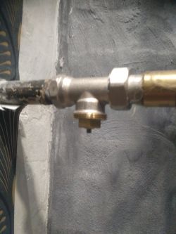

    Or maybe a naive question. How did you turn off the return valve. Show some pictures of both valves.
  • #20 18324555
    Maku3s
    Posts: 16
    On the lower valve, I screwed the hexagon socket all the way down, until it hides. So I turned clockwise like a normal screw. However, in the upper valve I put on a carpentry clamp even to push the needles inside as much as possible.

  • #24 18328850
    Maku3s
    Posts: 16
    Replacing Cast Iron Radiator in Top Floor Block: Thermostatic Valve & No-Drain Solutions Replacing Cast Iron Radiator in Top Floor Block: Thermostatic Valve & No-Drain Solutions Replacing Cast Iron Radiator in Top Floor Block: Thermostatic Valve & No-Drain Solutions

    nuszek
    Level 30  
    Posts: 1421
    Help: 123
    Rate: 388
    At the bottom it is screwed with an Allen key, at the top a nut / is usually added to the valve so red / so that the needle is pressed in.
    And if it continues to leak after that, the valves you bought are a crap.
  • #26 18329402
    ta_tar
    Posts: 6460
    Help: 695
    Rate: 2038
    Already the first note. The valve shown in the second photo is incorrectly fitted (downwards, downwards not recommended). The third photo shows nothing to us because we can't see anything. Try to drain the water again by unscrewing the flare nut on the return valve with the valve closed and with the upper valve closed. Maybe wait for some more water. Maybe the pressure goes down when you drain. Watch the water flow.
  • #27 18342957
    Maku3s
    Posts: 16
    Unfortunately, it is still not possible to get the trash. The water ran over the bucket and continued. The fan who froze my pipes is not going to come fix it.
