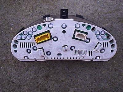

What is the pinout/diagram for the Peugeot 206 2000 instrument cluster to identify the signals for warning lights 7 and 17?
For a Peugeot 206 from 1999–2001 without multiplexing, the instrument cluster with two plugs uses the yellow connector: warning light 7 is on pin 5 and warning light 17 is on pin 12 [#8221179][#9405789] The rest of the wiring is shown in the diagram mentioned in the thread [#9405789] If the car is a full MUX version, there is no direct access to these controls because the instrument cluster is controlled over the VAN bus [#8229127]

    I am looking for a diagram of a counter with 2 cubes or pin numbers responsible for giving a signal to light indicators No. 7 and 17:

    Can you tell me whether they are controlled by +12V or -12V?
    I would like to use one of them to control whether the daytime running lights are on, because they are not used in my car, and the blinking vehicles coming from the opposite direction make me unsure whether the lights are working or whether drivers are not aware of the possibility of driving only with daytime running lights without turning them on. low beam headlights .

    This is a car from 2000, without mux and there is no daytime running light option. I found this description on the diagram, but this is what the low beam lights are called.
    When I wrote -12V, I meant mass, of course. Are both lights controlled by mass?

    I connected indicator number 7 to the daytime running lights relay and it works properly. Many thanks for your HELP.

    So in Peugeots 1999-2001 (without mux), the counter has 2 cubes, and the indicators:
    Indicator light 7 - pin 5 of the yellow connector,
    indicator light 17 - pin 12 of the yellow connector.
    The rest of the installation is shown in the attached diagram.
