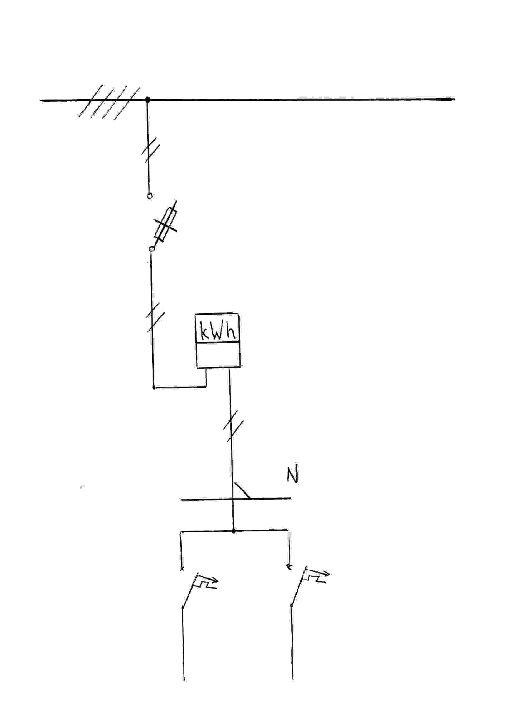

    Hello colleagues, I am asking for help in drawing a single-line diagram, as required by the energy company. Below I present a connection drawing from which a single-line diagram would be drawn.

    The only thing that comes to my mind buddy from this drawing is something like that.

    Rather, without this "bypass" at the fuse :)

    Without which workarounds ?? at the disconnector ?? can a colleague draw correctly ?? Do you need to put element descriptions? e.g. fuse "S" 20A ??

    Yes, add values.

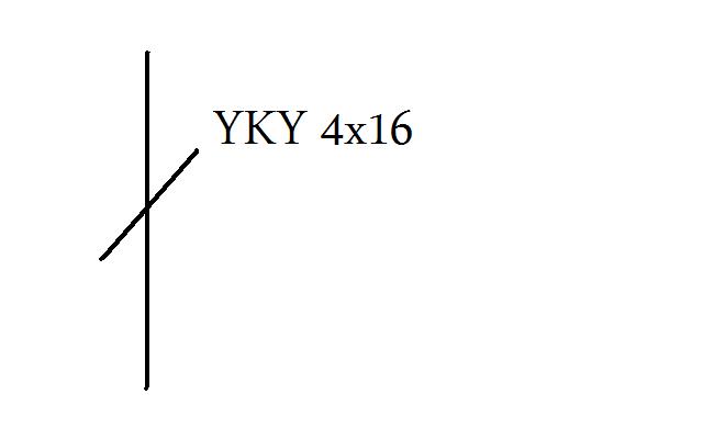

    One dash can be used and a description in the form of a digit corresponding to the number of wires in the cable, additionally the cable type, number of wires and wire cross-section must be indicated.
    The diagram itself must additionally have a description of the protection devices, type and value, it must also be the type of network it is and any markings of the network to which the connection is made.

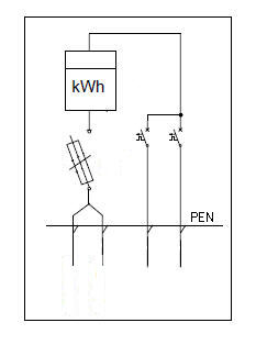

    I propose something like this at this point (create the appropriate values):
    Drawing a Single Line Diagram for Energy Company Connection Approval
    What about the protective or protective neutral conductor?
    What kind of network do you have, is it TT?
    How far is this connector from the powered building / buildings?
    As for the lines, I suggest you read this .

    So we have PEN on the power supply and now, depending on whether it is close to the building / buildings, we divide it into the ZKP or not.

    Well, not quite, my friend Remik_l, you drew a three-phase disconnector, and my colleague blumberg has a single-phase disconnector (at least this is how my colleague blumberg is shown in the drawing) :-) And not "N" but "PEN" ... Well, by the way.

    Now it should match the data provided by the author.
    However, I believe that this is not a correct solution to this problem, only a temporary one.
    Are these meters to be in garages, and circuit breakers to protect the circuits in them?
    If so, you should split the PEN cable and replace the installation in garages with a 3-wire one, because you will not get 10 mm?Cu for lighting / sockets. It would be even better if this aluminum cable was replaced with a 5-wire one.
    You should apply an RCD in the socket circuits.
