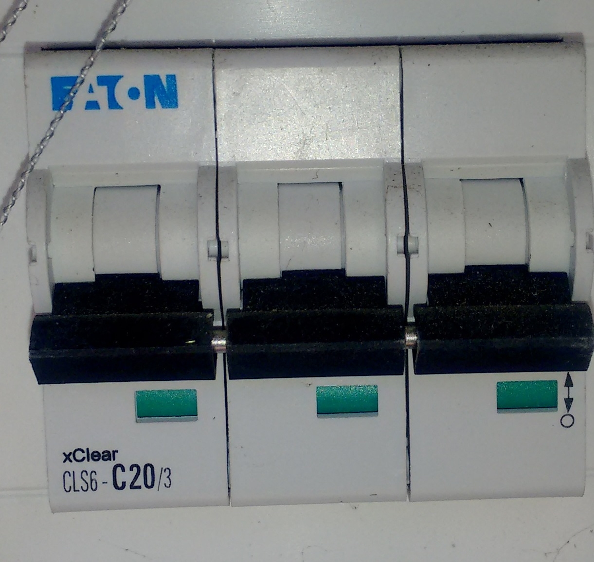

    pre-meter security:
    House switchgear overview drawing: Review & improve DIY electrical scribble (cross-sections)
    System of 0.4 kV TN-C power supply network operation
    From the meter to the switchboard at home 4 x10 mm2 (copper) - 36 m

    kemid wrote:
    pre-meter security
    Ask ZE to change the type of security.
    20A (in addition the installation switch with C character) will cause a problem of the lack of selectivity of the tripping of the protection.
    At the beginning I warn that such a drawing, in private, reads terribly.
    1. Why does the heat pump "hang" on the RCD?
    2. Why does the induction hob hang on the RCD?
    3. What sections are covered with the switchgear?
    4. Why lighting and garden sockets "hang" on one protection?
    5. What is the characteristics of residual current devices used in the installation?
    By the way, I suggest not to mention comparisons about digging in the ground, gardening, smoked meats and other unrelated to the topic.
    This is an electrical topic, and its solutions and implementation are also subject to Polish law. An electrician in Poland must show appropriate certificates and, if you want to design, also construction permits. And so far no colleague has asked about it yet. The comments of a colleague retrofood are absolutely justified, because the electrical installation is designed based on a wider range of information than just the appearance of the switchgear itself and the apparatus contained in it.
