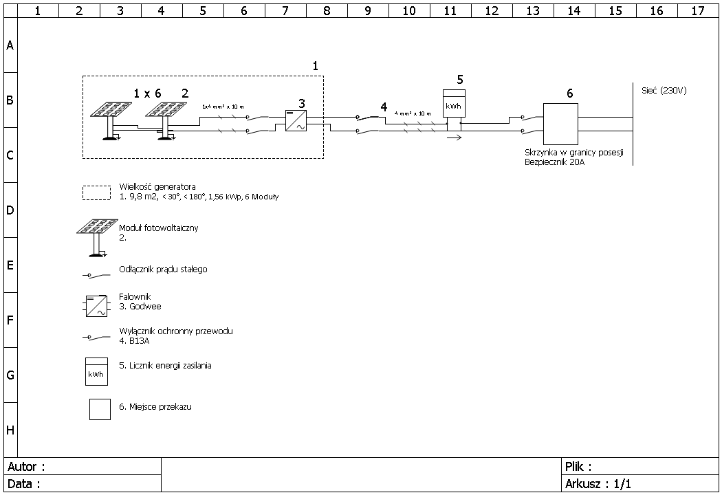

    Colleagues, check if I drew the pv installation diagram correctly that I want to report to ZE.

    At PGE, they require the RBK-00 switch disconnector in the box where the meter is located, between the meter and the inverter. A break should be visible for PGE. Write what kind of energy distributor you have.

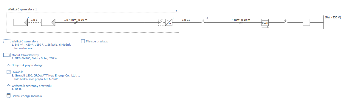

    I have Tauron and once an electrician made a diagram for me as in the attachment and they accepted it.

    Fold the papers should be OK, if they stick to something, you will add them on the spot, or you will get a request to complete the documents.

    I will be assembling the first diagram, I painted it myself in the free QElectroTech program

    Correct in the diagram you have a GoodWe inverter, not Godwee ;)
    And add its exact designation.
