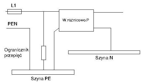

Can I install a class C surge arrester in a two-wire TN-C apartment switchboard behind the main 20 A fuse and RCD, after splitting PEN into N and PE?
Not in the way shown if the apartment side is still really a 2-wire TN-C installation; the decisive point is what system exists behind the switchboard, and PEN must not be separated and then reconnected to accessible conductive parts [#8285254][#8286025] If the installation is genuinely TN-C, the RCD is considered prohibited/harmful, and the forum advice was to place the PEN on the PE rail and not treat the whole installation as TN-CS just because the board was modernized [#8282943][#8285850] For surge protection, one reply states that the SPD should be installed before the RCD, only between L and PEN [#8285660] If the receiving installation has actually been converted to a proper 3-wire system (L, N, PE) and there are no hidden old 2-wire circuits/bridges, then the arrangement can be treated differently; otherwise, the repeated advice was to have a competent electrician verify it rather than guessing [#8285368][#8289377]

    Maybe a friend can do that. However, please note that one SPD will be short-circuited. It can be successfully eliminated.

    In addition, errors shown in the drawing should be marked and inaccuracies in the description explained.
    The PEN conductor should be placed on the PE rail.
    My colleague's description shows that the receiving installation is still in the form of a two-core one and the colleague only replaced the switchgear.
    If so, the use of an RCD is not only unnecessary, but also prohibited and harmful. And reconnection of once separated PE and N conductors is highly inadvisable.

    As for the harmfulness, opinions are divided on this issue buddy kkas12.
    A friend replaced the switchgear at home, from old fuses to overcurrent circuit breakers, single-phase installation. He used a differential circuit breaker with the N circuit disconnected last and connected first. The owners had a small child who put a nail into the socket on the left side [phase], before the kid was seriously hurt, the RCD reacted, which in the case of TN-C acted as a direct contact protection [current leakage from the phase conductor to earth]. The kid is still alive and well, but he got really scared... it's scary to think what would have happened if it hadn't been for the RCD. The kid would've been baked alive before he dropped a B10.
    I know that soon there will be voices that the PEN must not be interrupted, because the phenomena of induction and we deprive the connected devices of protection, this applies to inductive loads, accelerated motors, etc., which after disconnecting the power supply and remaining in motion can act as a generator ... in this case I 100% agree that the application will be harmful, because we will deprive the devices connected to it of any protection. When disconnecting the power supply through the RCD, we disconnect both circuits and nothing has the right to introduce a foreign potential to the housing, because the receiver becomes separated. And the nature of the load in an ordinary house is almost purely resistive.
    If the RCD is installed in a TN-C system, the following conditions must be met:
    - 200% certainty that this is the final receiving installation and by turning off the power [by interrupting the PEN], we turn off only the premises we use and no other, so as not to deprive someone of protection by breaking the PEN and leaving the power on L.
    - RCD with delayed switching off of the N circuit and earlier switching on.
    I omit the fact that the installation should already be made as a 3 or 5-wire, because these are the regulations now ...

    Krzysztof (kkas12) as always did not disappoint and noticed mistakes.
    Connecting the PEN from the power supply to the RCD and then to the PEN bus is unfortunately a common erroneous practice. Not to mention the old topic of RCD in TNC but you can see that there are those who, like colleague Miwhoo - see some things differently. If the installation is aluminum - it is worth considering replacing the wires with copper ones (3x). By the way - what does 200% certainty mean.

    If the installation in the apartment is made by a colleague as a 3-wire system (L, N, PE wires), then the drawing will be:
    Installation of Class C Surge Arrester Behind Main 20A Fuse in TN-C Standard Apartment Switchboard
    If there is TN-C in the apartment, then of course there will be no RCD.
    Anyway, I've already gone crazy - after all, my friend has this third wire or not.

    Recently I made a whole new switchboard I have installed a differential circuit breaker, 30mA, The installation is in the apartment in the TN-C standard, i.e. 2 wires , I made such a diagram, my installations are divided into N and PE, through a differential switch
    So the author modernized the switchgear - separating the neutral conductor into N and PE - but the remaining part (receiving) of the installation remained according to the old TN system standards with zeroing in the main role. In your opinion, is making a distribution in a modernized switchgear without a sufficient analysis of the receiving installation (circuits) in terms of the presence of zeroing (the author writes about the receiving installation in the TN-C standard) is the only criterion for installing a residual current device?
    have they heard about the installation of TN-CS?
    A very strange question. Especially if, in the described case of alleged TN-CS, there are old 2-wire circuits on the side of the receiving installation, where the electric shock protection is implemented by "zeroing". It is not enough to modernize the switchgear to assign the characteristics of the TN-CS system to the entire installation.

    The basic and very important question is in what system does the receiving installation work, i.e. behind the switchgear (in which the PEN division was made)?

    Hello!
    He just wrote what he did.
    He divided PEN into PE and N.
    PE starts and ends on the busbar in the switchgear.
    The neutral wire "went" into the installation.
    So we have L and N phase.
    So there is no question of a TN-C system.
    It is also not TT because there PE (it doesn't matter that only in the switching station) is not created as a result of PEN division).
    In addition, the N conductor in each system is a working conductor. Therefore, it cannot be connected to accessible conductive parts, and once separated from PE, it cannot be connected again, which will happen when it is connected to the housing of the receiver earthed by foundation.

    Of course, I do not think that all the receivers that the author has are made in protection class II and I do not think that he removed the bridges in the sockets and/or replaced them with non-protective ones.
    If this were the case, we would be dealing with a TN-S system, but (note) without the protective conductor.
    And so we have a hybrid, i.e. a corpse (two wires) resuscitated by force through the use of a residual current device, which in addition cannot even be named.

    After getting acquainted with the given topic, I came to the conclusion that my friend smith01 is probably looking for some naive Internet volunteer teacher who will devote knowledge and time - about three, five, or maybe more years, depending on mental resistance, but I don't think he will find one - unless of the same level of knowledge of electrical engineering as himself.
    Please do not overdo it and hire a competent electrician.
The discussion revolves around the installation of a Class C surge arrester in a TN-C standard apartment switchboard, specifically behind a main 20A fuse. The author seeks clarification on whether this setup is appropriate given their recent switchboard renovation, which includes a 30mA differential switch and a two-wire system. Responses highlight concerns regarding the use of residual current devices (RCDs) in TN-C systems, emphasizing that interrupting the PEN conductor can be hazardous. Some participants argue that while RCDs can provide protection, their use in this context is controversial and may not comply with safety standards. The conversation also touches on the importance of proper installation practices and the potential risks associated with incorrect wiring, particularly in relation to child safety and electrical shock protection.
