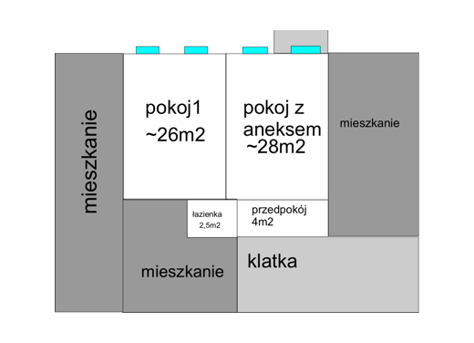

    I recently moved to my own apartment, 60 m2, tenement house, 1st floor, 3.75 m2 high. There is no gas in the apartment.
    At the moment, only a tiled storage stove in the bedroom is provided with heating - 3 sq.
    The power allocation is 12 kw, it is G12.
    What is the most sensible way to heat it?

    I would not decide to buy an electric boiler, as I wrote before - installation, radiators, etc. - too much work and costs, after all, you can do the same cheaper with accumulation furnaces,
    (2 2 kw accumulation furnaces - will amount to PLN 2,500).
    I do not think that 12 kw will be enough. There are only two rooms to be heated (a small bathroom radiator will be installed in the bathroom, there is nothing to heat the hall). But it is known that a reserve of power would be useful.
    the apartment is relatively warm, because it is almost surrounded
    all sides with apartments and a staircase - only one wall overlooks the street.
    But due to the height of the flat - 3.75 m, I have doubts whether "classic" stoves make sense, because I will heat the ceiling. Hence I wonder about infrared heaters.

    I am inclined to buy used, dynamic storage heaters, but I am just thinking about the powers.
    I thought to buy 2 pcs. For each room, each stove for 3 sq.
    It will cost me less than PLN 2,000. so there is no start to infrared heaters (about PLN 9,000 ...) or other types of heating at all.
    I'm just wondering - it would probably be better to buy 4 stoves, 2 kw each? For a better temperature distribution?
    I will not heat the hall, and the bathroom - here I have to buy a small radiator.

    - I will rather buy 2 pcs of 3 kW stoves - that is, a total of 6 kW for heating, because the differences in the prices of used stoves are not large, so I will save a lot by buying 2 stoves instead of 4. Only that THEORETICALLY it will not be enough (counting 140 w / m2)
    - I do not have a temperature of 23 degrees in my plan. The goal is to maintain the temperature of 18 degrees during the day and 16 degrees at night.

    Fortunately for me, only one wall is outside. this is what it looks like: (I could swing in the area of the rooms, but max 2m2 so it does not matter)
    Options for Electric Heating in a 60 m2, 1st Floor Tenement Apartment with 12 kW Power
    Coal / solid fuel stove - I realize that it would be the most economical, but I would rather not be able to do it from start to finish, and entrusting the work to a professional = extension of depreciation to 10 years.
    With stoves - I'm almost determined for these 3 sq m, but how to carry these 140 kg twice over 40 stairs? : /
