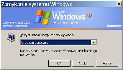

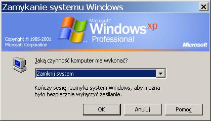

    c2h5oh
    Moderator
    Posts: 6669
    Help: 502
    Rate: 753
    Check that you have not switched with:
    Computer Automatically Turns On After Shutdown: ATX Akyga 550W, Asus P5KPL-AM, Win XP
    on:
    You often click on OK without reading what is in the window ...

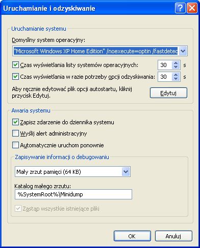

  • #16 8416175
    atomus2003
    Posts: 184
    Help: 19
    Rate: 35
    1) Right click on "My Computer"
    2) "Properties"
    3) "Advanced"
    4) In the "Startup and Recovery" field you click "Settings"
    5) You uncheck "Automatically restart".
    6) You approve 2 times approx.
    Then shut down the system and write if it displays "Blue Screen of Death".
    If so, look for the error code in uncle google.
  • #17 8416191
    rosolini
    Level 21  
    Posts: 392
    Help: 34
    Rate: 16
    In the system properties - tab: "Advanced" -> "Startup and recovery" click "Settings" and uncheck the box "Automatically restart".
    Then shut down the computer and see if there will be a "blue screen" with the error description?
    edit:
    sorry for the duplication - we wrote at the same time ;)
