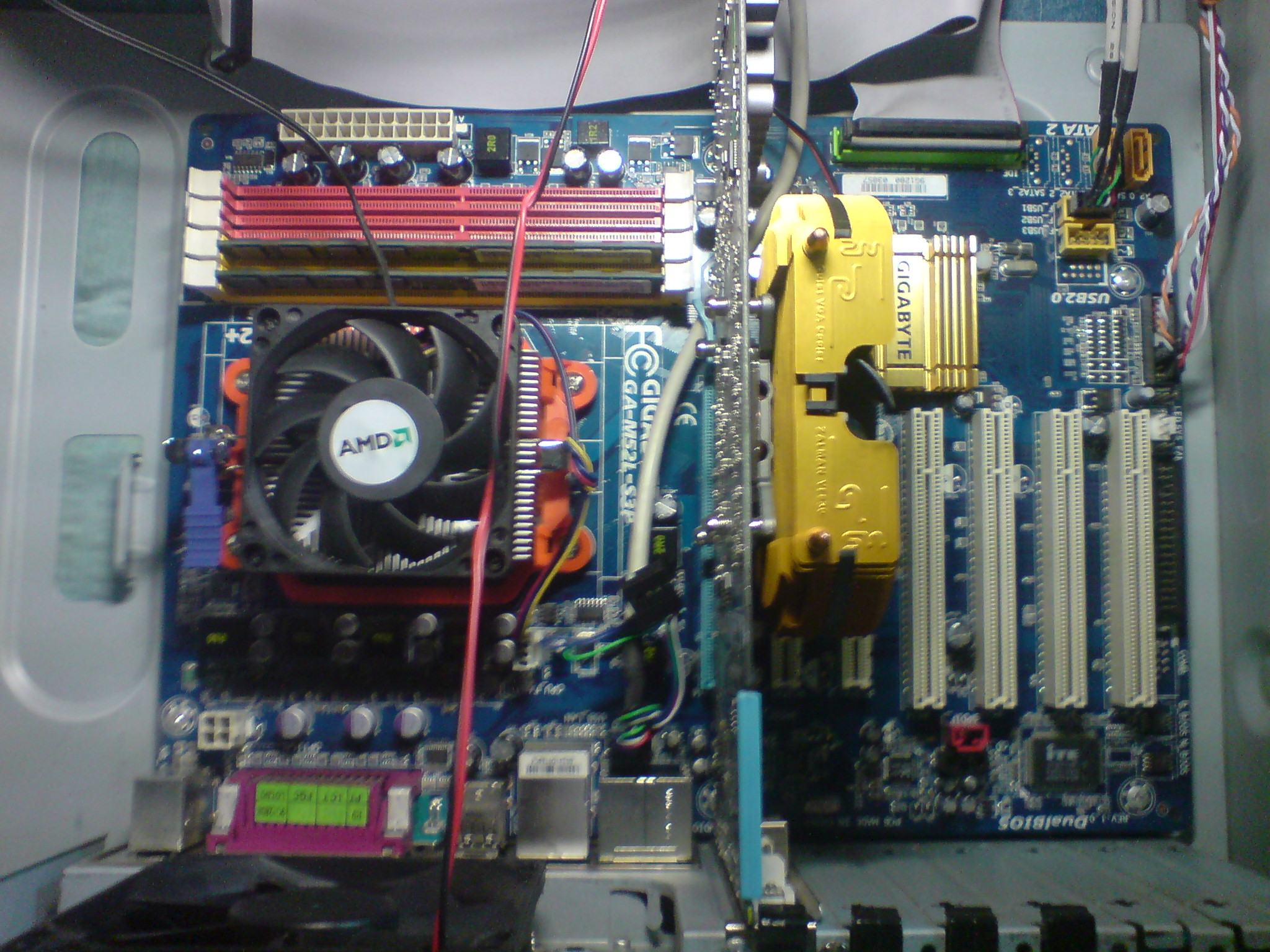

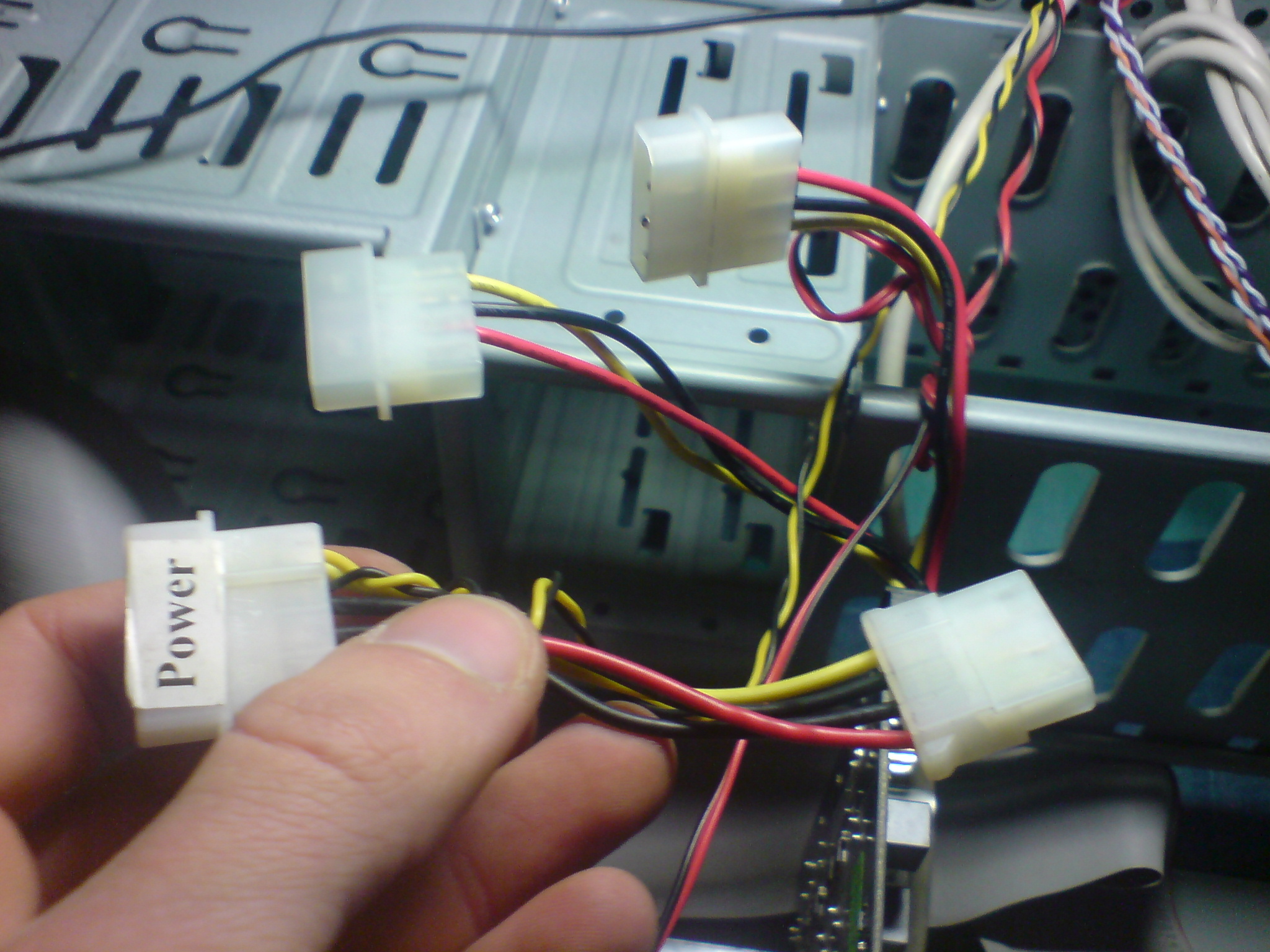

    ixi24
    Posts: 51
    Rate: 8
    Photo of the power supply (it is weaker, but it is working on this old computer)
    The computer turns itself off. What could be the reason? Is it a power supply?
    Photo of the motherboard without the power supply and disk
    And a photo of these power tips, because they were connected to each other with their counterparts from the power supply (two go from the graphics card) and do they have to be connected somehow or not?
  • #11 10544869
    Kasek21
    Posts: 45660
    Help: 4981
    Rate: 3547
    Both pseoduppers are only suitable for the basket.
