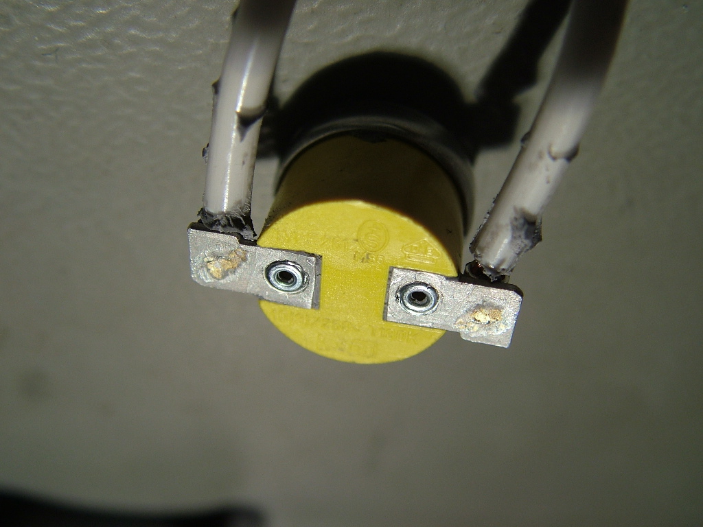

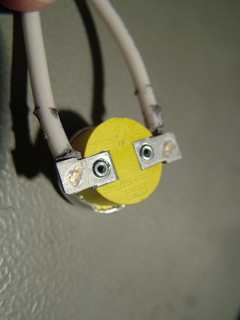

    Hello, the freezer does not defrost in a certain time. termpstat elth 261n does not contact and does not turn on the heaters. I need its data or replacement and where to buy one. What temperatures are there when defrosting the cooker (e.g. in other freezers)?
    Photo 1: external appearance, Photo 2 and 3 content of the thermostat:
    I am looking for a thermostat data or a replacement for ELTH 261N -20T80K I am looking for a thermostat data or a replacement for ELTH 261N -20T80K I am looking for a thermostat data or a replacement for ELTH 261N -20T80K
    The inscription on the inner klixon (removed from the housing): T130K

    Hello, I am not sure that I can use another thermostat, e.g. 261P. It would be good to have a technical description, but I did not find anything from ELTH. At what temperature does this thermostat switch, probably not at 130 ° C? Maybe someone knows to what temperature the evaporator heats up during defrosting?

    Hello, thank you for the advice. At what temperature does it switch off? 130 ° C?

    Can anyone describe at what temperatures the contacts of this thermostat work (in the defrosting system), probably not at 130, why so much in the freezer?

    The thermostat disconnects the contacts at +10 oC. There is also a 72 oC thermal fuse in this black casing (some have two). The 130K marking has nothing to do with the operating temperature, the temperature is coded in a three-digit number.
