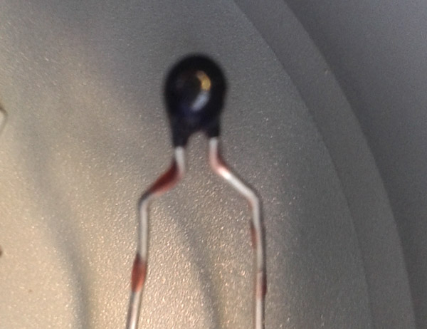

    I am looking for a specific thermistor. In my system, the thermistor strongly lies in the temperature (approx. 20%), and has no markings. From the documentation I only have its characteristics. What is the thermistor / model, markings, replacement? Size and manufacturer do not matter. The system will fit any suitable. Identifying Unmarked Thermistor: Characteristics, Model, Replacement Options

    This is an ntc thermistor, show what housing you have. Is the characteristic attached from the original one?

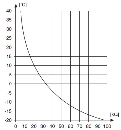

    Characteristics from this thermistor. Below photo of the original. Identifying Unmarked Thermistor: Characteristics, Model, Replacement Options

    Adamcyn wrote:
    Can you measure its resistance at exactly 25 ° C and possibly other temperatures and compare with the graph?
    That's what I did and at exactly known temperature, the actual value differed from that of the characteristics by 12K at 0 ° C.
    I will give you that the differences were different at other temperatures. You can draw a completely different characteristic in this way. At positive temperatures the difference was about 5K (20stC).
    The characteristics presented in the first post are appropriate for a functional thermistor. I think it will be a Thermistor MF52 10K F. It has very similar characteristics.
    Thanks for posts and help. I think the problem is solved.
