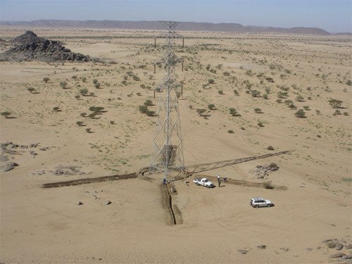

Why is a grounding electrode buried deep instead of being left as a bare wire above ground?
It is buried deep so the earth electrode has low, stable resistance and can actually do its job; shallow soil is affected by weather, drying, freezing, and other external conditions, while deeper soil is usually moister and less affected by frost [#8474614] [#8475587] [#8477354] The electrode also has to meet specific parameters and standards, so you cannot just use any bare wire and expect the measurements to pass [#8475568] In the thread, a galvanized steel flat bar/hoop is described as the normal choice because it meets the required cross-section and standards, for example 30×4 mm [#8475568] Copper itself does not “rot,” but the point is not just corrosion resistance; it is a standardized grounding electrode that stays effective in the ground [#8474125] [#8477277] In short, depth is mainly about reliable electrical performance and seasonal stability, not simply hiding a wire underground [#8474614] [#8475587]

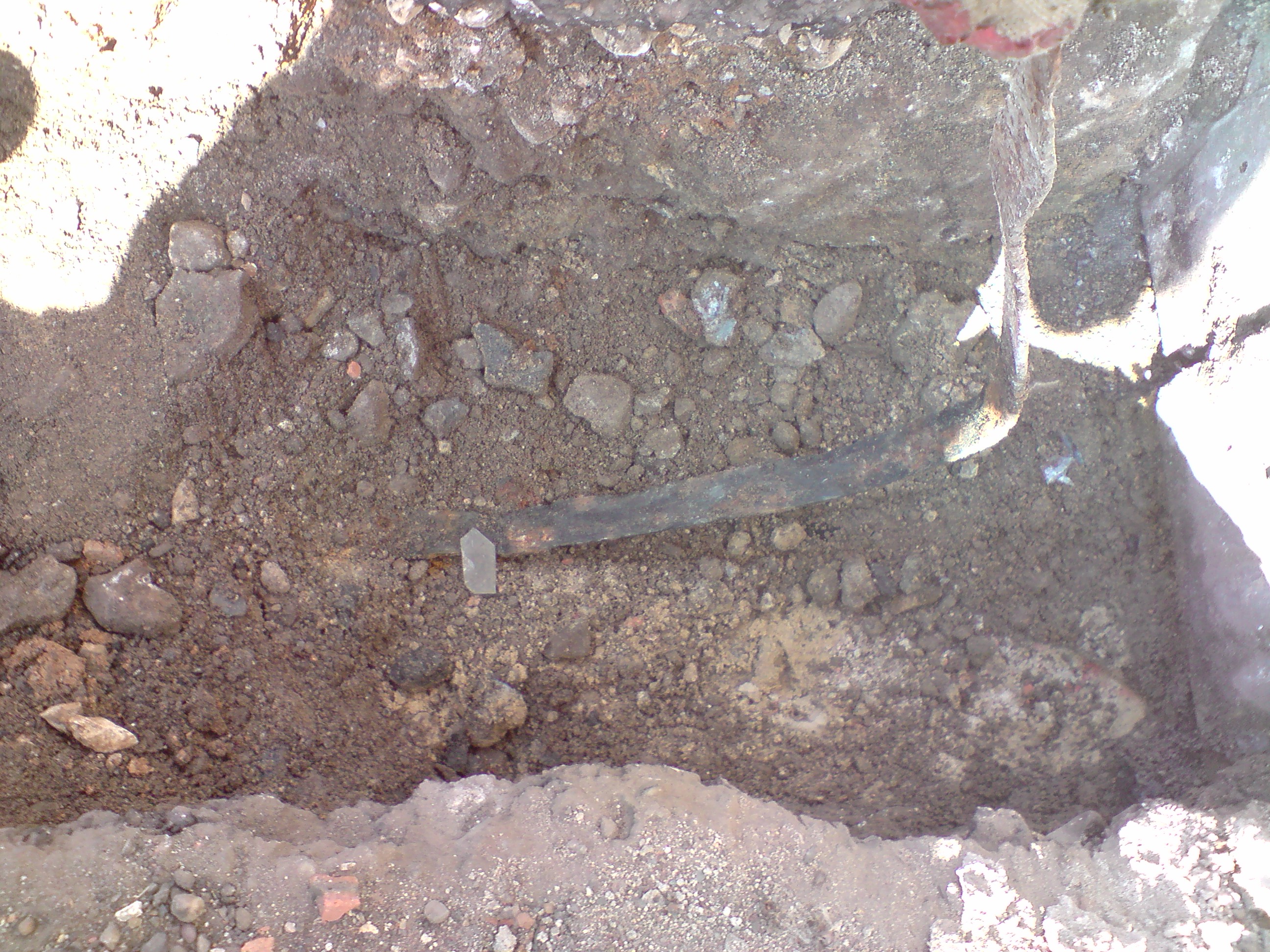

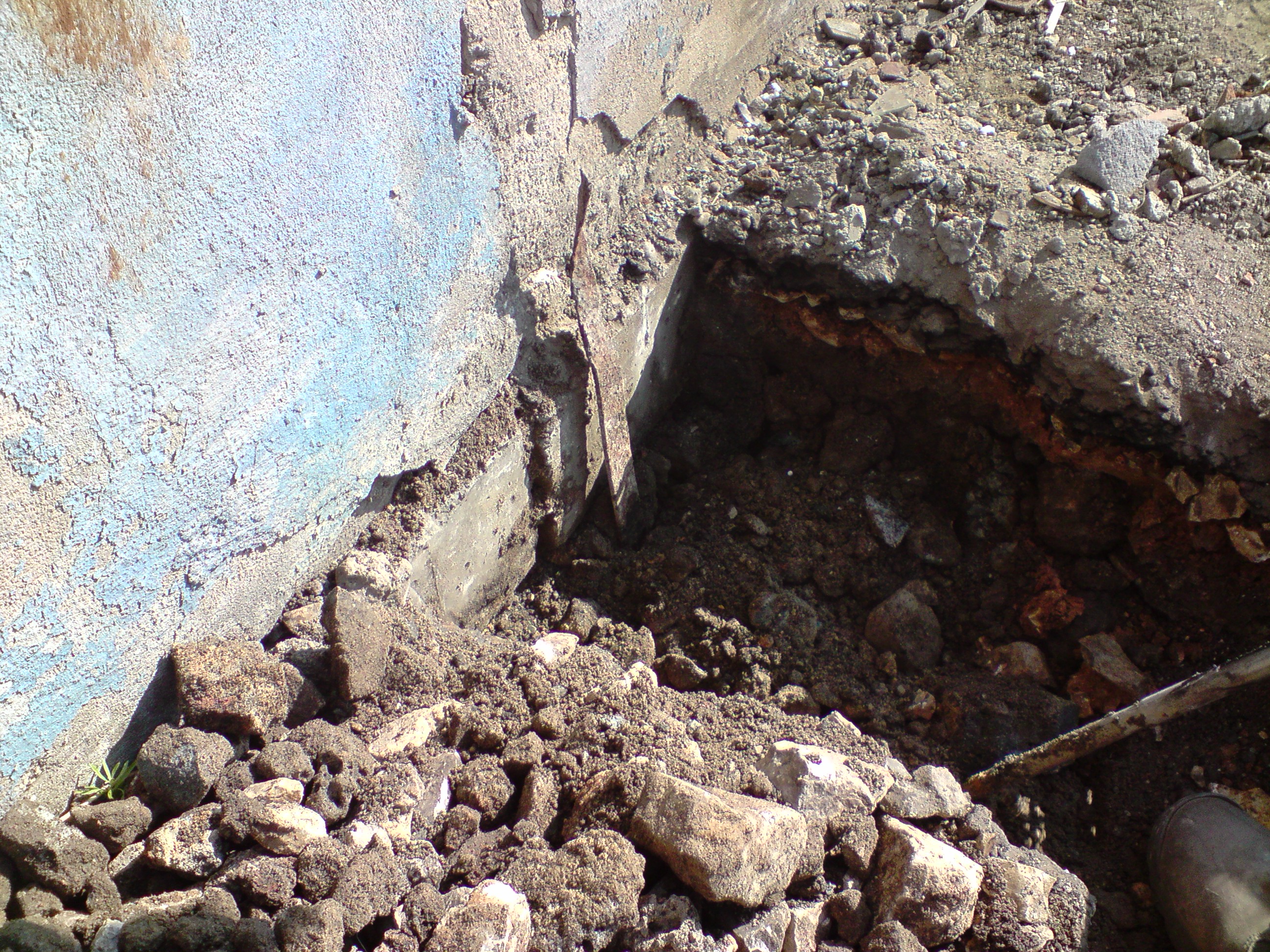

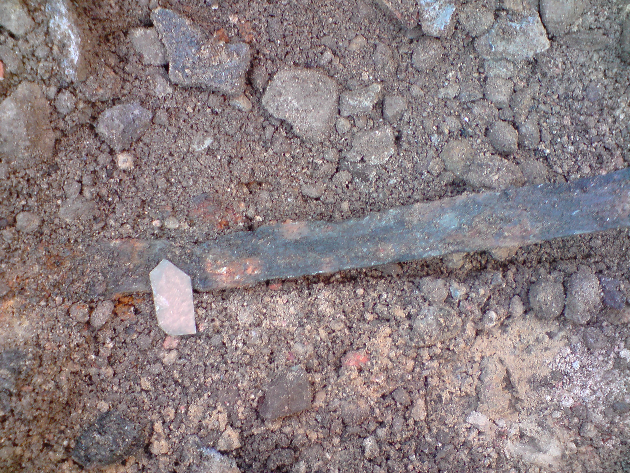

    The point is, my dear friend, that in the event of a threat (whether from lightning or damage to the insulation), there was no shock / damage / loss of life to both your person and bystanders in the place. The protection also includes devices and electrical installations that may be damaged - but this is a secondary matter in a life-threatening situation.
    I will give you an example like this:
    In a situation where, for example, your insulation is damaged and you can see a conductor (copper or aluminum), when the current flows through it, some of it may flow out of the conductor and be on a conductive material, e.g. a metal table - then the working person within it is exposed to electric shock.
    The characteristic of the current is that it does not like to be difficult and it flows on the best way, i.e. the way where the resistance is the lowest.
    In the above situation, if such an installation is equipped with a protective conductor (yellow-green), the current escaping from the conductor, located on this table, will flow through the protective conductor that is connected to the hoop. Then it will swim to the ground, killing two gates at the same time - a joke. On the way, an appropriate residual current device will work to cut off the voltage. However, in order for the current to flow to the ground, there must be appropriate protection parameters which include this earth electrode. In order for the parameters (resistance) of the earth electrode to be appropriate, the hoop also should be buried deep enough and measurements should be made on it. If the resistance is high (probably more than 10? - appropriate regulation / standard), the earth electrode is enlarged to maintain these parameters.
    If the earth electrode sucked, the current would be reluctant to flow to the ground and a person could be electrocuted.
    That is why the hoop must be buried so deep.
    As for the depth of the hoop in the ground - recently I did, the hoop was dug to a depth of about 1.2 m. Length of the hoop in the ground (vertically and horizontally) 4m. 130? resistance. Condition 10 ? not fulfilled. To this attached hoop iron pins were attached that went vertically to the ground (the total length of the pins is 4.5 m). In such an earth electrode, the resistance dropped to 4 ?, which was obviously confirmed by measurements.
    What mate? Now the contractor can sleep well without fear of being hit by something :)
    Here are some photos of the earth electrode that was dismantled and replaced with a new one - unfortunately I do not have photos on this lap:
    Why Is Copper Grounding Wire Buried Deep Instead of Left as Bare Wire Above Ground? Why Is Copper Grounding Wire Buried Deep Instead of Left as Bare Wire Above Ground? Why Is Copper Grounding Wire Buried Deep Instead of Left as Bare Wire Above Ground? Why Is Copper Grounding Wire Buried Deep Instead of Left as Bare Wire Above Ground? Why Is Copper Grounding Wire Buried Deep Instead of Left as Bare Wire Above Ground?
    And here is such a curiosity for you:
    Think a little, what will be better in the above situation: steel hoop or cable?

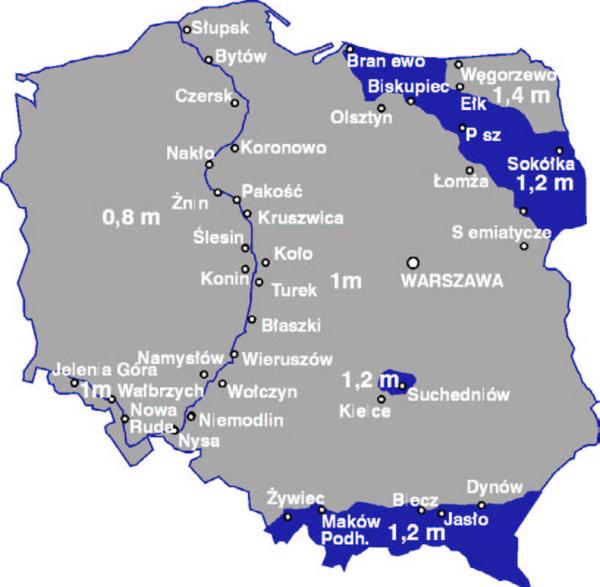

    It buries itself below the freezing point because objects that freeze with a layer of soil tend to "pop out of the ground" (such as shallowly buried corpses in crime movies ;) . After a few winters, such a cooperage could be shallowly underneath or lie on the ground.
    What is the level of freezing right now?

    Why the cooperage so deep ?? - Why the LV and HV cables so deep ??
    Besides, the deeper the soil, the lower the soil resistivity. And why a cooperage and not a cord? Because it is the cheapest, I cannot imagine using a copper wire with a cross section of 120mm.

    Arturo2005 wrote:
    What is the freezing level right now?
    Map

    Piotr Sz. wrote:
    Map
    According to my colleagues, all cables or hoops would be on top a long time ago ;)
