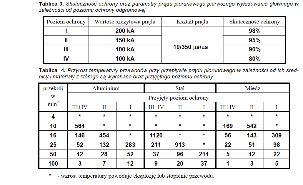

    It may not be complicated, but it's not entirely unexplored. The test was at 2 million volts and 200kA. As far as I know, 200kA ground discharges do not occur in Poland and even 100kA is a rarity. Hmm, 500 degrees already in the foundation earth electrode? Yes, if we discharge the lightning current with small cross-sections, let it be 2.5-4mm^2, there may even be an explosion / evaporation of copper, but after all, all air terminals and leads to the earthing are 50mm^2 for hot-dip galvanized or copper-plated steel wire. There is a table by Prof. Owls and his tests. I even pasted this table several times on the forum. With a wire diameter of 8mm, which is a standard today, and with a lightning current of 200kA, such a wire will heat up to a maximum of 211 degrees, and at 100kA, which is also rare in Poland, to only 37 degrees.
    Who is rich and can afford to buy fully copper or aluminum wire, the temperatures are very low in general.

    In fact, dynamic and wave phenomena can cause, for example, 90% of the lightning current to pass through concrete with a small area, causing the temperature in this place to increase to, for example, 500°C. In addition to thermal phenomena, there are also electrodynamic forces. It is these forces that pull the electrical wires out of the plaster. Much can be written about it.
    You can write, although scientists have long summarized their research:
    Lightning discharge currents have much higher values and are therefore able to break down electrically weak contacts between rebars, reducing their resistance. With low resistance and short flow times of lightning surge currents, thermal effects are not dangerous for foundations.
    It's from the link I already posted. So why should we write? You have a different opinion, like the supporters of the Smolensk birch, which jumped up with obvious consequences. This is not punishable, but it does not bring anything new, so let's end this idle exchange.
