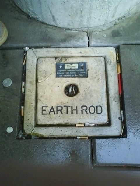

    A 3 or 6 foot long point earth electrode (approximately 1m or 2m) is embedded in front of the building, most often from the front. A can of a specific color is placed flush with the surface,
    Connecting Hammered Earth Electrode: Step-by-Step Guide for Rod Installation & GSU Connection
    to which the earth electrode and a copper wire 10mm2 (formerly) 16mm2 (today) enter from the bottom. The link, of course, has a known color. It is usually placed in a PVC pipe. The connected one is made with a loop clamp. On the other hand, protection against the influence of moisture is achieved by insulating the connection with DENSO tape or the entire box is filled with a special PIRELLI compound used for this purpose. The other end of the cable is put on the PE rail of the switching station. Due to the fact that all other installations, such as water, sewage, etc., are made of non-conductive materials, GSW is not generally performed here. This role is played by the PE busbar in the switching station.
    Of course, this is a solution used in single-family houses.
    In other facilities, the solution is similar, but the materials are different.
    In other words, dubious facade decorations in the form of allegedly necessary boxes, clamps, etc. are not needed at all.
    But not on the Vistula River.
