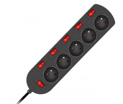

    Standards regulating the connection of wire colors to pins in molded plugs
    There are, for example, splitters that disconnect only one wire using their buttons (I know, it's crap), so if the phase in the socket is on the left, the button will disconnect the N wire, which may end badly.

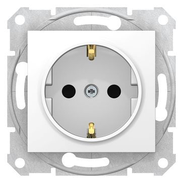

    The standard will not help much because there are grounded sockets without a pin (then the plug can be inserted in 2 positions).
    Schuko, of course, is standard in De and A, not in Pl.

    Phase connected to the device, despite apparent disconnection by a single-circuit switch:
    There are, for example, splitters that disconnect only one wire with their buttons (I know, it's crap), so if the phase in the socket is on the left, the button will disconnect the N wire, which may end badly.

    If you have such a strip connected to a double pin socket, you can choose a safer plug but the phase will be disconnected (a test tube/phazer is enough).
    I have one such cheap strip myself and I don't see much of a threat in it.
    Electricity should be approached with limited trust and even with a decent power strip, if we fiddle with the device, we pull the plug out of the power strip.
    Rather standard in most European countries, as well as Russia and Ukraine.

    Most manufacturers consider the use of fuses, and some also switches, relays on the "conventional" phase wire inside the device made in protection class I. If the LN is damaged/short-circuited, this is not a problem. In the event of a breakdown of the "conventional" N to PE, which is actually the phase potential, the protections inside the device will not be activated, but the protections in the electrical installation must be activated. As a result, for example, the tracks on the board burn, which makes the device unsuitable for repair due to extensive damage to the PCB.
    Some devices have fuses on both power cables - then they are marked as ~ and ~, not as L and N. Bipolar switches and bipolar relays should be used correctly.

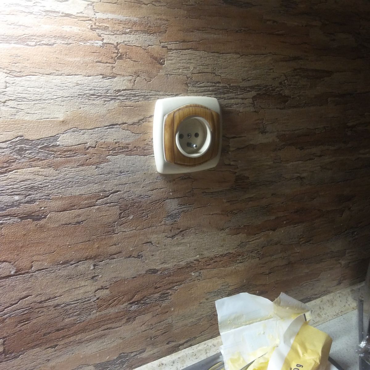

    William Bonawentura wrote:
    For unknown reasons, some installers have not modified their assembly rules and still choose to connect the phase to the left pin.
    Well, in my own kitchen I installed it in the style of the Polish People's Republic.
    Now you need to look for appropriate angle plugs with a connection cable on the same side as the socket for the PE pin. Unless you don't mind this kind of flair.
  • #28 19403172
    Mierzejewski46
    Level 37  
    Posts: 5077
    Help: 339
    Rate: 1057
    Board Language: polish
    The toaster cable is constantly connected there, there is butter under the socket, and this is its place, and the cable was always soaking in the butter, as it was directed downwards, I turned the socket around and now it sticks upwards, bypassing the butter. According to my wife, changing the position of the plate with butter was out of the question, so I changed the position of the socket. The art of compromise has been successful. My wife's happiness above all else.
  • #29 19403177
    zbich70
    Posts: 17116
    Help: 1164
    Rate: 6567
    But probably neither your wife nor you, nor the toaster, cares which side of the socket the phase is on?
    Before dismantling the socket, did you check where the phase was, then after turning off the circuit, did you check it again (on both contacts, in case you made a mistake earlier) and then started working?
