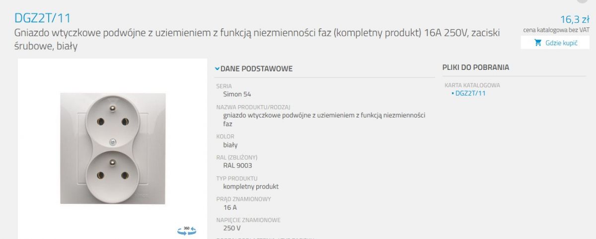

    As for double sockets, I only saw today that there are some with a phase-change function. For my part, I would like to add that I had a Siemens electric clothes dryer a long time ago where, when plugged in the other way round, it switched off with an error after 10 minutes. All I had to do was to turn the plug and it worked to the end without error and every time. With this error I still sold it and it still works this way today. Phase connection in the plug - which side to use when connecting the oven? .

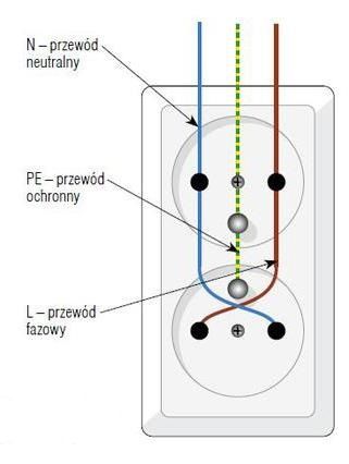

    It is possible to meet such sockets as in #13, and is it possible to meet such:

    ta_tar wrote:
    It is possible to meet such slots as in #13, and can you meet such:
    I have not encountered one and I doubt that such are produced because of this intersection
    This is the fantasy of one who did a translation of a European standard into Polish a long time ago and arose there with drawings of his own creation, instead of the original socket diagrams. He writes about it here:
    http://edwardmusial.info/pliki/jaka_wiedze_techniczna_rekomenduja_stow_elektr.pdf
    read from: page 12 point 4, but I recommend the whole thing, because there is more interesting stuff. As for the socket, I haven't come across one, but there are double sockets with polarity preserved, and both have a pin on top. In the top one, of course, you won't put an angled plug but a straight or europlug

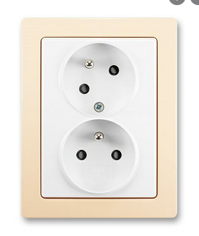

    #23 19631771
    jdubowski
    Tube devices specialist
    Posts: 21595
    Help: 2511
    Rate: 2804
    Tomasz Lew wrote:
    As for the socket, I have not met one, but there are double sockets with polarity preserved, and both have a pin on top. In the top one, of course, you won't put an angled plug but a straight or europlug
    In the Czech Republic it is firmly written in the regulations that the phase is on the left by the pin at the top, you can buy sockets like this at wholesalers:
    There is no problem with the angled plug in the top socket.

    #24 19632066
    Tomasz Lew
    Level 22  
    Posts: 336
    Help: 57
    Rate: 190
    jdubowski wrote:
    There is no problem with the angled plug in the upper socket.
    The Czech standard ČSN 33 2000 does not define the location of the phase in single-pole plug sockets, and earlier standards that recommended such a connection were withdrawn in the Czech Republic at a similar time and for the same reasons as in Poland - non-compliance with European standards. It is written on Czech forums that there is no obligation to connect the phase on the left side. Further discussion is pointless as everything has been explained for the Nth time.
    Besides, we are talking about Polish standards, and if one wanted to use typical configurations for this socket, the socket is French, not Czech, and it would be France, together with Belgium, that could have the right to determine the specific polarity. Attempts were made with the unischuko plug but ended in disagreement.
