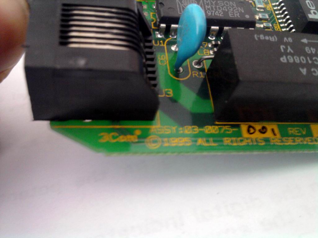

    Hello!
    I was browsing the Forum but somehow I didn't find the right topic.
    Is it possible to connect the LAN network using ONLY 2 wires of the cable?
    Basically I found the minimum must be 4 wires and connector pins 1, 2, 3 and 6 are used.
    But today I dismantled the plug from the old PCMCIA card, where I can see that ... only pins 3 and 6 are used for transmission on the RJ45 connector!
    The others are completely disconnected from anything!
    So what's it like in the end?
    And I am asking this because I wanted to "experimentally" connect the net to one room, where I have just released a 2-wire twisted pair and I do not care about some super speed of the connection (net from the outside is free anyway).

  • #7 8613902
    mkos1
    Level 30  
    Posts: 1822
    Help: 88
    Rate: 132
    The card is: EtherLink III, LAN PC Card for 10BASE-T and Coax, 3C589D-Combo
    And here are the photos of the plug:
    Minimum Cable Cores for RJ45 Plug: Can a LAN Network Function With 2 Wires?
    I would like to add that the free pins of the RJ45 connector are not even connected to each other.

    And there are no connections on the other side of the board?

    Rate: 328
    The tile is multi-layer and the rest of the tracks sit on a different layer

    Gentlemen - I checked it with a meter and I'm more than sure there are no more ANY connections there.
    Only pins 3 and 6 are used.
    The PCB is 3-layer and even visually there is nothing else there.
    Anyway, if some other pins of the connector were used, I would not ask this question.
    So .... how would that work?

    mah111 wrote:
    From what you can see in the picture, the connections are on pins 3 and 6, so it only transmits or only receives ... This is a strange thing, unless it only works in half duplex ...
    Hmmm - that might be a good line of reasoning. :)
    tos18 - there is no point in measuring more precisely now, because pins 3 and 6 go through the chokes to the connector, which we connect to the PCMCIA card itself
    Between pins 1 and 2 you have "infinity" of resistance because they do not connect either together or with anything else - I wrote about it before.
    I learned to use the meter a long time ago, so please do not say that "I must have measured something wrong".
    Please, here are some additional pics:

    I am so sorry to everyone - I think I need to see an ophthalmologist :cry: :oops:
    I was looking at the adapter of this card like "magpie on the bone" and ... I did not notice the two paths just going to pins 1 and 2. :(
    So I pay you back - you were actually right with those 4 veins. It's just a pity for your wasted time on it.
    So the topic is already explained.

    On the other side, in the lower part of the plate, you can see two tracks near the inscriptions.
  • #24 8617722
    mkos1
    Level 30  
    Posts: 1822
    Help: 88
    Rate: 132
    Samuraj wrote:
    On the other side, you can see two tracks near the inscriptions at the bottom of the plate.
    These two paths somehow "escaped" :(
