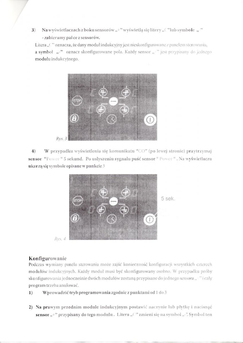

    Hello !
    Thank you for the programmation procedure sheet... but I'm French and I can't read Polish!
    It'a copy of a .pdf or .jpg document and Google can't translate the text...
    Is this document available in English or French?
    Thanks !
    André

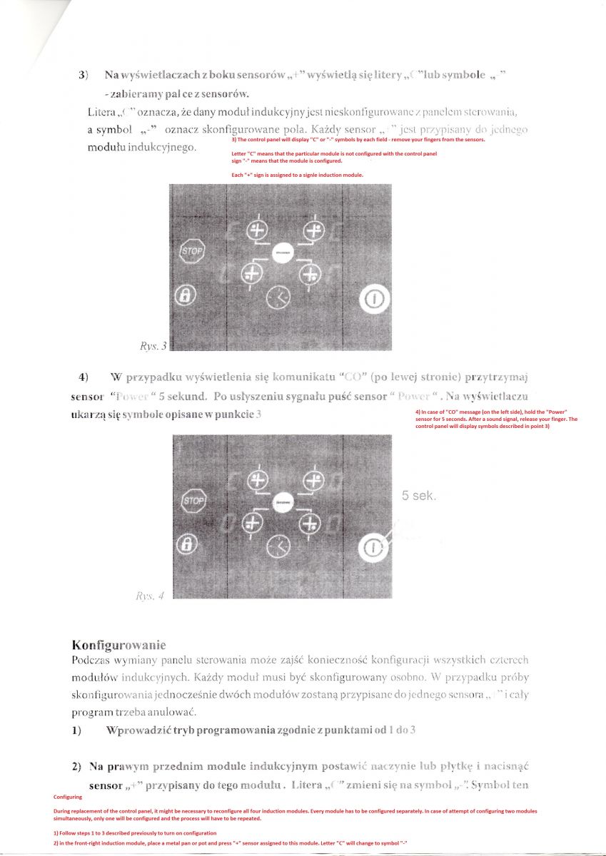

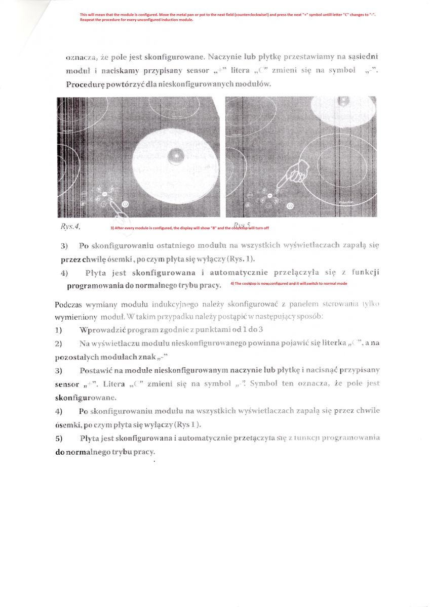

    Hey AndreVictor,
    Please find attached a short translation of the instruction
    TEKA GKST 60 I4 B Induction Cooktop: Understanding & Resolving Error E4 on One Field TEKA GKST 60 I4 B Induction Cooktop: Understanding & Resolving Error E4 on One Field TEKA GKST 60 I4 B Induction Cooktop: Understanding & Resolving Error E4 on One Field
    Important thing - it was mentioned in the thread that the instruction is a bit misleading, because you have to follow steps 1-4 before the cooktop will enter the programming mode (it says that you have to follow steps 1-3 which is not true).

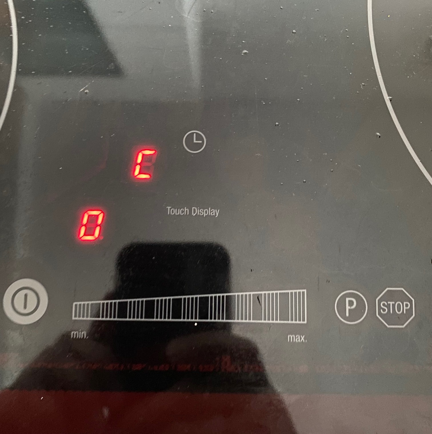

    I need help, I have a problem, I try to program the Teka board, on 2 burners (left side) upper "C" lower 0. I start to cook after some time on these fields (left side) error E4. I am transferring it to the other side after some time on all 4 burners there is an E4 error.

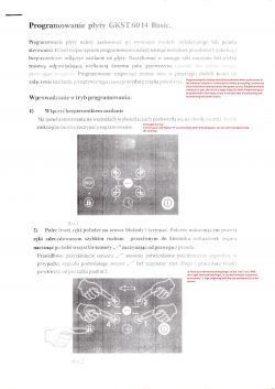

    PROGRAMMING:
    1. disconnect completely from the power supply for about 30 seconds - preferably via a fuse in the fuse box (or unplug)
    2. turn the power on (or plug in - without switching the board on)
    3. press and hold MINUS, while holding MINUS with the finger of one hand, with the finger of the other hand press PLUS, one by one, from the bottom right field (counterclockwise)
    4. the hob enters programming mode - continue following the TEKA instructions on field programming.
    This function is available for approx. 2 minutes after applying power!
