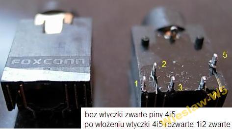

    My friend accidentally caught the cable connected from my tower to the laptop, which resulted in the mini jack breaking in half, with a smaller part stuck deep in the audio input of my laptop. Has anyone had this problem, or does anyone have an idea how to solve it?

    You won`t be able to push anything out from behind, and you won`t be able to pull it out with tweezers.
    It seems to me that the most reasonable solution will be to replace the socket.
    I also came across an answer in a similar thread in which the author (surprisingly effectively) used the method of a small nail (or something similar) + a drop of glue. Which doesn`t change the fact that in this case it was probably just a matter of luck.
    I`ll give it to you as well Link to the topic regarding replacing the socket (different laptop model, but the procedure is basically the same, I think)

    berials wrote:
    You can`t push anything out from behind,
    If it doesn`t come out... the headphone jack has a hole in the back.
