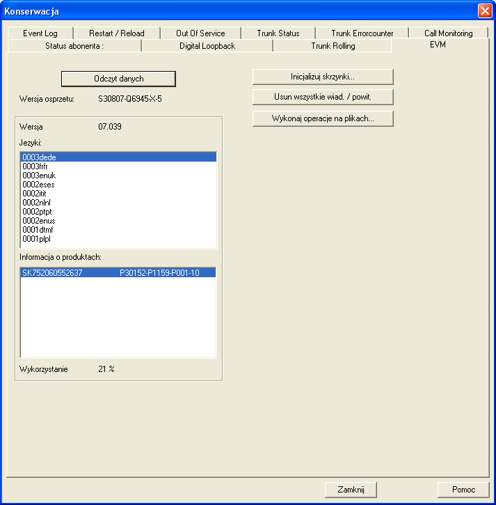

    I am standing in front of the next task.
    By some miracle, as a completely green one, I should apply a verbal announcement to the above-mentioned headquarters:
    "Welcome to the blablabla company, select 101 to connect with the president, select 102 to connect with the cleaner. Thank you for your attention"
    Does "this something" have such an option at all?

    Start the program to manage the control panel, select the maintenance in transmission (you must be connected to the headquarters not off kds) wait and search for the EVM tab first.
    Secondly, it is in the program itself after reading the data from the exchange, the connection tab and the bottom of the EVM.
    ps
    If the EVM tab does not appear in the maintenance, it means that your system does not have an announcement card and voicemail on board.
    Have fun :D

    In maintenance, she appears.
    Here's what appears at the beginning when I press "read data"

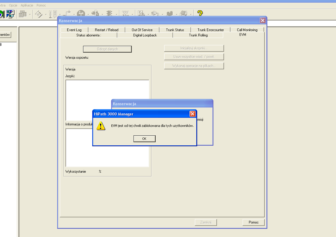

    And this is after the message
    Siemens HiPath 2030: Applying Verbal Announcement for Extensions 101 & 102 - Company Greeting

    And so it has to be that the card is installed ready to work only you have to program it properly.
    ps
    Send me your current config to me on priva or see my first "post".
    Greetings.
