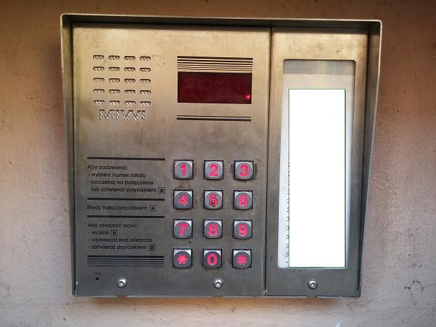

  • #5 15295173
    pawelek89
    this is what the cassette looks like
    Guide to Changing Individual Door Opening Code on Miwi Urmet Device

  • #6 15297824
    Ircys
    Intercoms specialist
    Posts: 6971
    Help: 1342
    Rate: 2085
    Unfortunately, the photo does not explain what system it is. Matibus SE or Basic can be placed in this cassette. Typically, there is the name of the system above the display or below the speaker.
    An additional question: is this the only cassette of your intercom system, or maybe one of many cassettes, e.g. at the gate and at other entrances, is also the same?

  • #9 15300438
    faradcik
    Posts: 192
    Help: 10
    Rate: 19
    To jest mats
  • #10 15300453
    sosarek
    Posts: 83875
    Help: 9320
    Rate: 15534
    faradcik wrote:
    This is matibus
    Which?

    faradcik wrote:
    This is matibus
    If so, Matibus SE. I think so too, but I'm curious
    how is your friend so sure that it's not Basic?
    Regards

    #13 15303745
    faradcik
    Posts: 192
    Help: 10
    Rate: 19
    Basic never had these bars above and below the display, there was no MIWI inscription, only BASIC.
    I suggest you call the source, phone no. 426162100 in the service department. The gentlemen will tell you what and how... I always do it because every post starts to turn into speculation and unnecessary writing that doesn't accomplish anything.
    If this is to be a forum of professionals for professionals, let's take care of its quality.

    pawelek89 wrote:
    As for the question of what happens after completing point 1, the screen shows ERR + a sound as if entering an incorrect code.
    Then you won't change the code yourself. To change it, you need to enter the system programming, and this should only be done by a service technician.
    Added after 18 [minutes]:
    So this is the Matibus SE system
    I think so too, that's why I took the liberty of correcting your error in identifying the system, because every professional knows well that the similar-sounding name Matibus is an archival Italian system, completely different from the Polish Matibus SE, and this can already be seen with the naked eye by the appearance of the cassette: http: //tinyurl.com/htoq76o

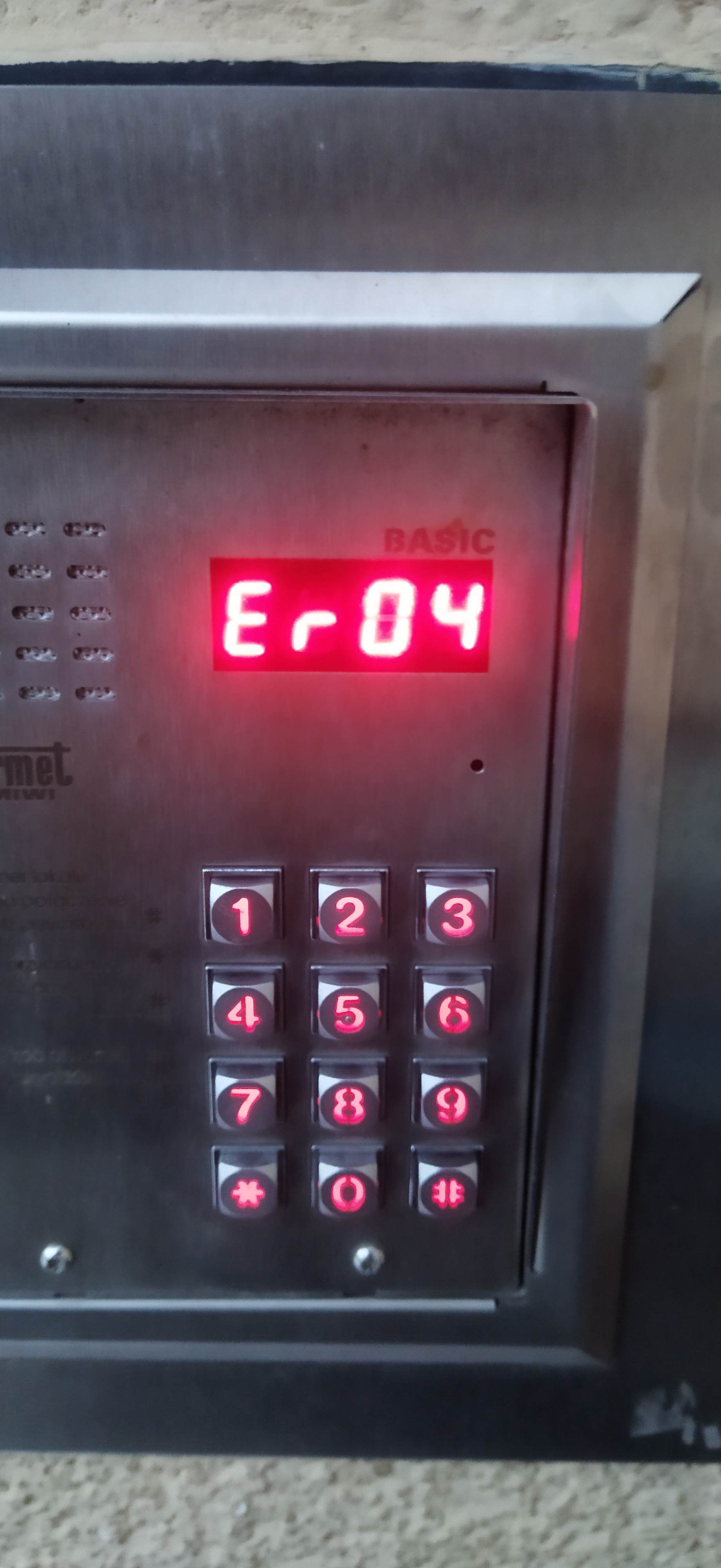

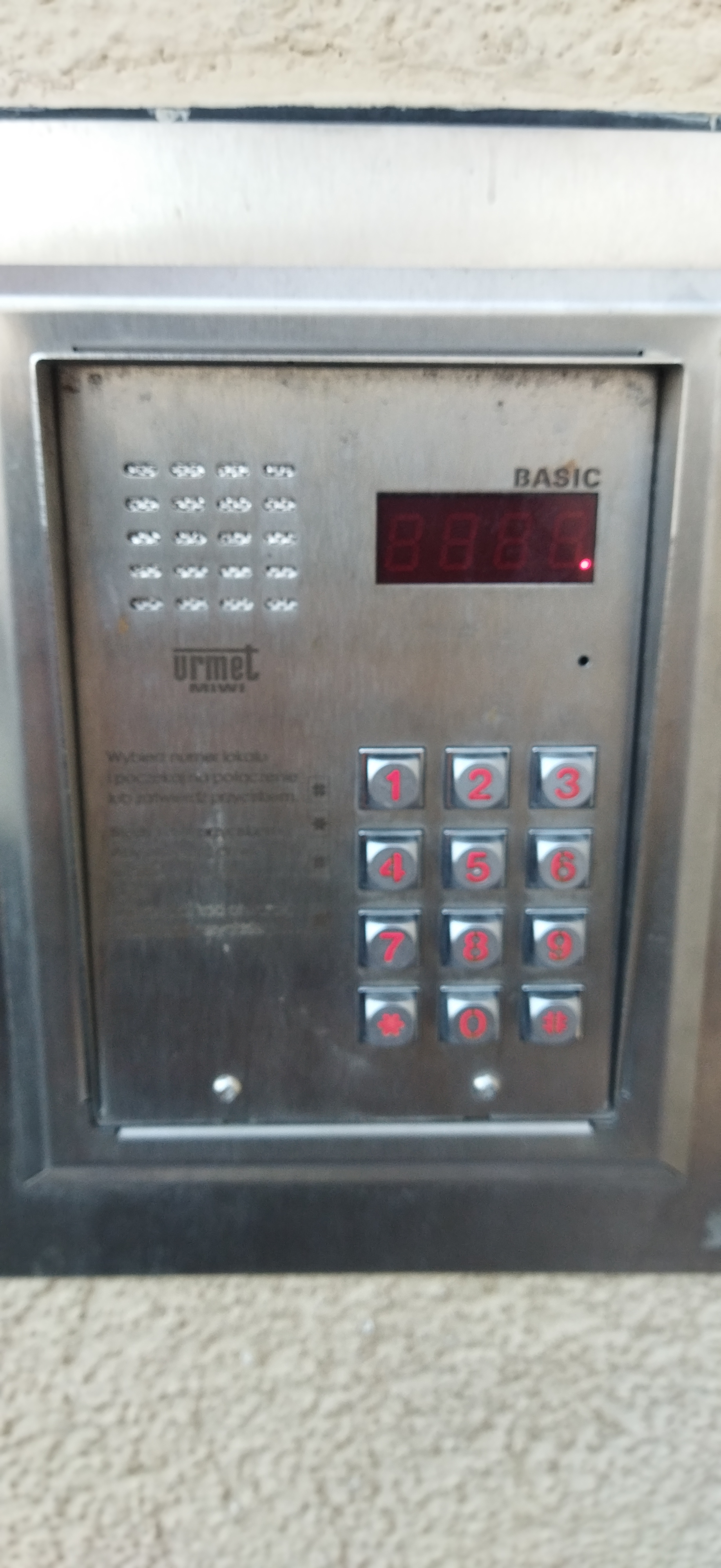

    #16 19270103
    olekolo
    Posts: 13
    Rate: 9
    Hello. Save. I have Miwi Basic.
    I bought an apartment, there was an inconvenient code. #38992#
    This is apartment no. 3
    I did it according to the instructions. I entered the pu5 menu
    I chose the new code 333 and confirmed #
    The intercom accepted. Now the new code doesn't work, I go and enter #333#
    Neither man. What did I do wrong?
    I also tried to enter the service menu, but the universal code 21082004 does not work
    • Guide to Changing Individual Door Opening Code on Miwi Urmet Device IMG_20210220_153807.jpg (2.35 MB) You must be logged in to download this attachment.
  • #17 19270306
    Ircys
    Posts: 6971
    Help: 1342
    Rate: 2085
    What message does the control panel give after entering #38992#?
    Regards
  • #18 19270385
    olekolo
    Posts: 13
    Rate: 9
    Er04 pops up
    • Guide to Changing Individual Door Opening Code on Miwi Urmet Device IMG_20210220_172502.jpg (2.67 MB) You must be logged in to download this attachment.
  • #19 19270401
    Ircys
    Posts: 6971
    Help: 1342
    Rate: 2085
    olekolo wrote:
    Er04 pops up
    Are you sure you end by typing #?
  • #20 19270420
    olekolo
    Posts: 13
    Rate: 9
    Yes Yes. Enter #38992#
    #21 19270430
    Ircys
    Posts: 6971
    Help: 1342
    Rate: 2085
    Try this:
    #30333# or #33330#
  • #22 19270544
    olekolo
    Posts: 13
    Rate: 9
    You are great . 30333 worked. I understand that I made a mistake by entering the 3-digit code and it got zero. Many thanks again
