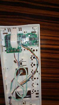

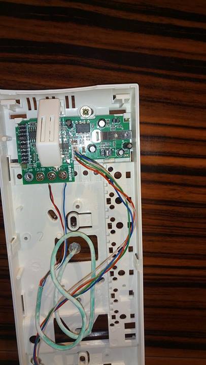

    I want to change the intercom in the apartment.

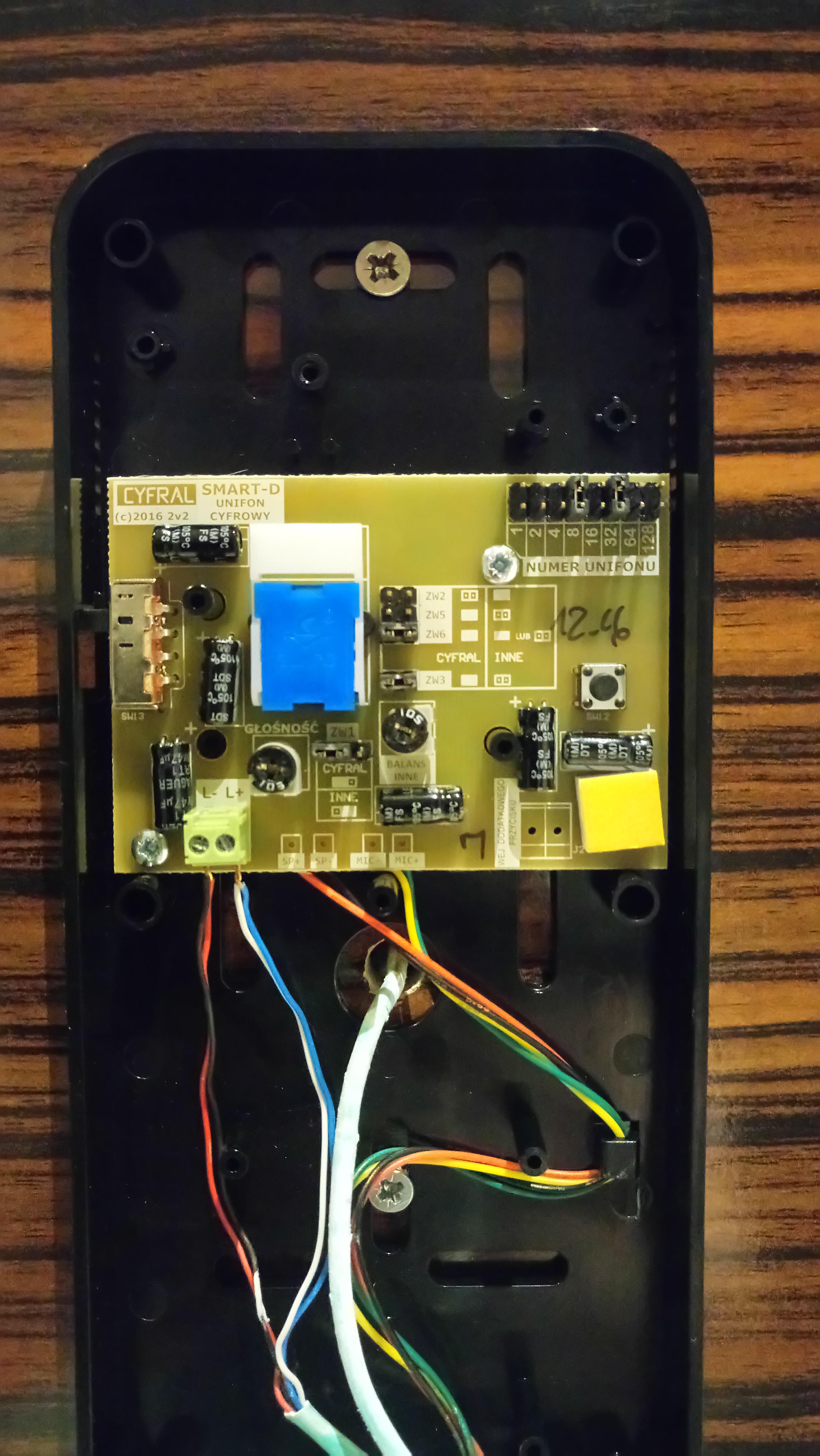

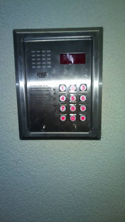

    I have a problem with the new Cyfral Smart-D intercom, I connected (+ and -) according to the old intercom (MIWI 1132/620) in total, only the call works, the intercom rings, but unfortunately nothing can be heard in the handset, and also the opening does not work on the other side door. I dug through the forum, found a few topics, started combining with jumpers, but nothing changes, OFF pops up at the bottom of the panel.
    Can anyone know how to set these jumpers?
    new Digital Intercom Smart-D

    The jumpers must be set to the apartment number.
    Example flat No. 23. You must put jumpers on pins 16, 4, 2 and 1.
    Example flat No. 32. You only have to put one jumper on pins 32.
    You just add up these numbers. The minimum apartment number is 1 and the maximum apartment number is 255.
    In the photo you have set apartment number 40 (i.e. 32 + 8).
    The pictures also show that you changed the poles in the installation. On the plus terminal in the old one were twisted red and black cables, and on the minus terminal - white and blue ones. In the new one you have the opposite. Swap them, then.
    I think you gave the same, red with black on the left and you did not pay attention to what is written on the terminals. L + and L- are different in both uniphones.

    The rule is that we use uniphones from the same manufacturer as the Head Office. since the exchange is Urmet, the uniphone should also be Urmet, not Cyfral. The Digital Smar-D uniphone is very capricious in cooperation with other systems, and even more so with Basic, which works properly only with Urmet uniphones. With other uniphones there is always some, often small, but there is a problem.
    Try to practice with the jumper settings: ZW1 - to the right, ZW2 - on, ZW3 - off, ZW5 - off, ZW6 - on / off, but if something is still wrong, then leave to apologize with Urmet.
    The matching uniphones are: 1131/620, 1132/620, 1134/622, 1140/622 and 1140/622-b. Why are you replacing your old uniphone?

    After all, the author has swapped the plus cables with the minus. He did the same, i.e. on the left he gave the same cable and uniphones have just the opposite clamps, which can be seen in the pictures.
