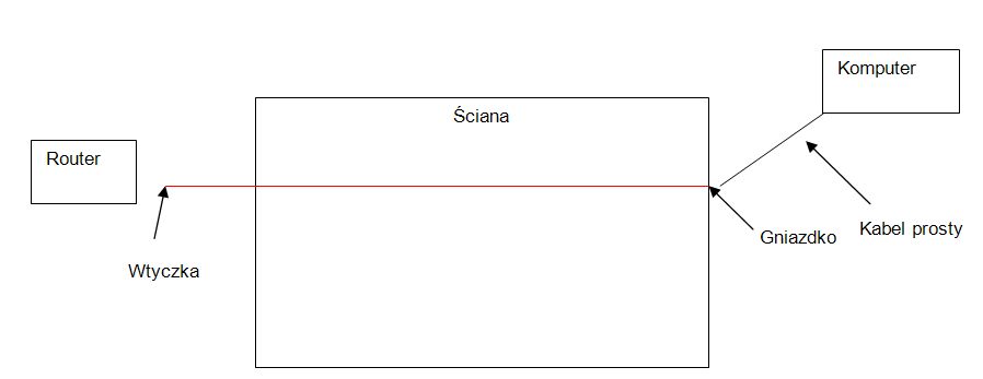

    I have a trivial problem which, however, I cannot overcome.
    In what order (colors) to connect the cables in the plug and socket at the ends of the red cable (diagram below)
    Connecting RJ45 Cat5e Keystone Jack: Proper Order of Colors for Socket and Plug Ends
    I struggled with it all evening yesterday: /
    I have the following marking on the plug:
    http://www.global-b2b-network.com/direct/dbimage/50254880/RJ45_Cat5e_Keystone_Jack.jpg
    At both ends I connected according to the scheme "B"
    When I connected the socket to the tester via a straight cable, all the LEDs were lit in turn, except for the "3" (which was not lit at all) - is that 1 pair of cables is damaged?
    At the end of the cable the LEDs were lit in a different order (of course "3" did not light up either)
    Later I tested by pulling more cables from the socket - then the LED responsible for this pin did not light up,
    but when I pulled out one of them then the tester did not show any diodes - is it supposed to be?

    #6 14359500
    przeqpiciel
    Posts: 2499
    Help: 285
    Rate: 238
    bz3tower wrote:
    I assume that pin 1 in both the plug and the socket is on the left side when looking from the front when arranging the plug and socket, so that the fastening clip is at the top.
    You may have made the wrong assumptions. Check out this photo With the arrangement like the ends of the blue cable, pin 1 is on the left pin 8 is on the right.
    And then it is as written above. On both sides of the wall you earn in one standard - with you "B" and years.
    #7 14359529
    jprzedworski
    Posts: 5373
    Help: 758
    Rate: 828
    The matter is simple in the sockets. There are three rows of description: one labeled A, the other B, and the third contains the pin numbers in the socket - the actual pin numbers, because the order of the wires is different than the order of the pins , there are "interleavings" made in the socket. The same standard A or B should be chosen on both sides and appropriate colors (there is clearly this color at each position) should be pressed into the socket.
    If A, it will be from left to right: blue (4), white-blue (5), green (2), white-green (1), orange (6), white-orange (3), brown (8) , white-brown (7).
    If B, from left: blue (4), white-blue (5), orange (2), white-orange (1), green (6), white-green (3), brown (8), white-brown (7).
    Then OK comes out according to the pin numbers. And he already gave you the cable kick959
    Whether A or B - it doesn't matter as long as both ends are the same.

    #9 14359558
    yogi009
    Posts: 14697
    Help: 848
    Rate: 2655
    Exactly. Do it in [B].

  • #13 14369153
    bz3tower
    Posts: 45
    Rate: 26
    It works! - thanks for the help
