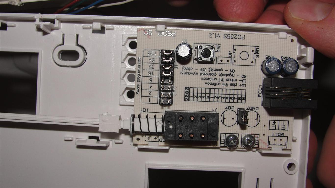

    Hello, I have a problem, I would like to connect the same uniphone in the apartment again, only the connection diagram got lost somewhere and I struggled with it for about 2 hours until I gave up but I came to some conclusions. But in turn, the wires are colored: White, Green, Blue, Red.
    When connected in configuration:
    Red, green, white, blue - the bell is working I heard my friend downstairs at the entrance to the cage but he didn't hear me
    Red, green, blue, white - the bell is ok but I can't hear my friend and he hears me downstairs.
    Red, blue, green, white - the bell does not work, but you can talk both ways
    What this is about ??? maybe someone has any idea i tried bridging and other combinations but nothing got me to a good layout.

    witekkij wrote:
    I have exactly the same problem,
    I attach a photo from the old intercom and the new one
    The old uniphone is a typical analog one, and the new one is a digital one. One will not replace the other.
    gorylla wrote:
    I would like to connect the same uniphone in the apartment again, only the connection diagram is lost somewhere
    You did not give the type of uniphone, but never mind. As you have noticed yourself, different combinations behave differently. If you had "rehearsed" all of them (there are 16 of them), you would certainly have hit the right one. Let me just say that the most important thing is mass. It must be attached properly. The rest comes out on their own. With an incorrectly connected ground, this is exactly what happens with you.
    As for bridging, you must not connect any of these 4 cables together. Bridges (if needed) are made in the uniphone. Usually it is one or two, but this is already prepared by the manufacturer. It is not known what you have for a uniphone, because you made a big secret of it.

    Can anyone tell what function the individual cables perform in my old uniphone? ie where is the mass, calling, earpiece, microphone?
  • #11 9134183
    karl102
    Level 28  
    Posts: 867
    Help: 106
    Rate: 265
    1 handset
    CA call
    2 microphone
    6 mass

    I bought a TK6 uniphone. but it does not go to connect it ... someone will tell you why the door does not open?
    4-wire Intercom Block: Correct Wiring for Uniphone with Red, Green, Blue, White Wires
  • #13 9244139
    karl102
    Level 28  
    Posts: 867
    Help: 106
    Rate: 265
    The bolt opening system, probably not seen any more.
    No resistor between 1 and 6.
    You have to remove the right jumper.

    Nobody will tell you which cable is responsible for what based on the photo, which shows only the cable sticking out of the wall. Another option is to go to the neighbor and take a picture of his connection or write down the colors and numbers of terminals, and of course the name of the uniphone. Then, according to the available table of substitutes, it will be possible to determine the correct connection.
  • #30 17069086
    Michnik14
    Previously, a standard white intercom was connected, two white and blue cables were connected
