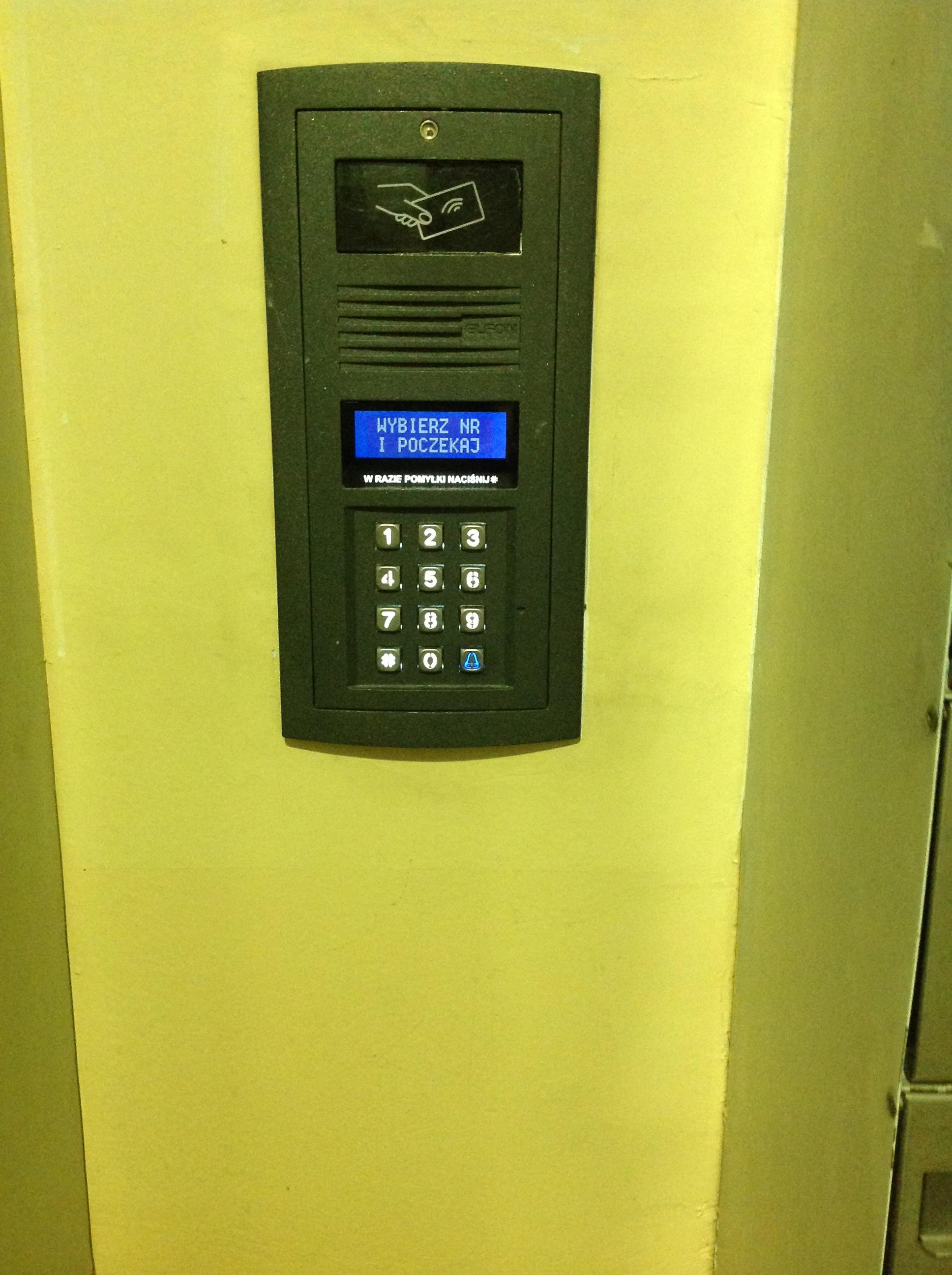

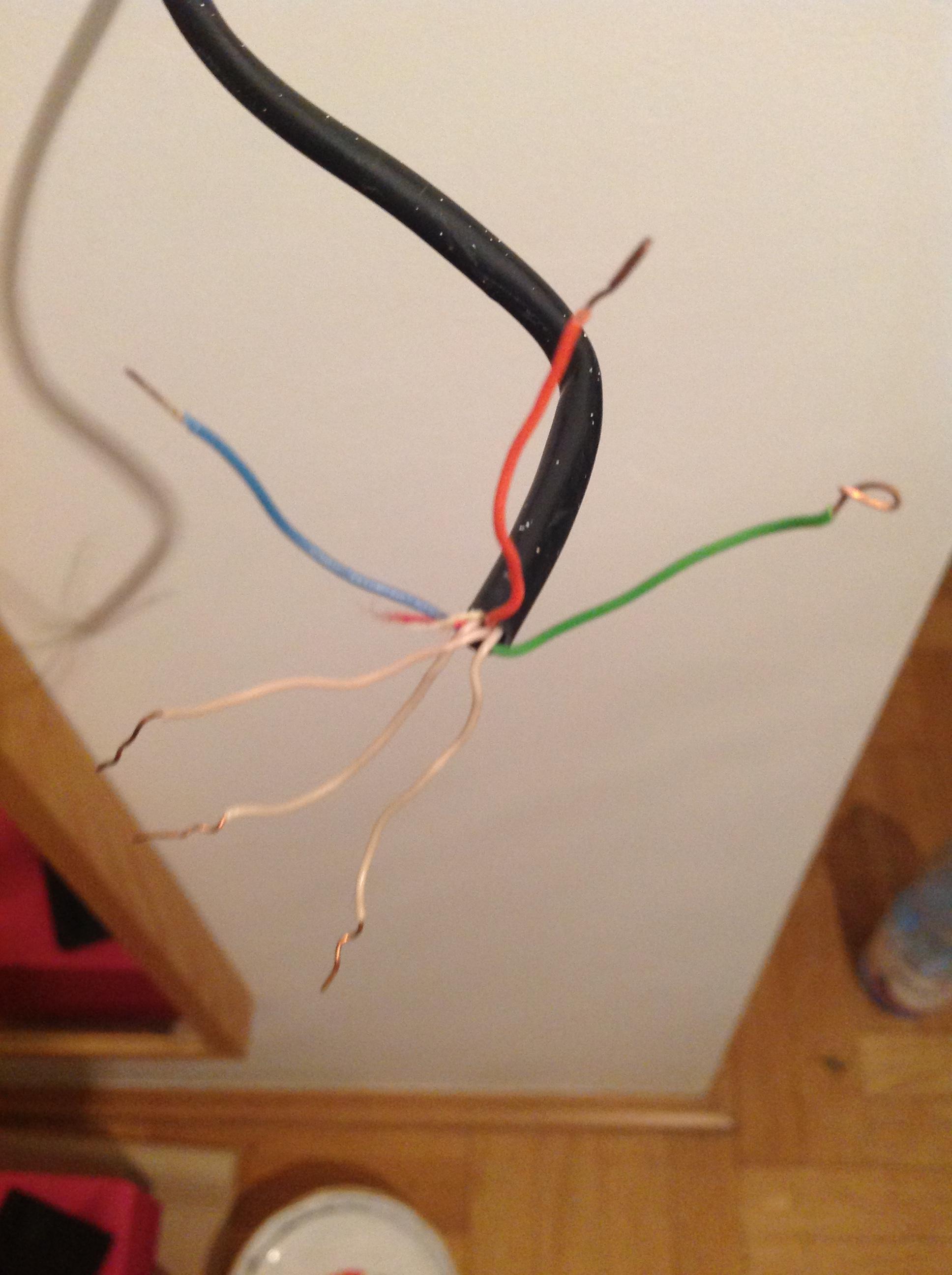

  • Identifying the two connected intercom wires
    #21 18479263
    SzarmiBB
    I'm sorry to dig up the topic, but I don't know where to ask. Namely, in my apartment I have cables from the intercom, but I do not have the earphone in the apartment (the previous owner took it) a cable with 6 wires comes out of the wall and I don't know what the hell to buy and how to connect it later, I throw a photo of the cables. from the left, gray (or very light black), white, blue, yellow, green, brown, from what I can see, probably only white and brown were connected. Can someone advise something about it? greetings ;) Cyfral 2-wire intercom – how to connect to a 6-wire wall cable?
  • #22 18479594

    Provide a picture of the cassette you are calling from.
    greetings

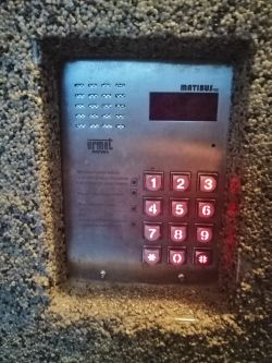

  • #24 18483868
    SzarmiBB
    Sorry for sticking this photo only today, but I just forgot to take a photo of the panel each time :D and as for taking a photo with a neighbor, it probably won't be that simple because they are practically the same elderly people who are not trusting about such actions ;) Cyfral 2-wire intercom – how to connect to a 6-wire wall cable?
  • #25 18483878
    Ircys
    Intercoms specialist
    Posts: 6971
    Help: 1342
    Rate: 2085
    A suitable uniphone is, for example, Urmet 1132/620.
    As for the connection, it only needs 2 wires, maybe the ones you are talking about, but it is best to check it with a meter, because the polarity of the wires is important (+, -). We set the apartment number with bags.
    greetings

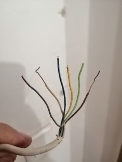

    90507
    Hello everyone, I have a similar problem, there are only cables in the apartment, I paste photos, what kind of intercom to buy and how to connect it? Thanks in advance.
    • Cyfral 2-wire intercom – how to connect to a 6-wire wall cable? IMG_4522.JPG (466.23 KB) You must be logged in to download this attachment.
    • Cyfral 2-wire intercom – how to connect to a 6-wire wall cable? IMG_4521.JPG (385.92 KB) You must be logged in to download this attachment.

    Ircys
    Posts: 6971
    Help: 1342
    Rate: 2085
    90507 wrote:
    how to buy an intercom and how to connect it?
    You need the Elfon OP-U7 uniphone.
    Look with the meter on 2 wires for approx. 7 V. + connect to LU, and negative to GND.
    You set your apartment number with bags.
    greetings
  • #30 19543225
    90507
