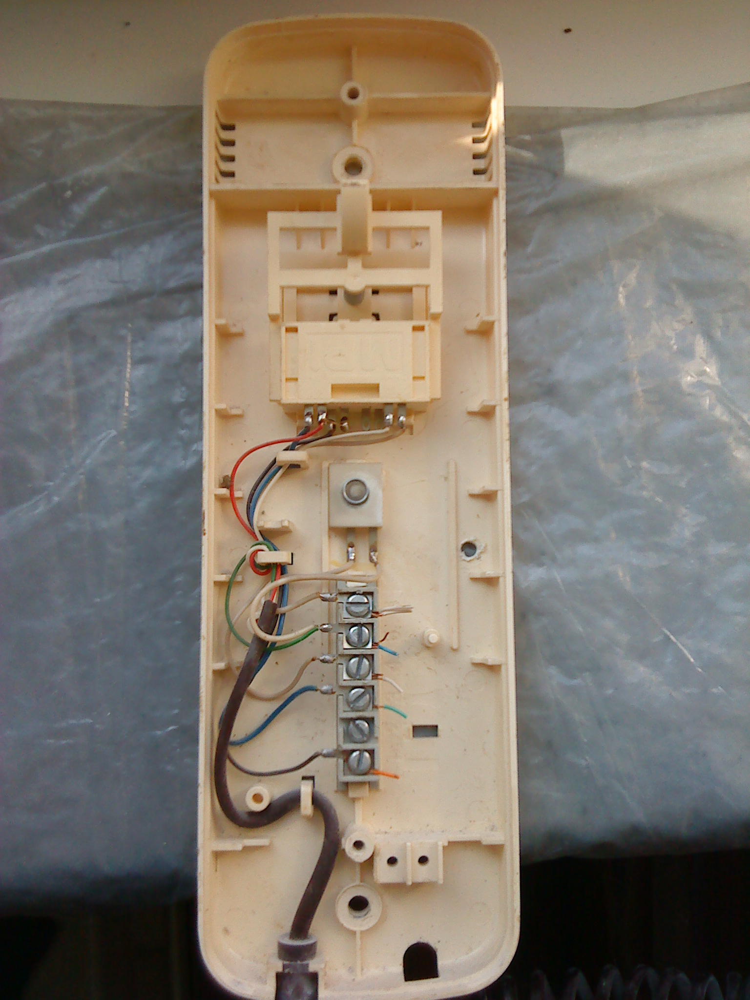

    Hello!
    I bought a flat in a block of flats and I don't have a handset there, only a 6x0.5 wire sticks out. You should probably buy a 6-wire handset, but how to find a microphone, loudspeaker, generator and electric lock? Are there any ways to do that? If you can help me, please. Thank you in advance for any hint

    Counting from the bottom of the clamps
    6 lock
    5 bridge lock with 2 (ground)
    4 microphone
    3 handset
    2 mass
    1 call
    there are four ways to connect
    1. call a professional service ...
    2. go to your neighbor, if he has the same camera, write down the colors and order of the terminals
    3. having a loudspeaker (in the device) terminals 2 and 3, you are looking to listen to the microphone from the cassette,
    having it, you are looking for opening the lock by touching one of the cables to the cable from terminals 2 and 3 once you hear the characteristic BZYT (growling) connect terminal 6 (you have 3 out of 5 cables, the other 3 are the microphone call and free wire) connect to 4 remaining cables need help person to check downlink communication, if no connection, switch terminals 2 and 3 cables and try again. You connect the remaining 2 wires to terminal 1 one by one, move the handset away from your ear and send an assistant to press the button in the cassette. If you encounter problems along the way, see point 1, call the service, this may indicate damaged cables...
    4. Having a meter, you can measure the resistance of microphones, speakers, I can't tell, I don't remember, I'm counting on friends from the forum or ... (e.g. you need to check with your neighbor, but when you get in, you will see the colors of the cables, which will make your work easier, If you are unable to take any actions see point 1 Call service .....
    If you are going to put on this camera, you already have a description of the terminals,
    if you buy another one, take a photo of the new camera and the neighbor's camera, post it on the forum for him, we will do everything for you and you only need to tighten the screws under the clamps
    PS JUMPER on pin 2 ground pin 5 the opening of the bolt is stopped by the ground fed to the relay, the relay gives 8-12 V variable to the bolt

    This is called a comprehensive answer. I think that with these tips I can handle it, as soon as the handset comes to me, I will fight with the connection and of course I will write about the results. Thank you and best regards

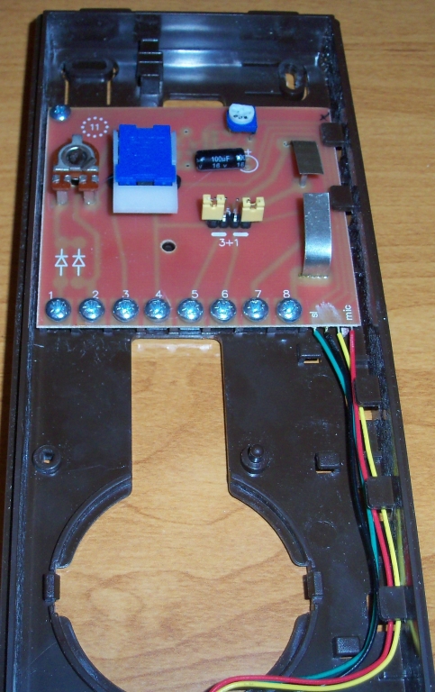

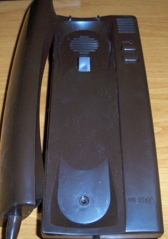

    Hello after a long break.
    So I bought a regular WEKTA handset, I connected it identically to the one I had before (photo posts earlier) and there is a problem because everything works except that you can't hear me downstairs. I am attaching a photo of the headset, please help. Regards

    On the uniphone plate you can see a small blue "podkóweczka" with a white circle. It's a mounting potentiometer. It is set to the left position. Turning it to the right increases the microphone gain.

    Unfortunately, turning the potentiometer on the board did nothing. My connection looks like this:
    From the right, 1-orange, 2-bridge with 5, 3-green, 4-white, 5-blue, 6-two white. I have the same connection as the old intercom.
    Maybe the handset is damaged? Regards

    There should be a voltage at terminal 4 - 8-16 V when the handset is hung up, 3-6 V when picked up - 3-6 V depends on the parameters of the power supply. This is the voltage supplying the uniphone electret microphone. It is best to measure the voltages on terminals 4 and 3 relative to 2 (ground). If the wires protruded from the wall for a long time and were short-circuited, the power supply may have been damaged.

    The jumpers are used to open the lock, and more precisely to configure the uniphone. They are to be installed in a 4-wire system. Removed with 6 wire. You have it removed in the picture.

What is the exact pinout for WEKTA TK-2?
Counting from the bottom screw: 6-lock, 5-bridge (to 2), 4-microphone, 3-earpiece, 2-ground, 1-call [Elektroda, tomeye, post #9737557]
Why is terminal 5 sometimes bridged to 2?
Some installers move the ground from 5 to 2, then add a short wire bridge. Either method grounds the lock relay; performance is identical [Elektroda, zybex, post #9742513]
Should jumpers be installed in a 6-wire setup?
No. WEKTA’s lock-control jumpers are only for 4-wire modes. Leave both removed; fitting them blocks microphone audio [Elektroda, zybex, post #10491295]
