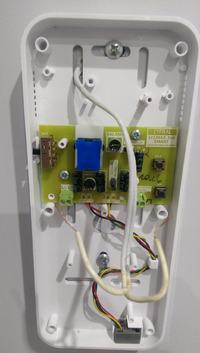

    Model Analog uniphone by Cyfral smart model 824199 as in the picture
    Replacement of entry phone in a block - Connection problem
    according to the instructions it should be connected to L1 and L2 but nothing works.
    Is this a problem of compatibility of this camera with the control panel or is it connected badly, please help.

    theoretically. Cyfral once produced several models of uniphones for various exchanges which resulted in their incompatibility. Despite the identical-looking covers of uniphones and exchanges.
    maybe the polarity change will help.

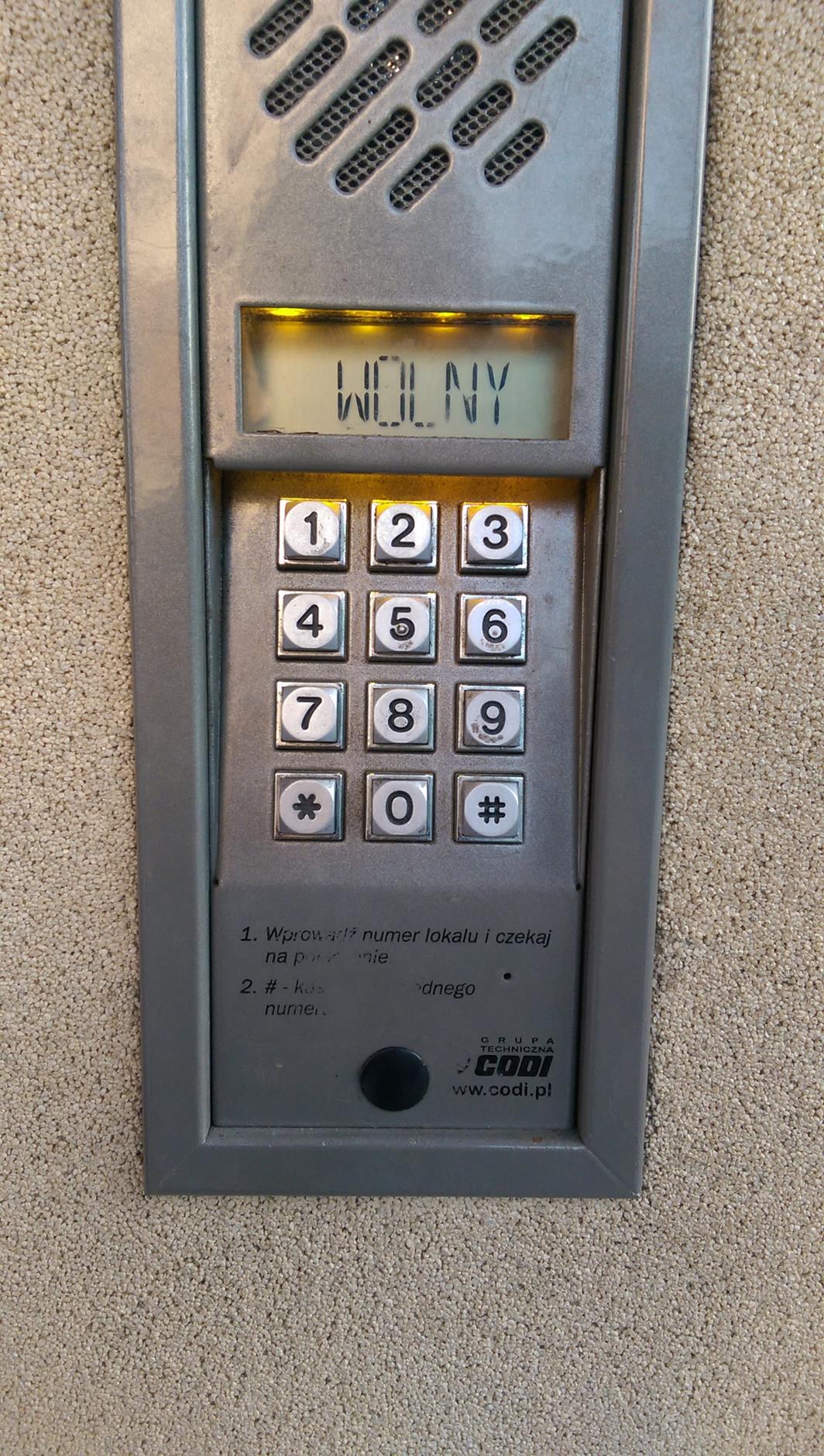

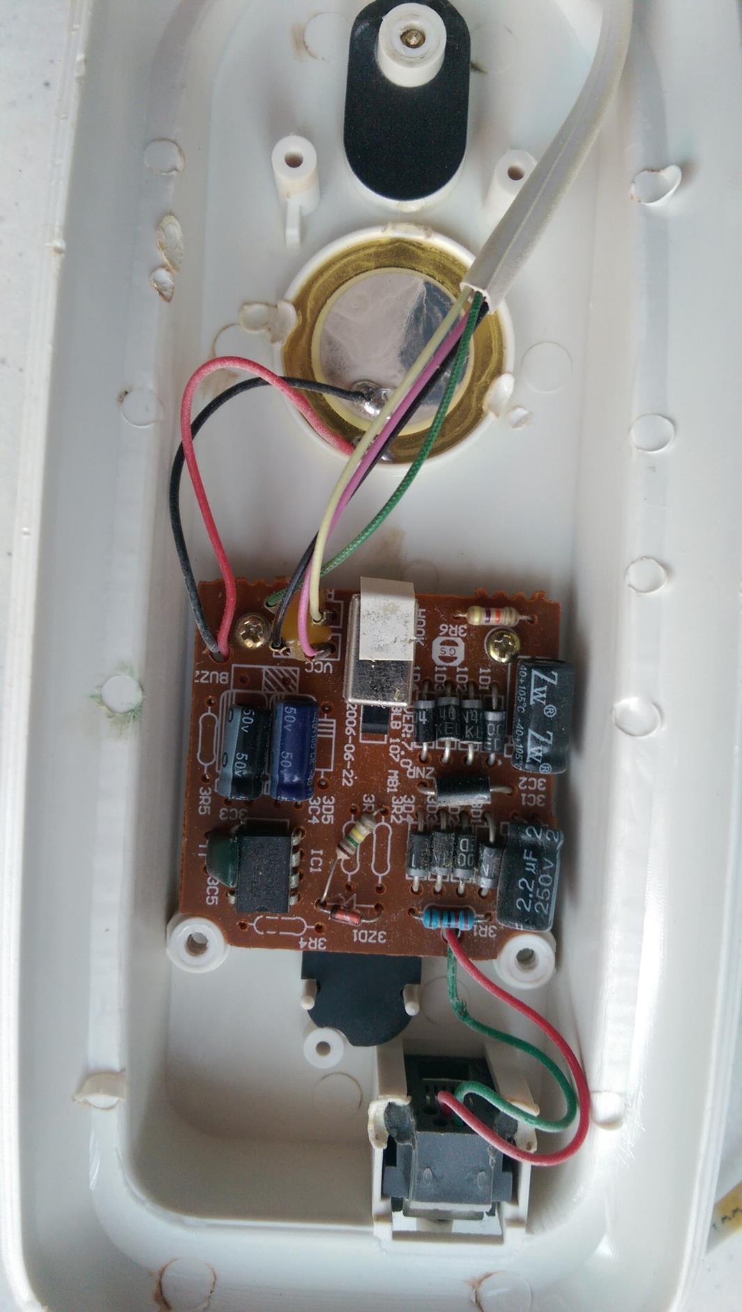

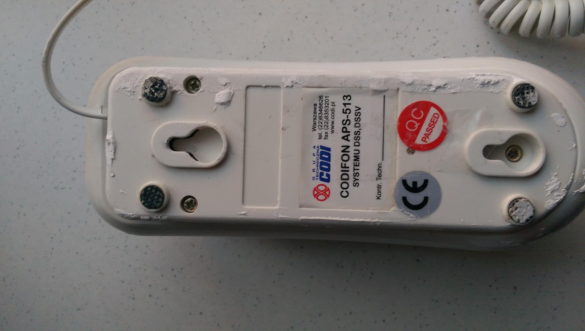

    I am sending missing photos of the external panel and the old camera, the poles changed and nothing, maybe a faulty camera? thanks for the help.

    For Codi this ordinary analog phone will work. The digital uniphone from Castorama will not work.
    But you can give up ;)

    Don't bother, this system just has it. Using the keypad from the telephone / intercom and appropriate codes, you can reach other premises or the concierge.
