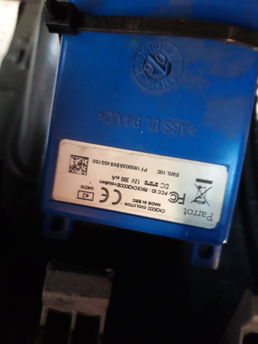

    marko888 give the picture
  • #32 18539926
    marko888
    Posts: 222
    Help: 15
    Rate: 66
    [/url] Updating Parrot CK3100: Service Cable RS232/USB Guide, Reset & CK 3100/3300 Models
    For now only pilot.
    I found where the module is and you can see that it is CK3000 Evo.
    Now I will try to update it through a blut but you need a .ulp file, maybe someone has?
    The next question is whether anyone's control of this knob worked. Whatever I approve, I shot no effect, and this inactive microphone (I think)!

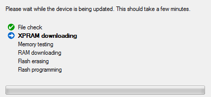

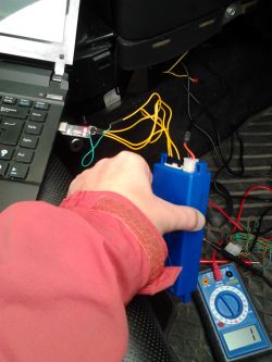

    Updating Parrot CK3100: Service Cable RS232/USB Guide, Reset & CK 3100/3300 Models I'm trying to update my CK3000 EVO. no success so far. I have a TTL adapter but there are several connection schemes e.g. Updating Parrot CK3100: Service Cable RS232/USB Guide, Reset & CK 3100/3300 Models
    or Updating Parrot CK3100: Service Cable RS232/USB Guide, Reset & CK 3100/3300 Models
    and such a hint
    With a multimeter it was quickly worked out that pins 2,4,6 are GND; 3,7,10 + 12V; 8 + 5V. This only left 1.5 & 9 to be either Tx or Rx. The 5v on pin 8 was not enough to power the TTL circuit, I am not sure what it is for. Anyway to cut a long story short here is the pinout below.
    I am standing here after launching the update
    Updating Parrot CK3100: Service Cable RS232/USB Guide, Reset & CK 3100/3300 Models !
    In one of the hints he writes to connect the power supply (12V) after such progress as in the picture!

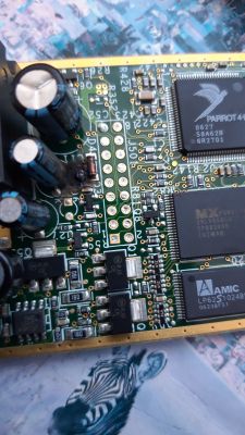

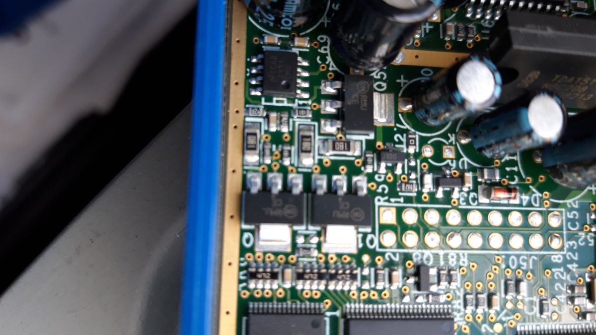

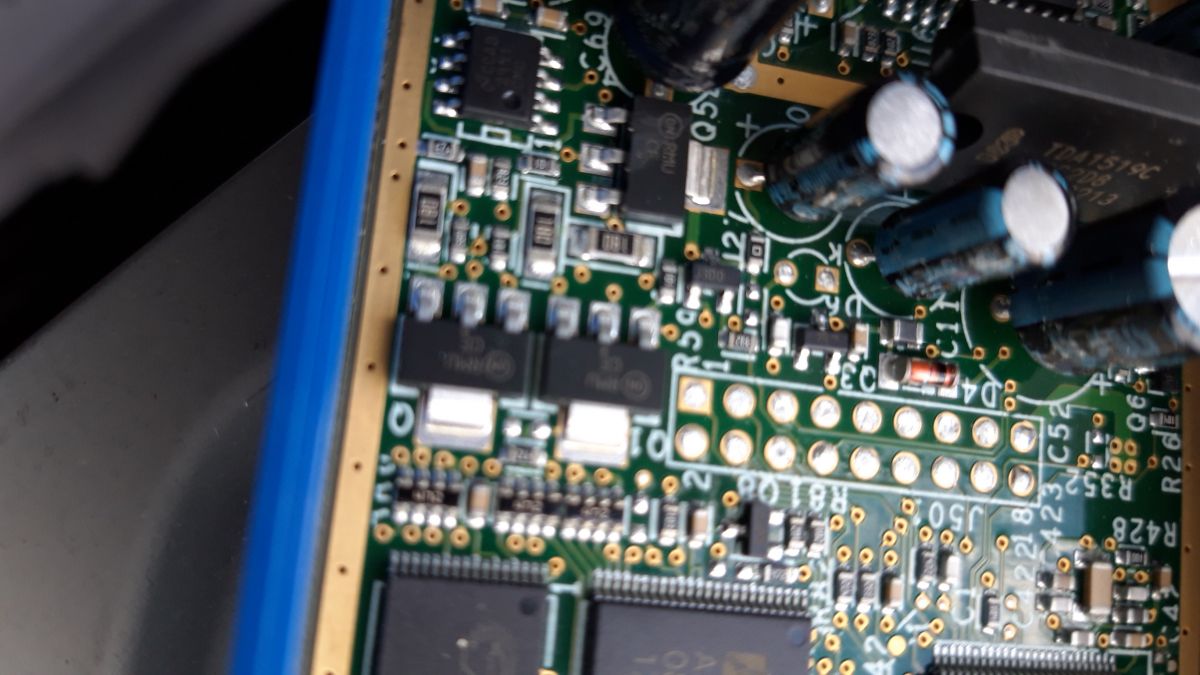

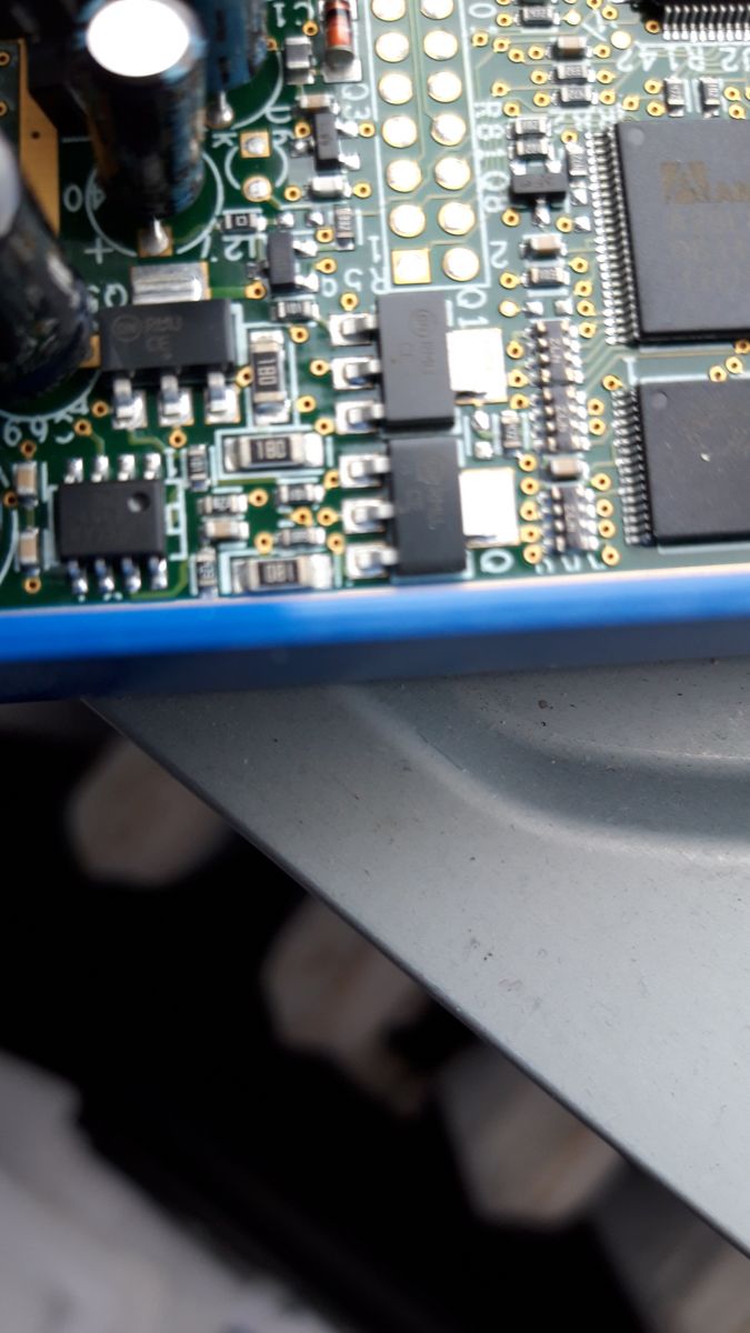

    Someone can share a photo (relatively sharp) of a plate without a housing.
    Something burned on the photo I want to determine what and how with this element?
    Adds photos with functional control panel. Updating Parrot CK3100: Service Cable RS232/USB Guide, Reset & CK 3100/3300 Models Updating Parrot CK3100: Service Cable RS232/USB Guide, Reset & CK 3100/3300 Models Updating Parrot CK3100: Service Cable RS232/USB Guide, Reset & CK 3100/3300 Models
    Now another puzzle, because the remote control can be connected in two ways, the plug is square and two protections on both sides only, which one is correct?

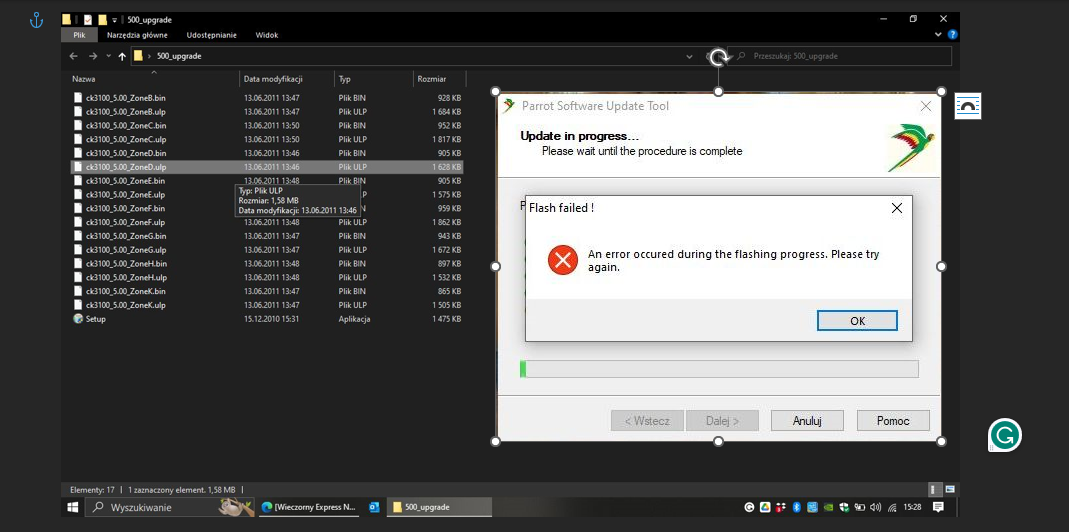

    tomekjanczewski
    Good day,
    I am renewing the topic. I'm trying to update Parrot CK3100 via laptop via Bluetooth and I keep getting an error like the attached picture - can this be remedied somehow?
    Greetings and thanks in advance for your help :)
    Screenshot showing an error during the Parrot CK3100 update.
